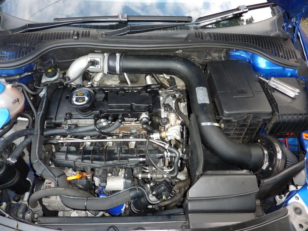

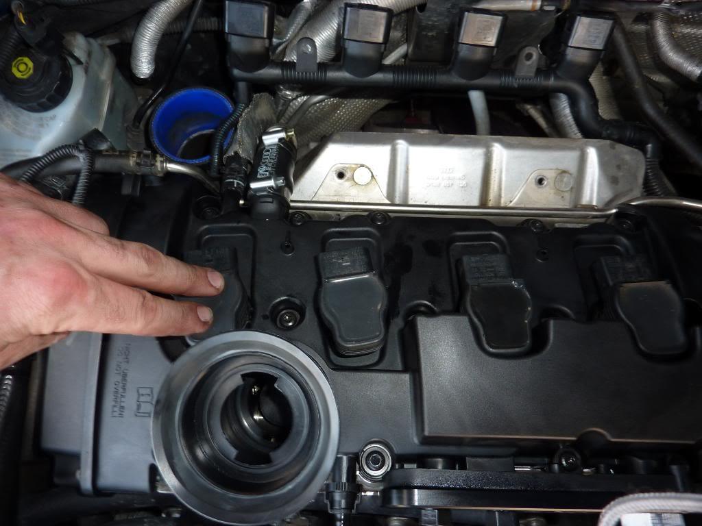

Remove the Engine Cover - Just pull upwards gently but firmly DONT YANK and it will pop off the 4 Lugs that hold it in place. Also if you have an Aftermarket intake and heat shield remove those aswell. Your Engine will look something like this.

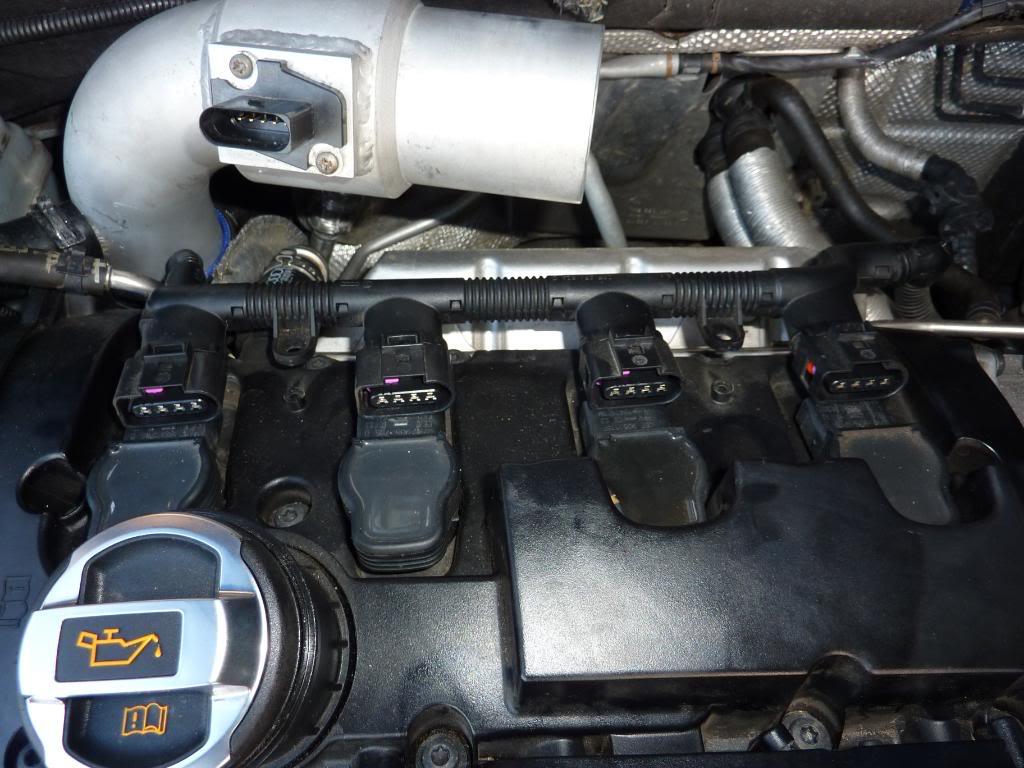

Next remove the 2 Screws that hold the Coil Pack Loom in place. Don't Panic if you don't have them they are not vital :grin:

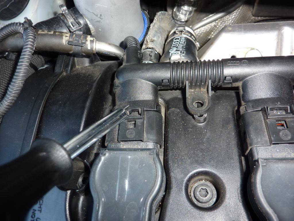

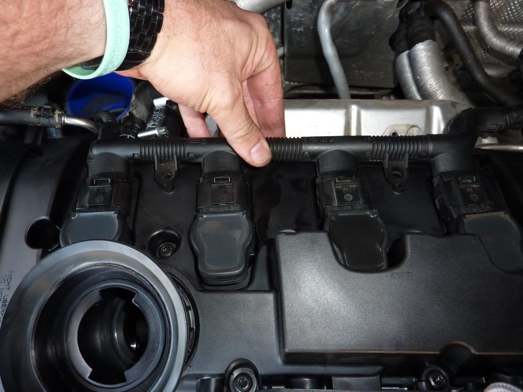

Next Disconnect the Coil Pack loom by pushing the tab down and gently pushing back to the rear of the engine. Do the same for all 4 Connectors.

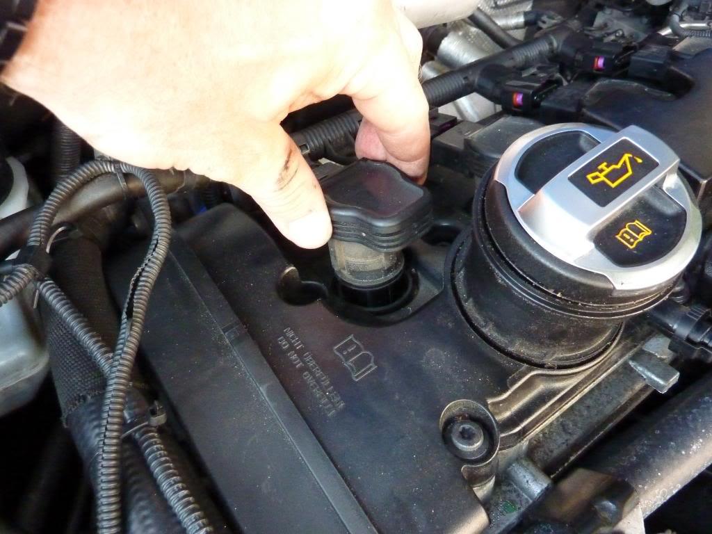

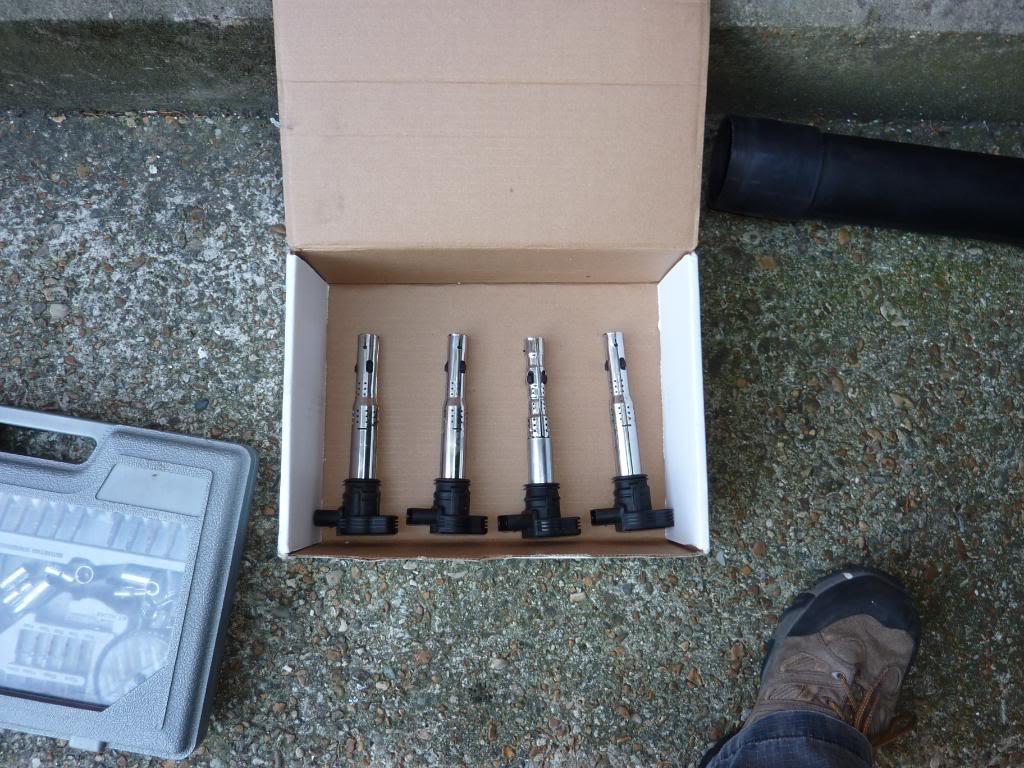

Next remove coil packs. Just lift up again don't yank and i stored them in the order they came out so that they went back to the same cylinder.

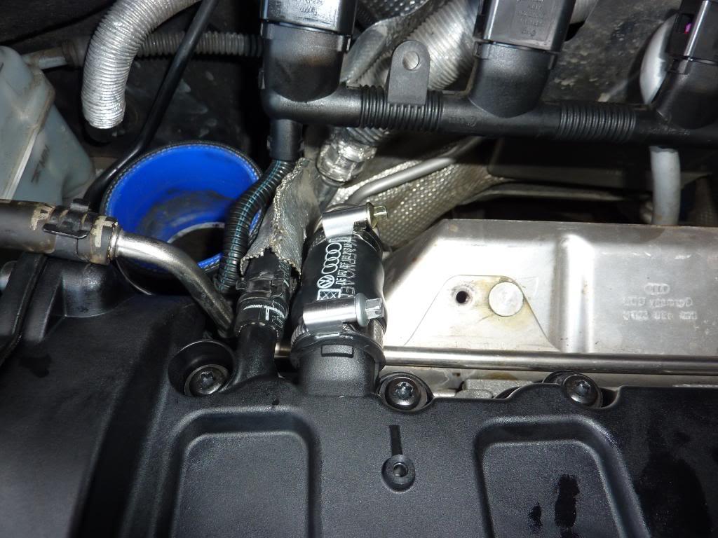

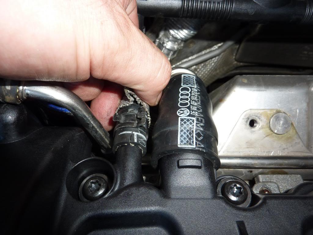

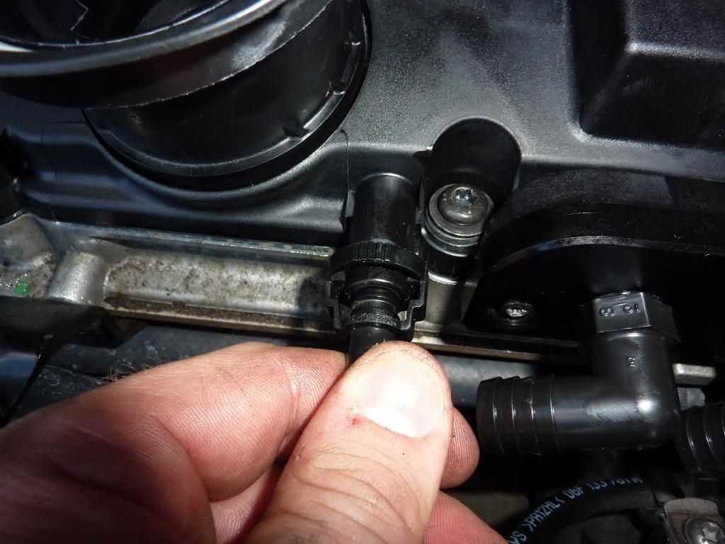

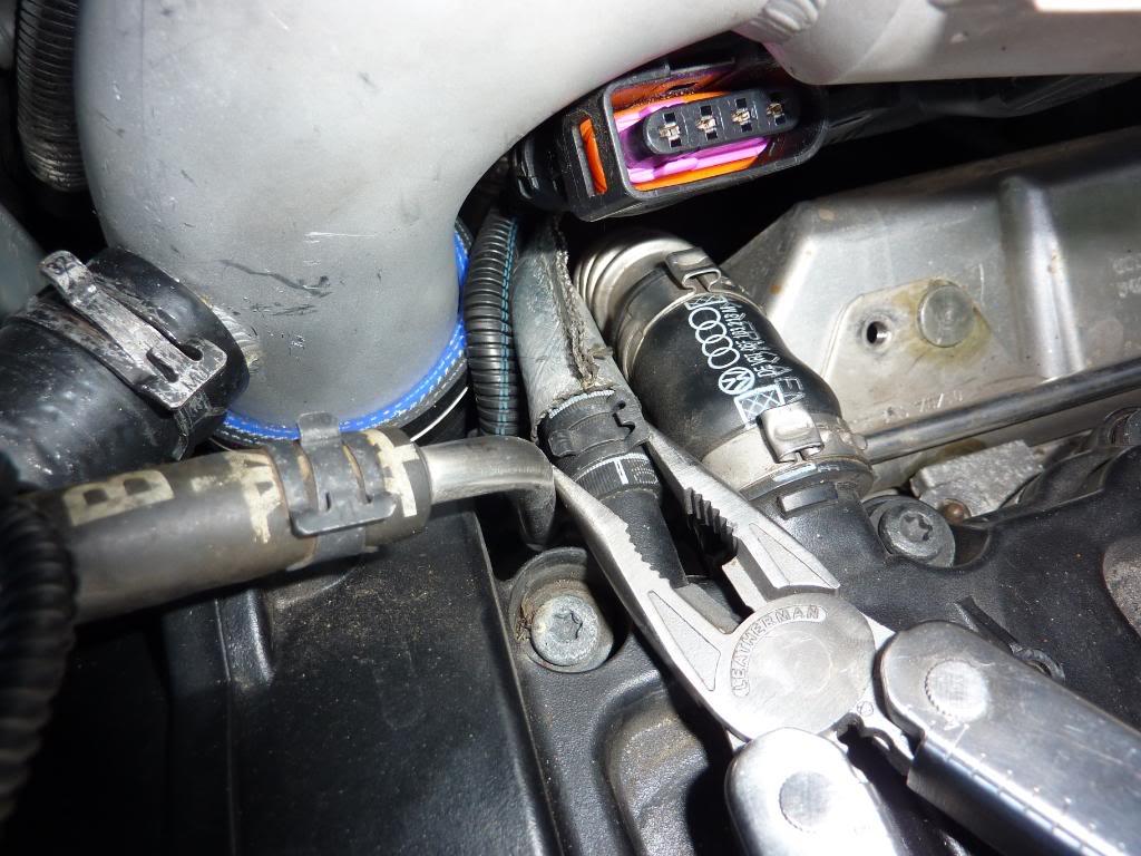

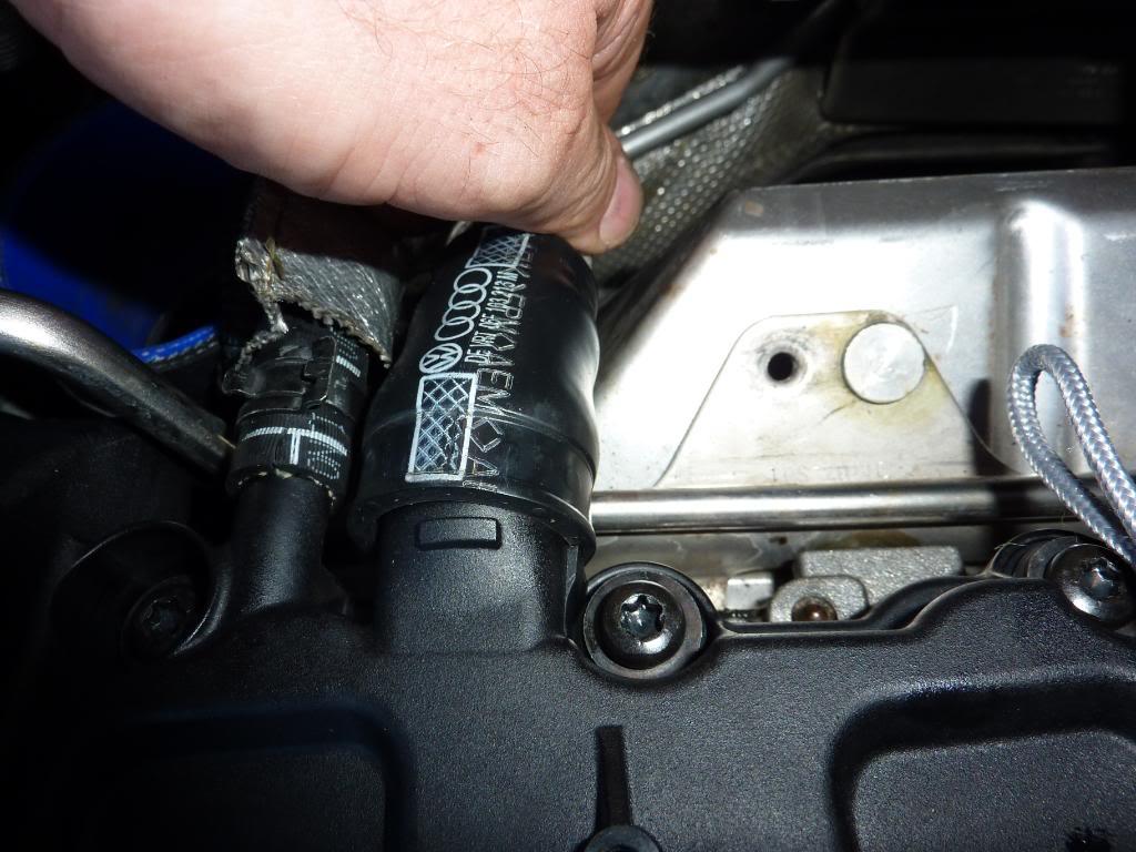

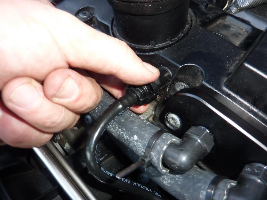

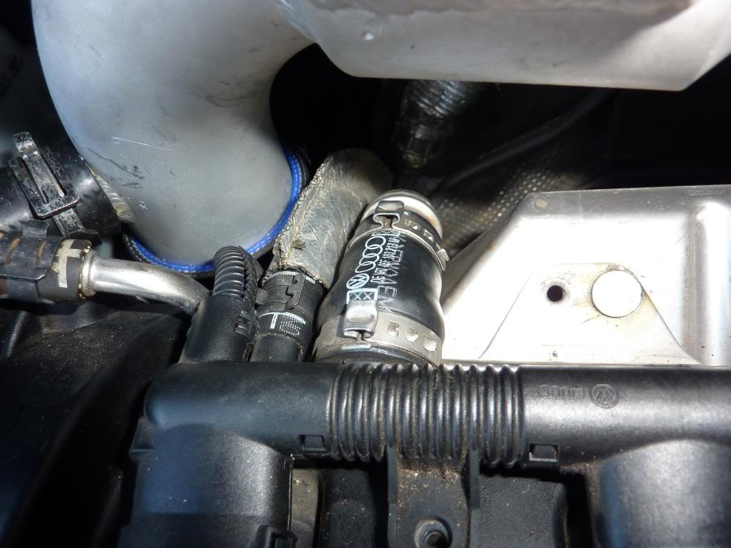

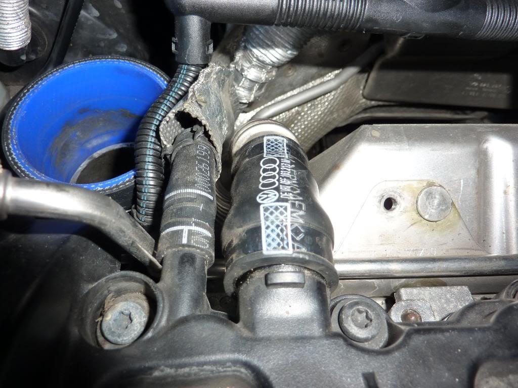

Next remove the clamps from the 2 pipes in the pictures below. The Left hand clamp is spring loaded so just use a pair of pliers to grip it together and push back. The second connectors are for the rear PCV they need a special tool to remove which if you dont have you break the clips so make sure you have some jubilee connectors to replace them. Remove the pipes.

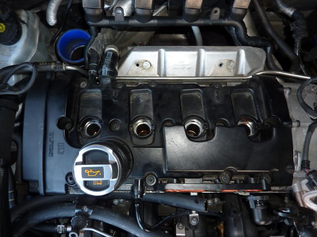

Disconnect the pipe to the left of the PCV/BSH Plate and disconnect the PCV/BSH Pipes and plate

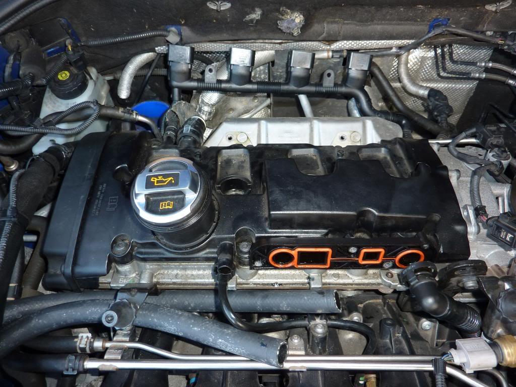

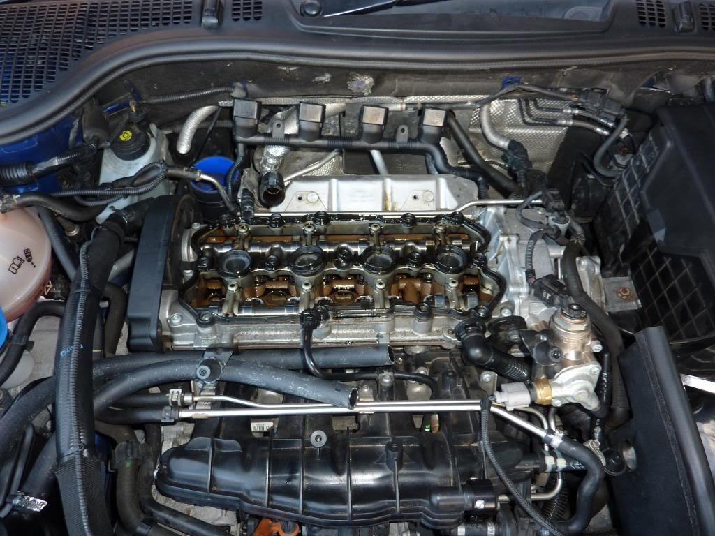

Engine now looks like this.

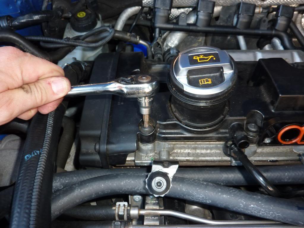

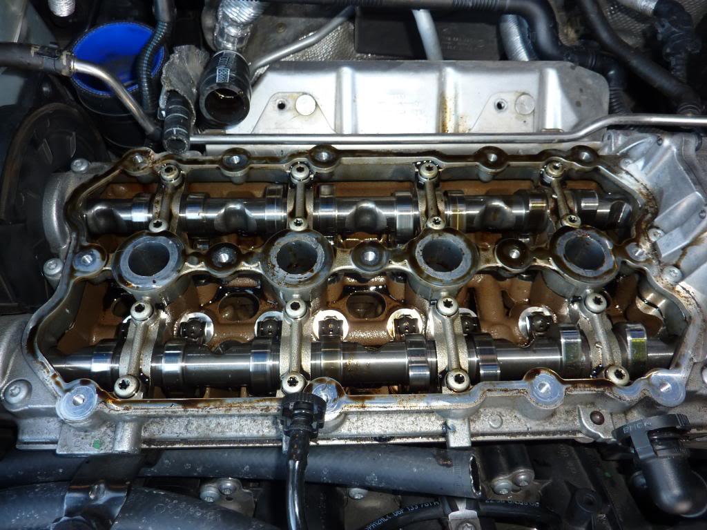

Now there are 17 x T30 screws that hold the Cover in place. 5 across the top,middle, bottom and 2 on the left hand side. The 2 on the left hand side which are in the timing belt cover you need to keep. The other 15 you get new when you buy the Cover. These screws are only hand tight so they don't take much force to undo. I loosened with a ratchet then one by one took them out using a T30 Screwdriver. Remove the cover and your engine looks like this.
Pic showing Screw Location

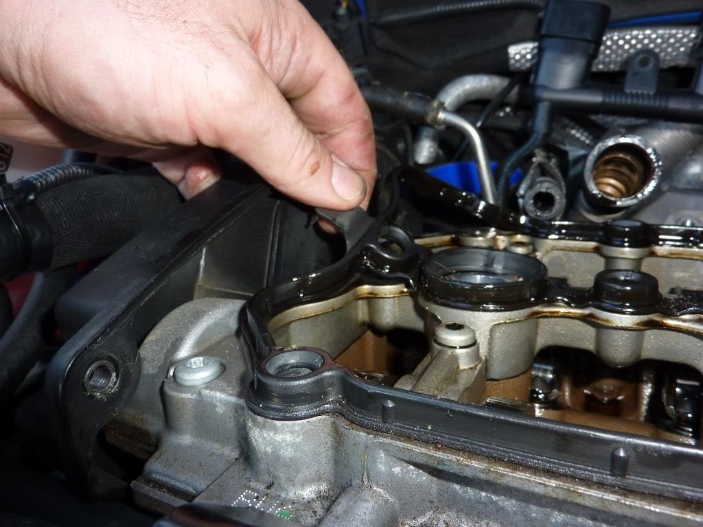

Cylinder Cover removed
Next remove the Gasket. Again you get this new when you buy the cover and you get a new PCV gasket aswell.
Now i cleaned the top rim where the screws go and applied fresh clean oil.
Before
After

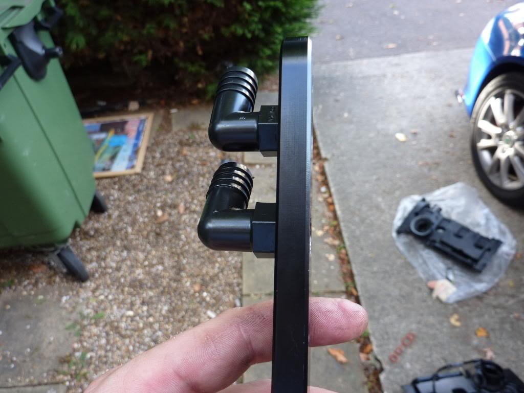

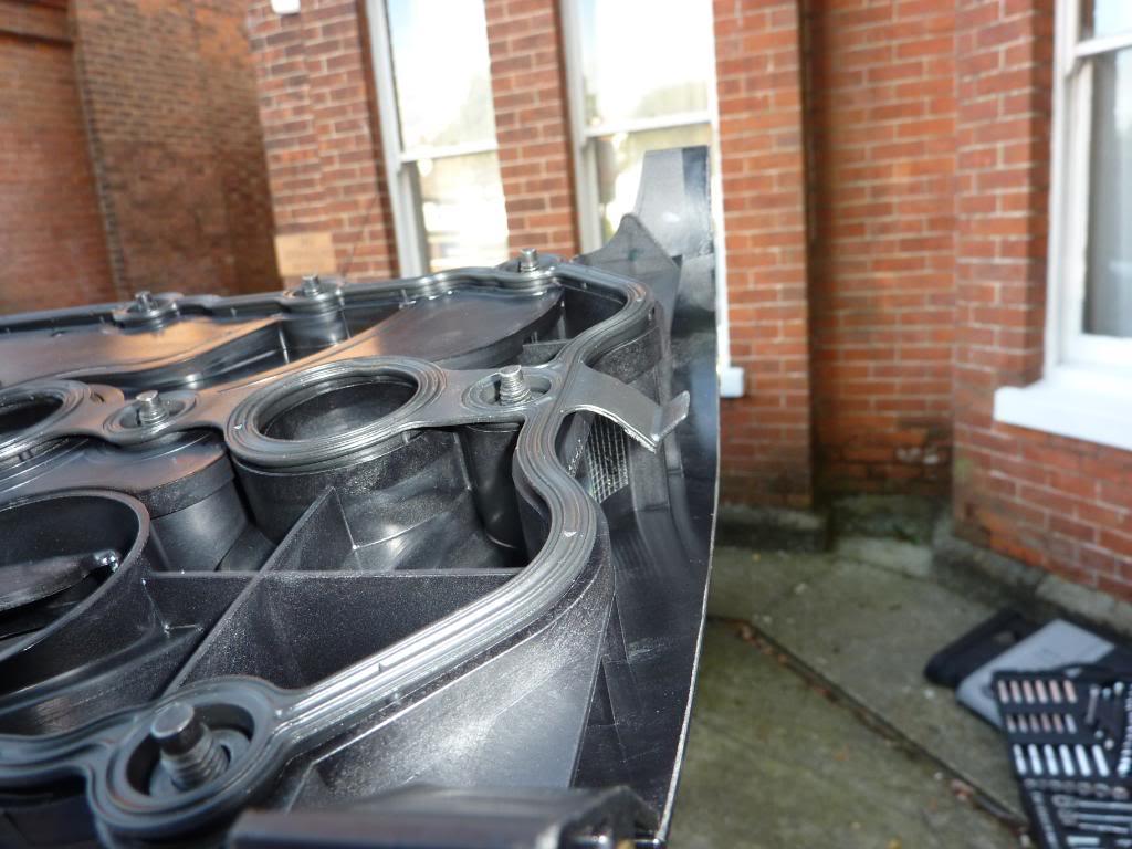

Here are a few pics of the Cover and showing Gaskets and Screws already in place. The covers may look diff sizes in the pics but trust me they are not

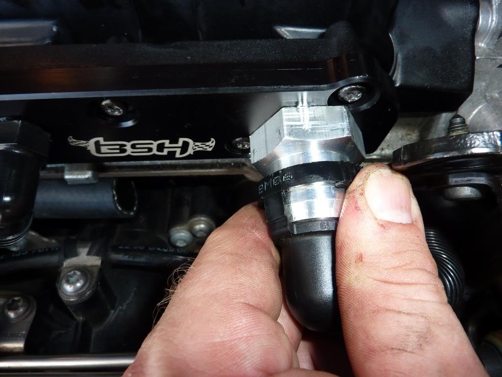

Now its just the reverse. Place the cover on ensure all the holes line up and tighten up the 17x T30 Screws. REMEMBER HAND TIGHT ONLY. Once that is done reconnect the pipes. I also applied the BSH Plate to the new cover before placing it on and this time i Shaved off the Excess thread on the taps.
Your engine now looks something like this.

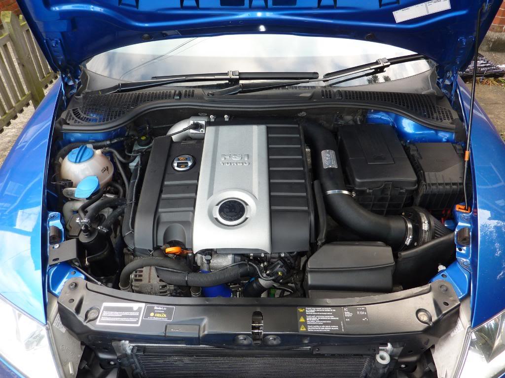

Now replace all the Catch Can Pipes, Aftermarket intake if applicable and your engine looks like this
Now before replacing the engine cover start up and check the car idles normally. If the idle is erratic there is a break in the seal somewhere so stop and recheck seating of gasket and all bolts are hand tight. Replace Engine cover and all done
