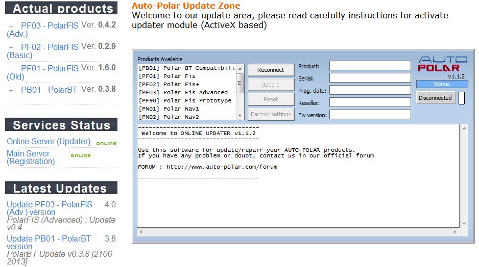

I have the box out, so when I go to the update page, it waits till I connect the lead to the polar, then goes to update/connect and shows up with problem!  :sad1:
What error message do you see, Device damaged??
PF03 means you have a Polar FIS+ Advanced.
The Telematics box is automatically checked with your model version of polar. By any chance do you have BT/telephone in your car as well?

No It seems to be internet explorer doing something, doesn't stay on screen long enough to see what it says..
No I have the Bluetooth unit there, but its not connected...
tried on two different computers so far, one with xp and the other wins 8...

You must do this in IE to allow the active X to be installed.
Go to internet options>security>custom level>scroll down to Download unsigned ActiveX controls and set it to prompt instead of the default Disable.
Go back to the web update page and allow the ActiveX to run. You should then be greeted with this screen.

How do I get the activeX to run, is that just the reconnect/products available screen you up have uploaded as the picture...
again thanks for all the support ! :happy2:
If you've changed the Download unsigned ActiveX controls to prompt, save the changes. If you have a browser window open, close it/them then re-open IE and go to the polar update site. Once you get there you should get a pop up asking if you want to run the activeX, agree. You may have to click another run box thereafter you should then see the page looking like what I've just posted above.
Remember, get to the update screen as above before connecting your polar.

Well with a BIG THANK YOU to Bacillus, got the polar updated !  :star:
