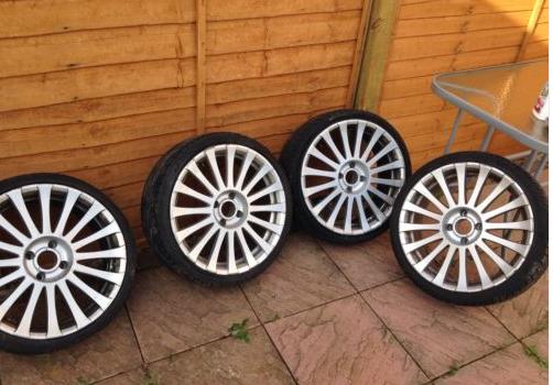

vw golf 1,6 fsi?? Thanks for help guys and gals

No, they only got 4 bolt holes and your golf has 5

As above mate, you'll need a set of wheels that have a stud pattern of 5x112 or you can get adaptors made up / get wheels redrilled.
However, both can be quite expensive.
