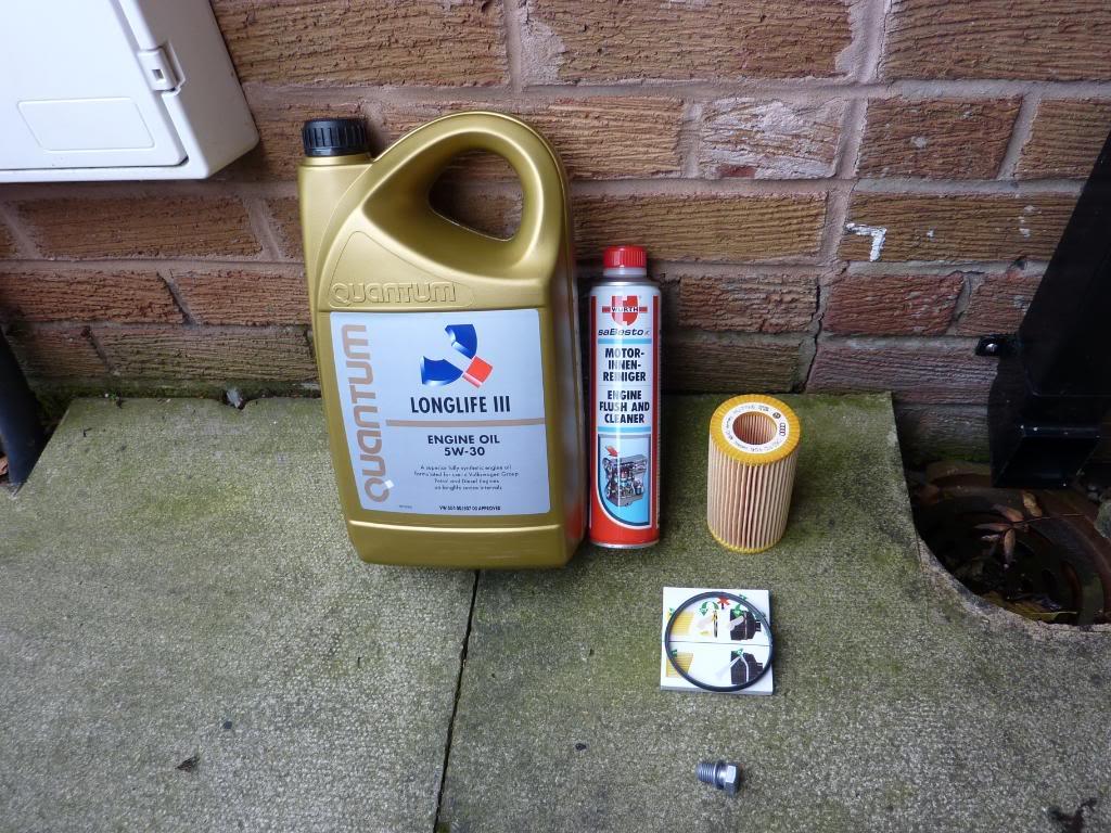

You will need the following:
Jack
Axle Stands x2

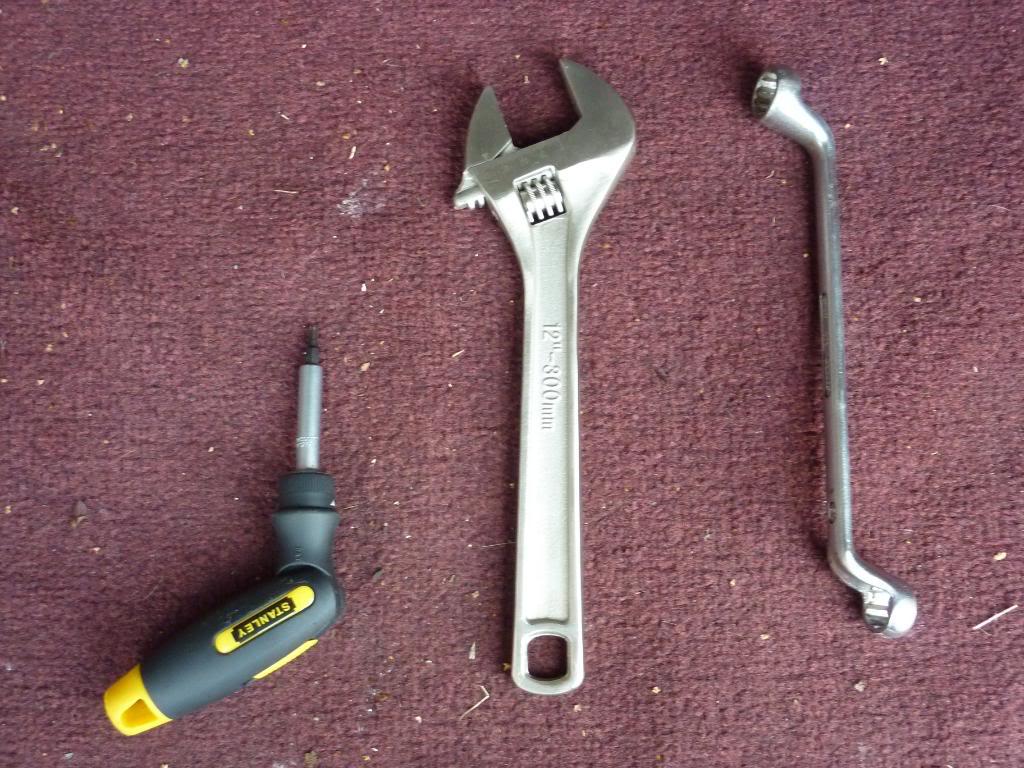

19mm Socket/Ratchet/Spanner
36mm Socket/Ratchet/Spanner
T25 Torx Bit and Driver
T30 Torx Bit and Driver
6 Litres of Oil (Longlife or standard depending on your servicing regime)
1 Can of Wurth Engine flush (will treat up to 6 Litres of oil)
1 x Oil Filter and Rubber Gasket (come together) Part no. - 06D 115 562
1 x Oil Sump Plug and Captive Seal - Come as one part from Dealer.

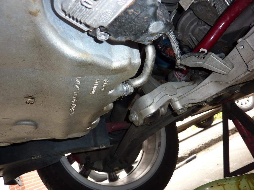

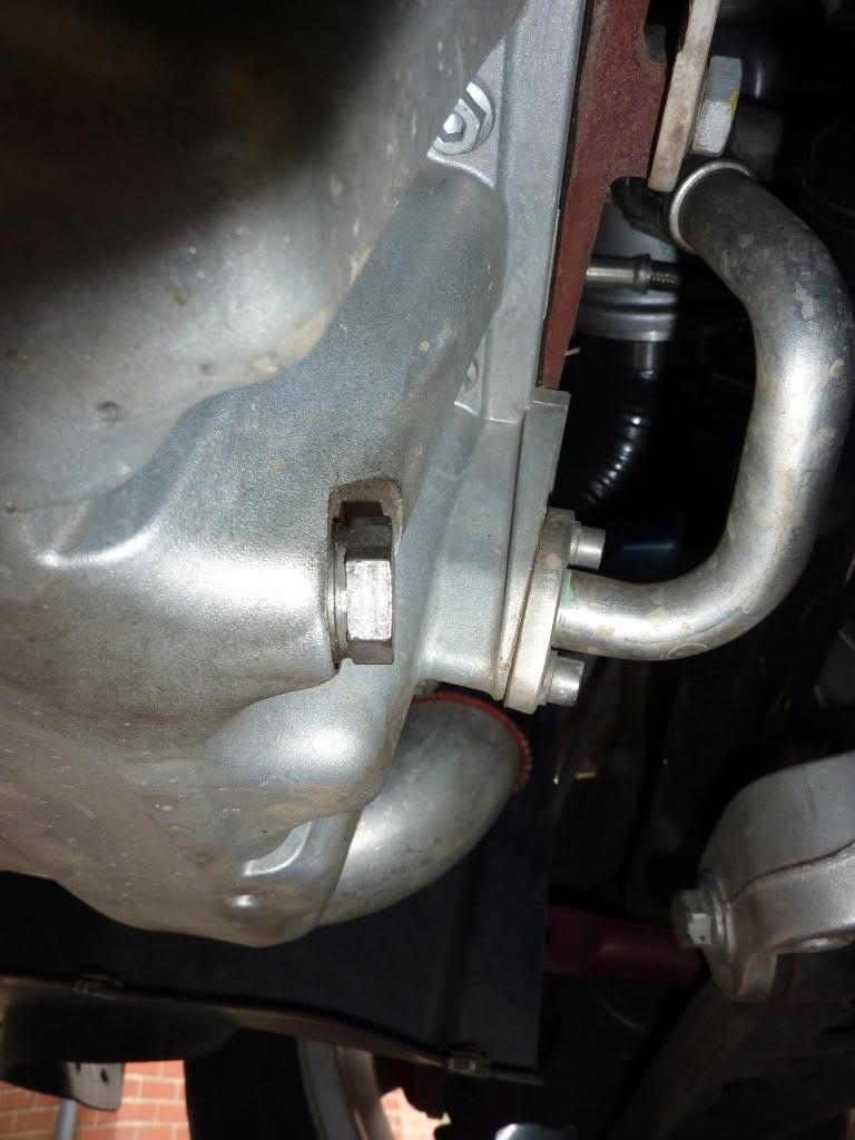

Firstly jack the car up and remove the Under tray. This area there are 3 x T30 Torx Screws
This area there are 4 x T25 Torx Screws (same for other side)

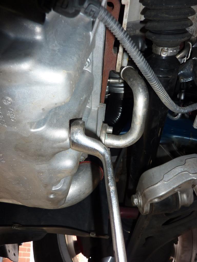

Now check that you have the correct size socket/spanner to remove the Oil Filter and Sump Plug. You don't wanna be driving round with engine flush in there all the time

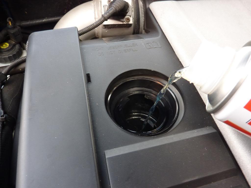

Once that is done Switch off engine and add the Wurth Engine flush.
Now Start engine and leave running for 10 Mins

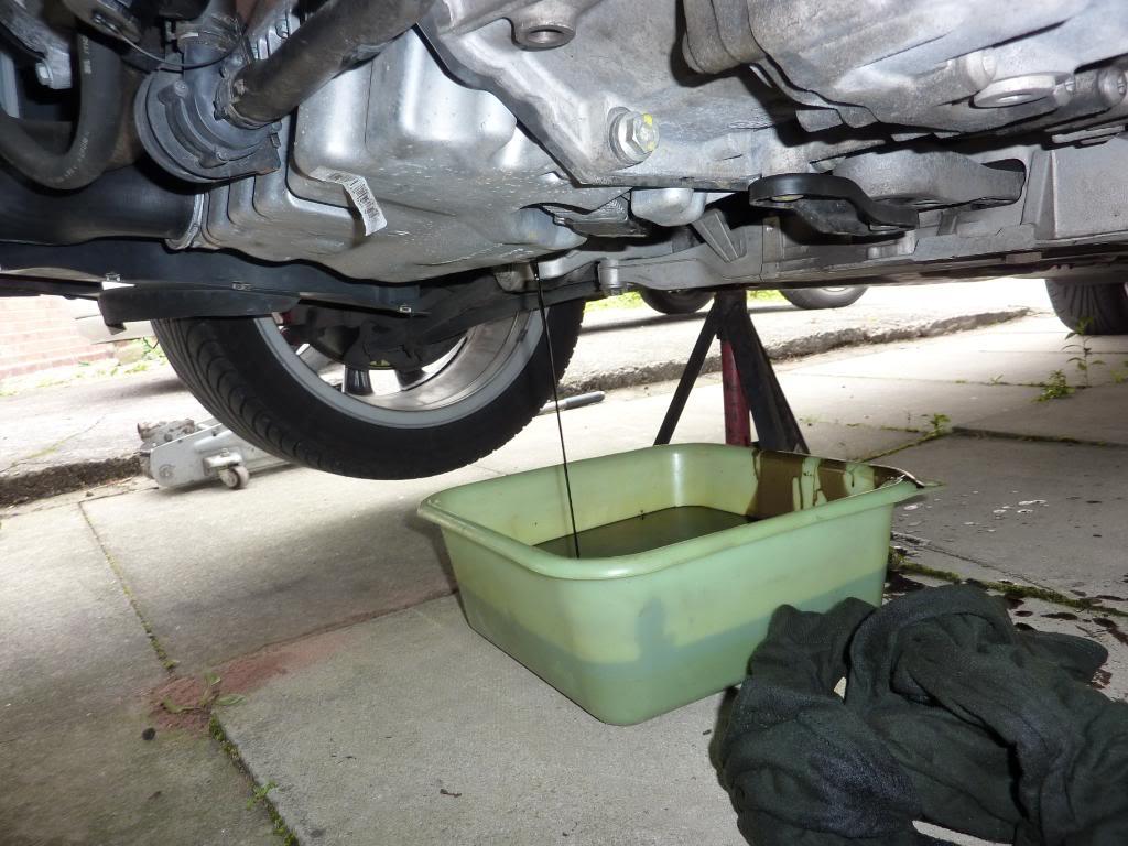

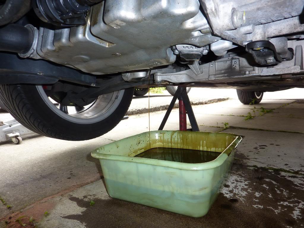

Once 10 mins has passed stop engine and get container ready. Undo oil sump plug (beware it may be quite hot!!!) and then catch oil that comes out. I removed the dipstick and oil cap before doing this just so there was no suction at all to hold anything in.

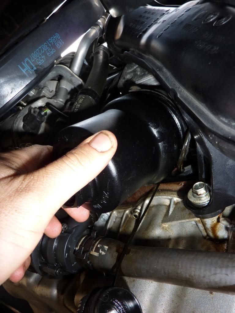

Once all oil out Undo oil Filter and again have container ready to catch the oil.

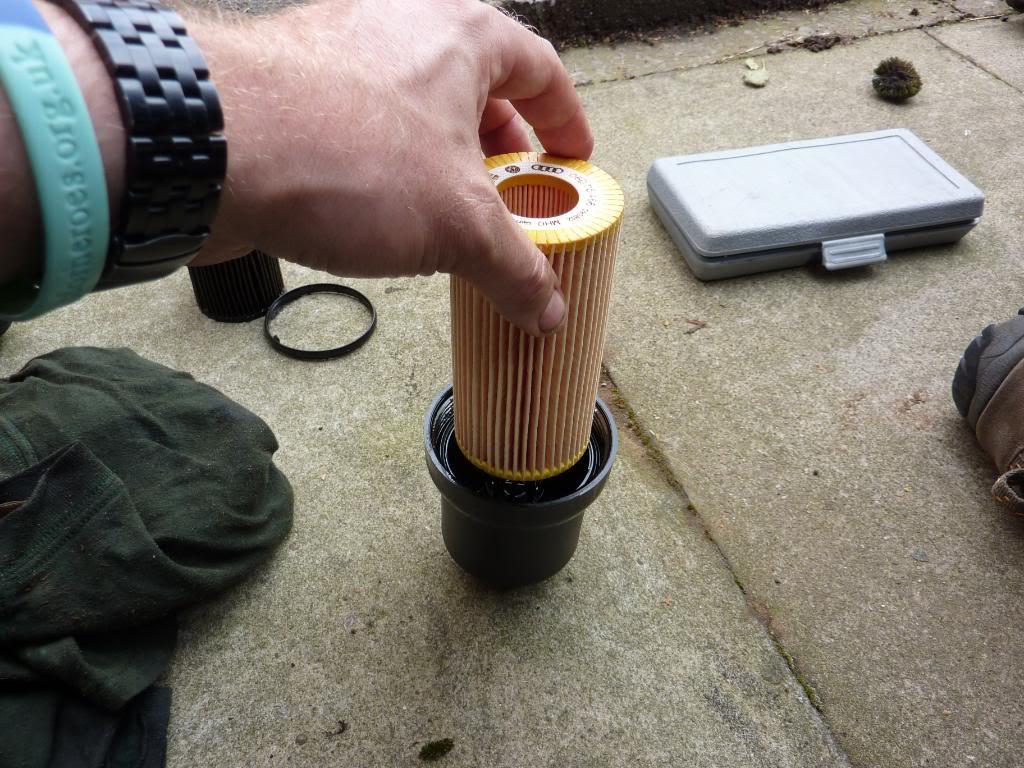

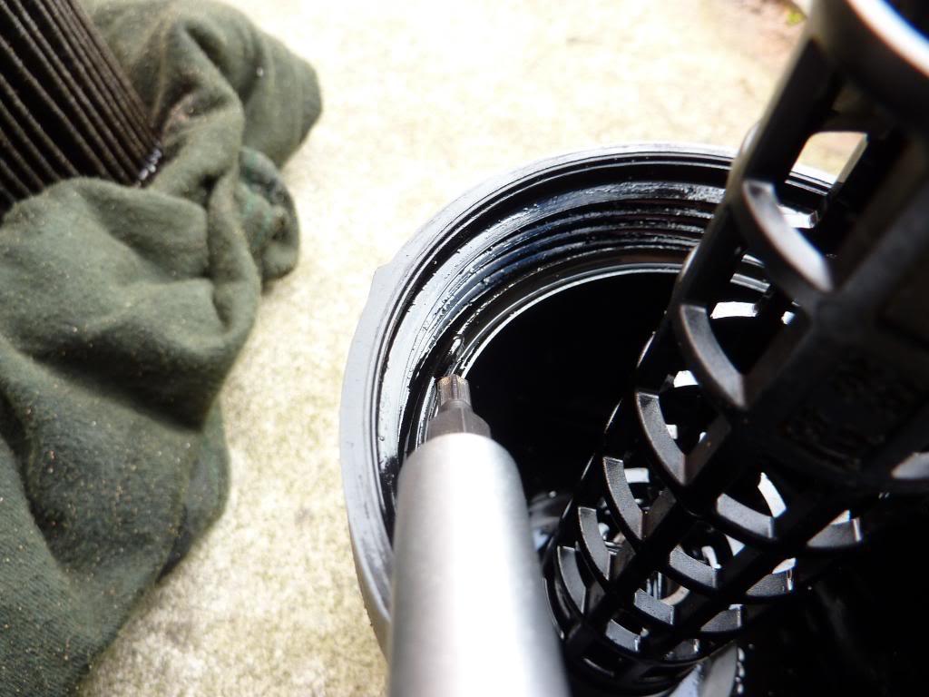

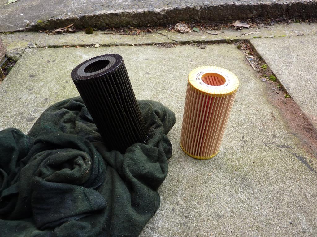

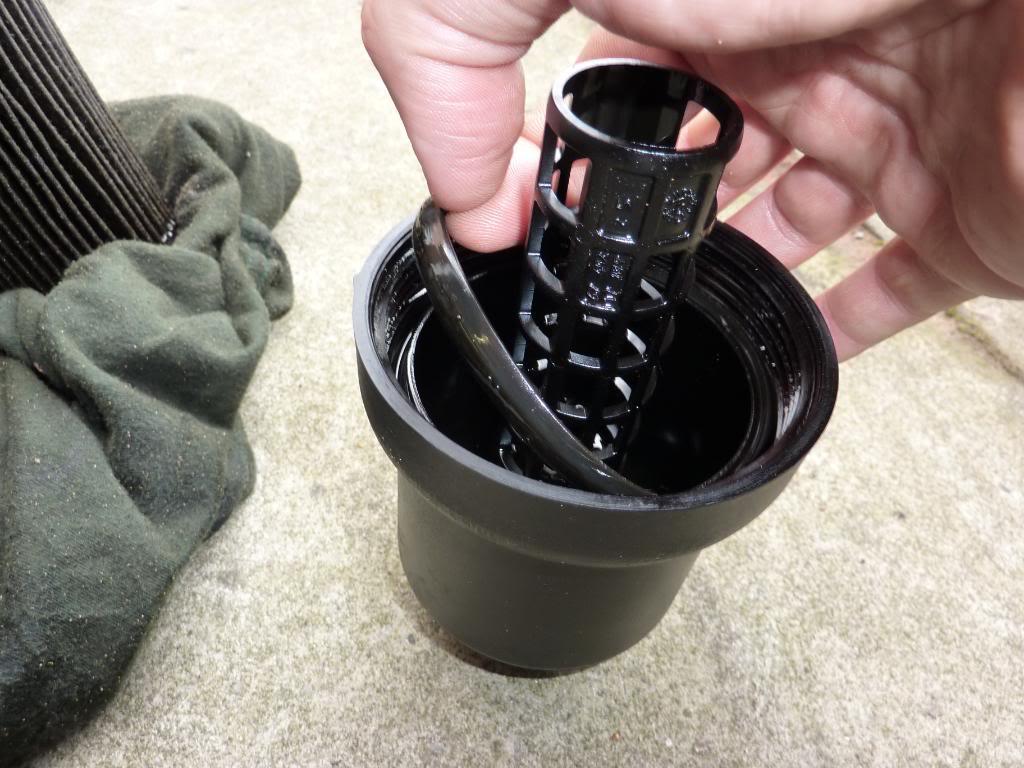

Whilst container is catching all the the oil remove old filter and gasket. The Gasket has a small tab indicated by the Screwdriver. Ensure that is uppermost (i.e. you can see it) when putting the new gasket in

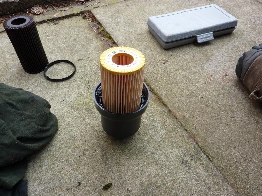

Next get new gasket coat with fresh clean oil and place into filter holder
Put new filter into holder and reattach to engine. Tighten up just hand tight then 1/4 of a turn.

Re-apply oil Sump Plug and tighten up to 30NM or Hand tight then 1/2 turn

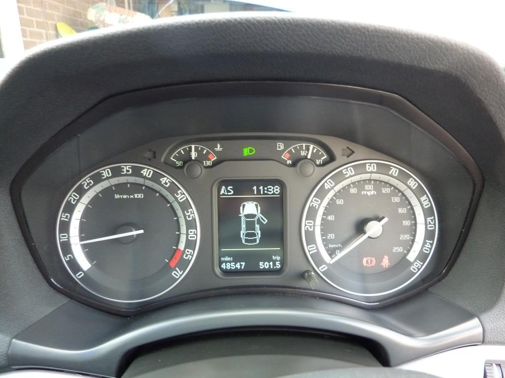

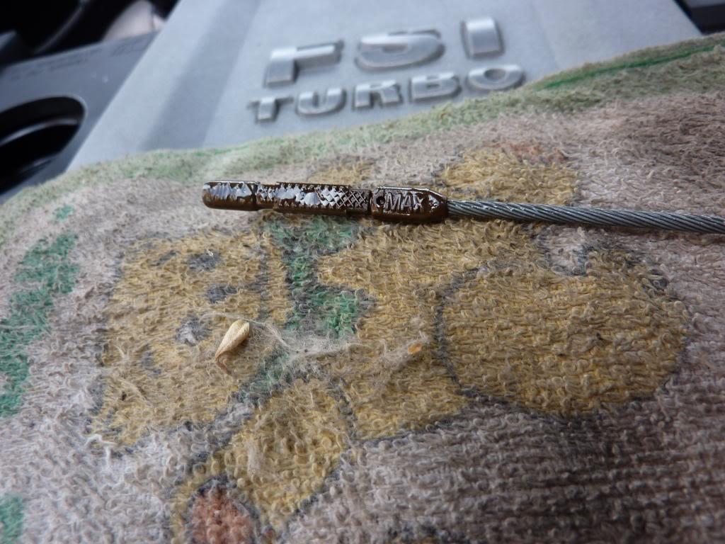

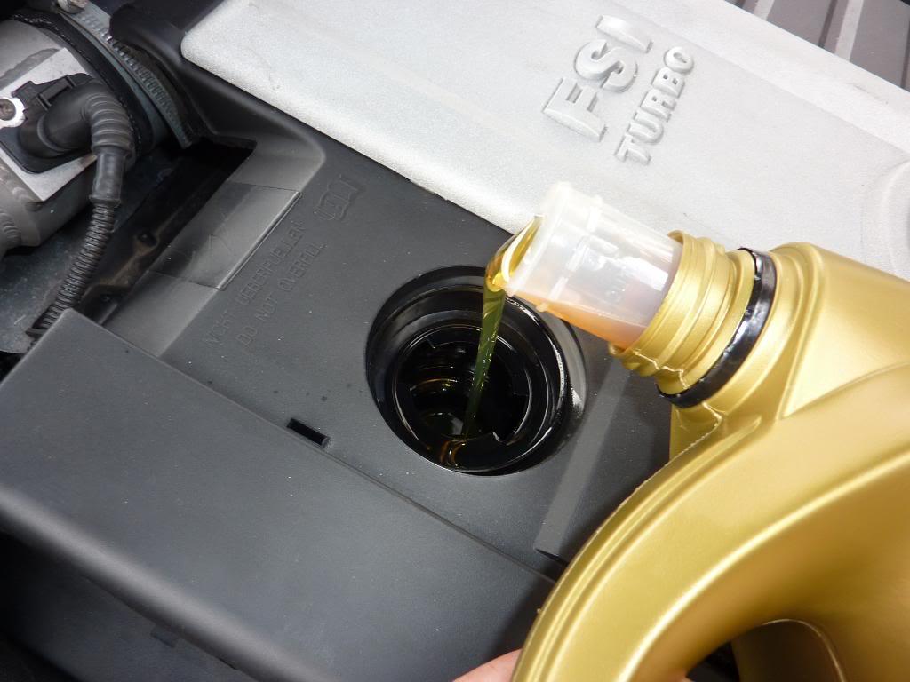

Now apply fresh oil. The vRS is supposed to take only 4.7 litres (Check Manual for how much your engine holds) but i filled up till dipstick was indicating as per the pic. Now start the engine let it run for 30 secs then topped up to the same place on the dipstick. I used 5.5 litres in total
Once all topped up run engine for 2 mins check dipstick again and if you have VCDS check for faults ( i had none )

There is actually a special tool that fits to the bottom of the filter housing to drain oil from.  :wink:

It's just a plastic tube that screws into the bottom and opens the small valve inside.
