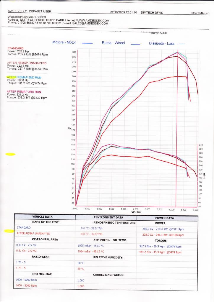

My S3 got treated to a stage 1 REVO map by AMDESSEX on Friday and I think it is fair to say that I am very very very pleased  :evilgrin:
AMD were very professional and gave me a brilliant service, I will certainly be taking my car to them for future work as I have now started my descent down the slippery slope!
They gave my car four runs on the dyno, the first one being standard and three remapped runs.  It was interesting to see how the ECU adapts with each remapped run - each run seems to get a little smoother and produce a little more power.  By the fourth run my car was producing a whopping 331 BHP and 339 lbft!!!
I do take dyno numbers with a pinch of salt though and am well aware of the different results seen between dynos.  What I will say is that I measured the pre remap output of my car with vcds block 120 and it came out at 280 BHP and AMD's standard dyno run of my car came out at 282 BHP so very similar.
AMD set my settings to B6 T5 F9.
I will be logging my car extensively and will post up the results, hopefully I'll get a chance to do this at the weekend.  I should have my SPS+ by then as well after speaking to Carl this morning  :grin:
Next mod on my list is to install my BSH Catch Can and that should be me for this year  :signLOL:

I notice your dyno run was done in 5th gear as well, same as mine when i had it dyno'd there the other day. quite interestedto know why they use 5th gera instead of 4th like most other dyno operators. also be interested to know the potentially different results the higher gear might produce
