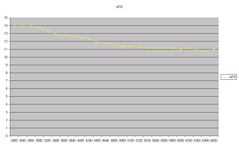

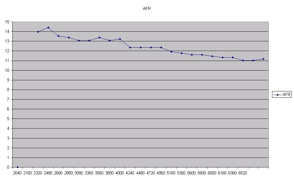

Thanks for the informative reply Keith.  It would be interesting if you did research the results for AFR and EGTs on ED30/S3s as I am sure you will see the same results as I did.
Here is a graph of my AFR on my S3 as standard:
Here is a graph of my AFR on my A3 as standard:
As you can see the the K03 is running richer through most of the rev range than the K04.
« Last Edit: October 10, 2009, 06:22:16 pm by KRL »
