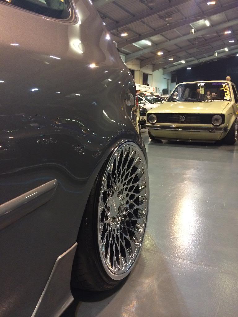

Depending how low you want to go you can make it work. I'm running 215-35-19, give you a lot more space between the arch and the tyre.
This is how mine sits at the rear... 19x9.5 et 40
My arch sits between the rim and tyre

What et is that wheel?
My mate bought stu's 3sdm's which were 9.5 rear with 225's, I test fitted them And the tyre sat past my arch so I bought 215's

225/40 on the rear is fine i only have 1 passenger in the back and it never rubs and you'll be higher than me by a long way with springs
if i wanted to go lower id go for a 225/35 but my driveway stops me  :sad1:

That looks pretty good. Is that 9.5 on 225s?  I guess your running some major lows on coilovers?

yeah I'm currently on fk coilovers  with 225/40 on the 9.5 and around 3.5 degrees of camber
At the very least you should run 215/40 on the fronts  :happy2:
