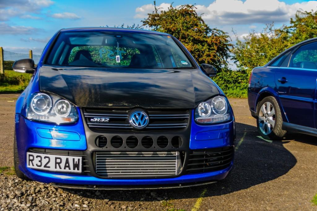

I'll start with the grille. I wanted a more aggressive look for my front end. So I had the idea of cutting 6 holes into one lol
Unfortunately I can't find any photos of the process of cutting the grille and cutting the bumper but heres some shots of the finished part

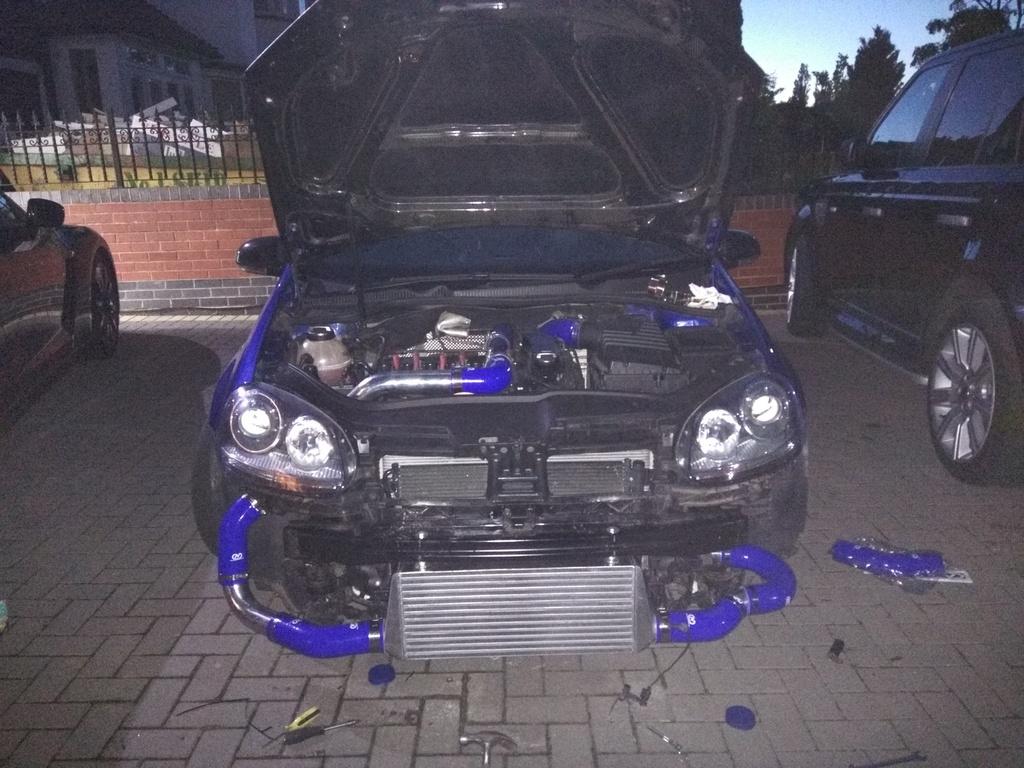

Next up is a long standing issue with the HPA/HGP kit in my opinion. The intercooler! It's just tiny and way too small in my opinion. I was planning on buying another side mount so I'd run two but I decided against this idea and made my own big front mount instead. The pipework isnt final but it works. I will get all the pipes made and welded so its hard piped the whole system
Originally I planned on trying to use VAG parts so I went ahead and got a TTRS/RS3 Front mount. However once I lined it up I wasnt happy with the size and bought a huge front mount instead and hoped it would work!
Below is a pic of the TTRS/RS3 IC against my new FMIC
Mocking up the pipework and where I wanted the FMIC to sit
Once I was happy with the fitment I realised I had to mount the intercooler to the crash bar. Having snapped 8 drill bits, oxy was the only way!
Now all that was left was to trim parts of the bumper and get all the pipework fitting right
Another task was the routing of the pipework under the bonnet. I've always hated that crumpled pipe in-between the coil packs but due to time restraints I couldn't remove it just yet

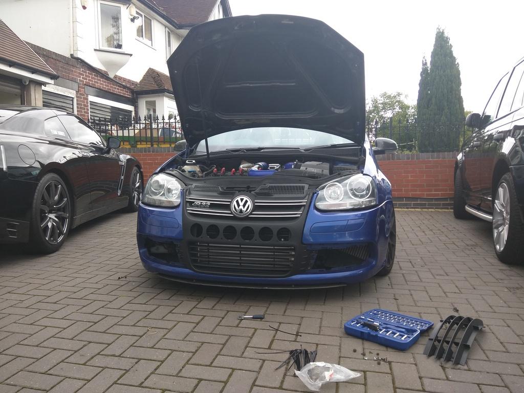

So will everything sorted I went ahead and put the front end back together
I tried it with the lower grille in but decided I preferred it without for the moment
