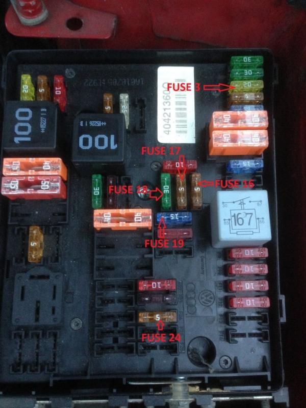

Fuse 3 - 91ma
Fuse 16 - 73ma
Fuse 17 - 33ma
Fuse 18 - 123ma
Fuse 19 - 792ma
Fuse 24 - 73ma
I did a battery voltage checks...
6.45pm = 12.2V
7.45pm = 12.0V
8.50pm = 11.8V
Absolute huge drain! So that's 3 nights in a row that the drain has been there. And btw I got these numbers using the conversion table that Ed sent to me.
Here is a photo of my fuses so that you can see which fuses im talking about.
Offline Craigh1983
  • Posts: 389
    • Leicester Wedding Photographers
Re: Battery drain still happening... Completely stumped :(
« Reply #72 on: April 10, 2014, 10:15:34 pm »
I have a vague idea of what some of the fuses I have listed are for, however I was wondering does anybody know what FUSE 18 is for????????
And if someone could help me out in telling me what Fuse 3, 16, 17, 19 and 24 are that would be absolutely brilliant! :)

Offline SI-R32
  • -Receive: 126
  • Posts: 1001
Re:
« Reply #73 on: April 10, 2014, 10:26:03 pm »
19 is stereo, do you not have a user book with the car with a fuse list
Offline doylebros
  • -Given: 44
  • -Receive: 310
  • Posts: 2776
« Reply #74 on: April 10, 2014, 10:30:00 pm »
Just confirm your year build - eng AXX or BWA  and gear box code or if it's manual or Auto. As there's a few different types!
F3:- I think is convenience system, but need above confirmed prove it!
