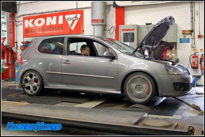

car went on the rollers at awesome on sat
well it ran ****e lol
woke up to set off to awesome and exhaust light was on
got to awesome plugged bluefin for fault code, the car then had a paddy, immobilised itself, wouldnt start or turn over or anything
got the standard map uploaded and started, then got the stage 2 map on and took it out for half hour, was boosting as standard and boosting different in every gear, 1st and 2nd was struggling to boost at all, 3 was maxing out at 10psi, 4th 12 psi and 5th and 6th maxing out at about 16psi
had it out for a few miles with it obviosuly still been in learning mode but nothing was changing.
Decided to stick it on the rollers anyway but wasnt expecting good figures or anything near what i should have been getting, this was proved right when it went on
heres some pics
best run was 233.7 bhp and 333.48 ft/lb torque
was expecting between 250/260 but i knew it wasnt running right
spoke to awesome and they suggested it could be the pvc system as they are a known weak spot on these engines
so got back to r lasses engine cover off quick check to see if i cud see anything, nothing much tbh
few bits of debree in end tunnel so cleaned that out
so now i need to contact bluefine to double check the map, will send them the print out etc and ask why the boost is so unpredicatble
so the continues to give me grief lol
drives fine, smooth etc and no problems, just not producing the power it should be

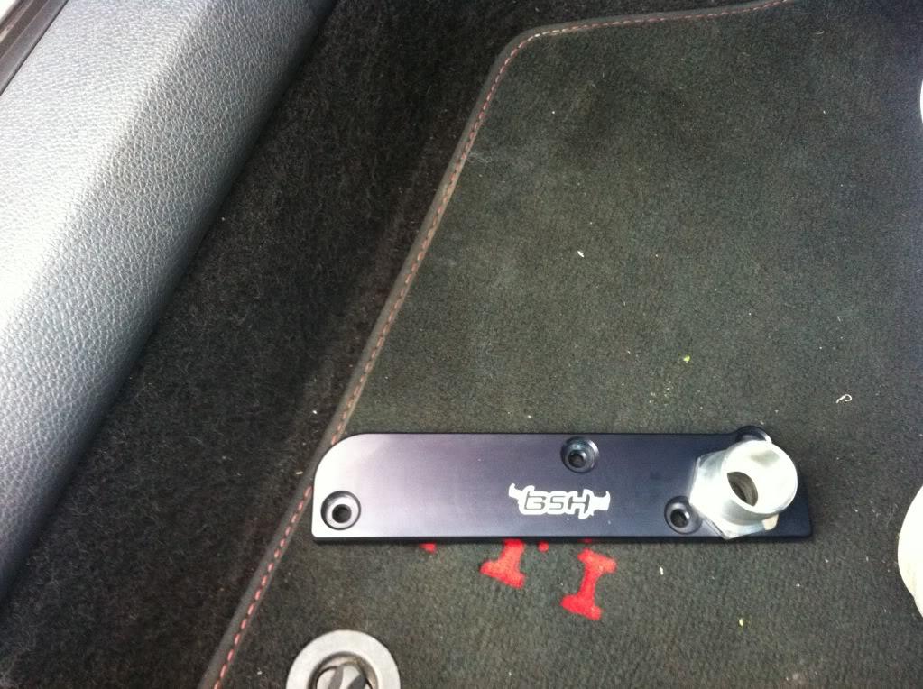

Here's a pic of the broken PCV.
You can see the check valve inside is broken, the circular piece should be centred, but its broken a loose and never creates a seal.

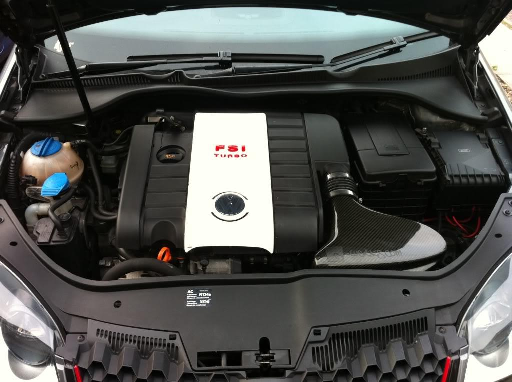

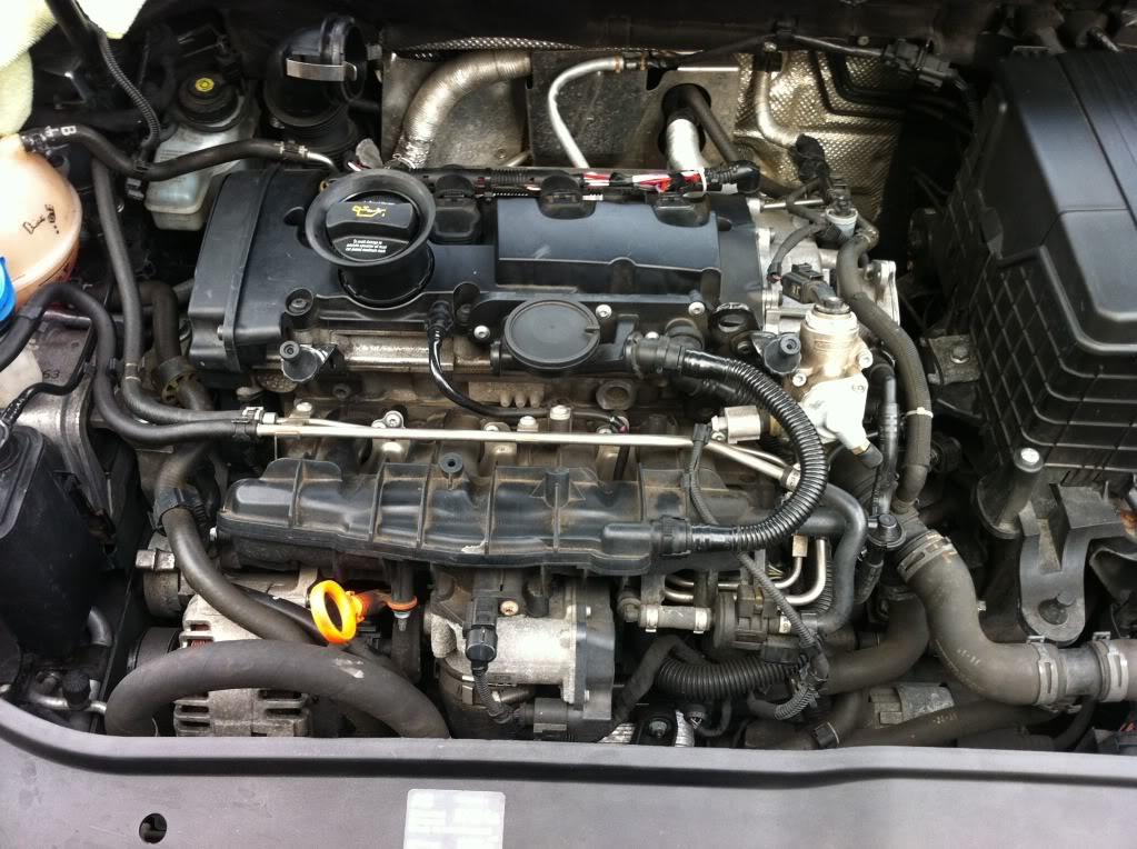

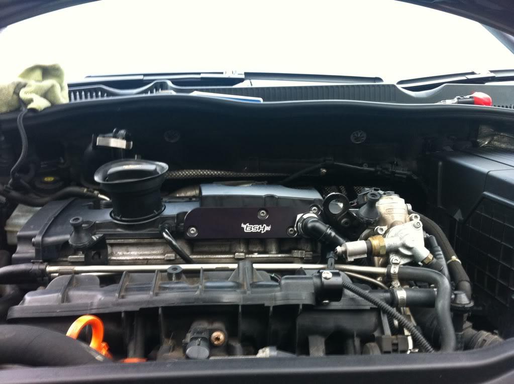

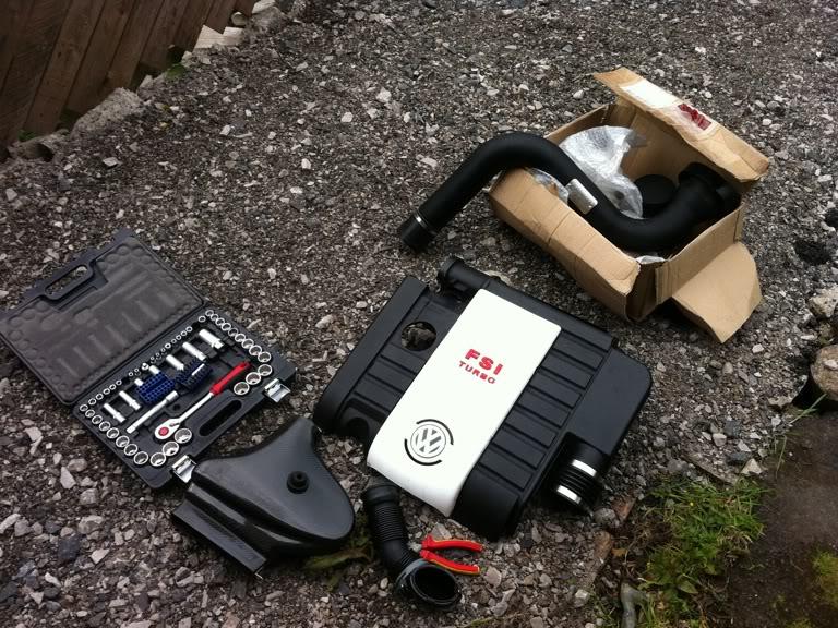

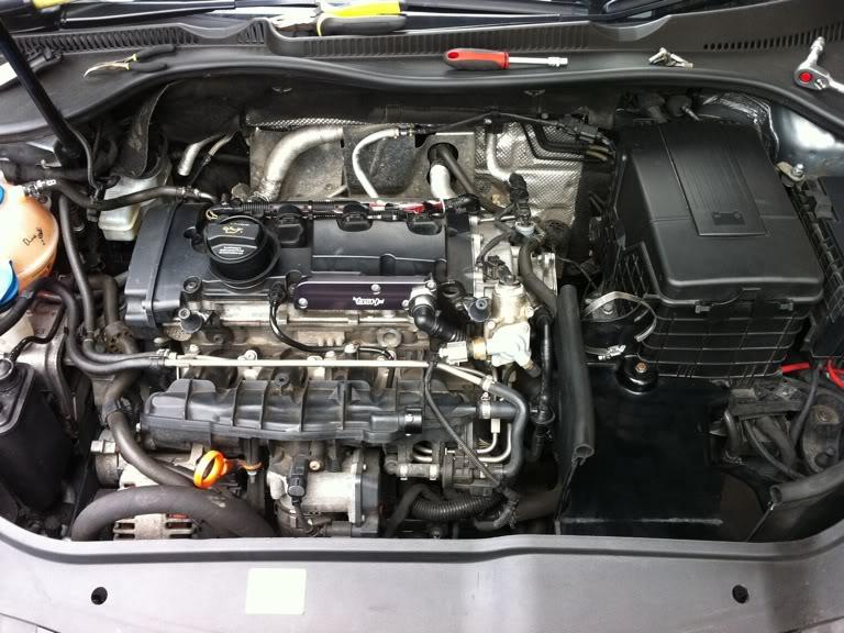

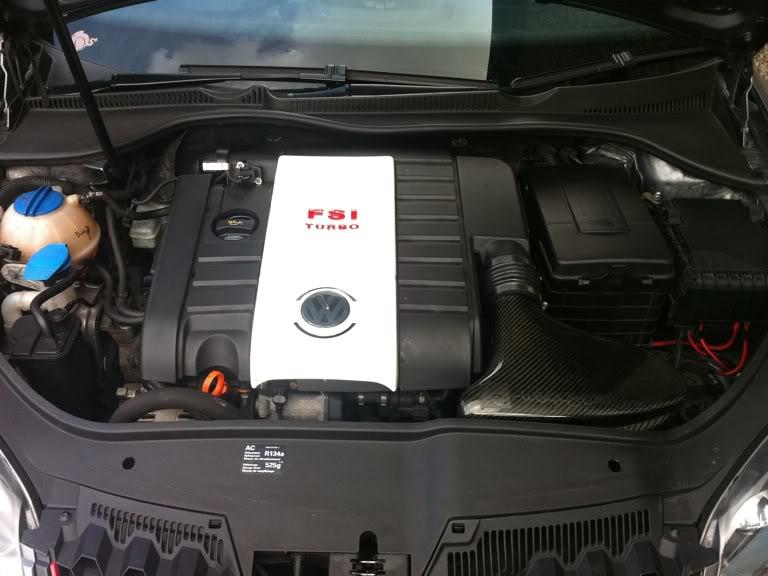

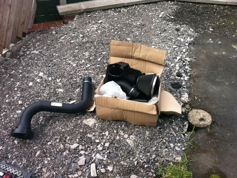

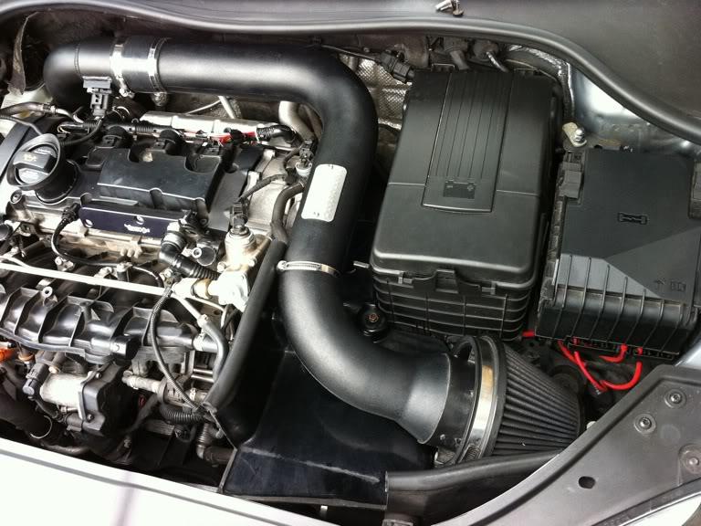

got the intake on friday morning and fitted it quickly before i set off for a weekend away with the missus
the goods
before
everything out and air box in
intake in
the sound will take some gettin used to, its like having darth vader in the engine bay, will try n get a good vid to show the sound, havnt really had chance to notice the gains as cars had a steady drive when i have used it over the weekend but not used much.
Still needs engine cover chopping up to fit and also heat shield fittings as didnt have time to fit this, any good pointers for getting engine cover mounts off to fit heatshield? had one out before but was a ball ache and was slightly loose.
also a mate let me know you could see my car in golf+, was a feature on awesome gti and must have been done when my car spent most of its time in there
