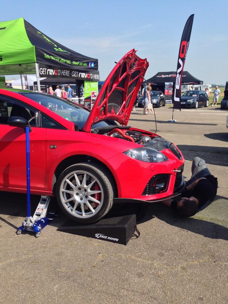

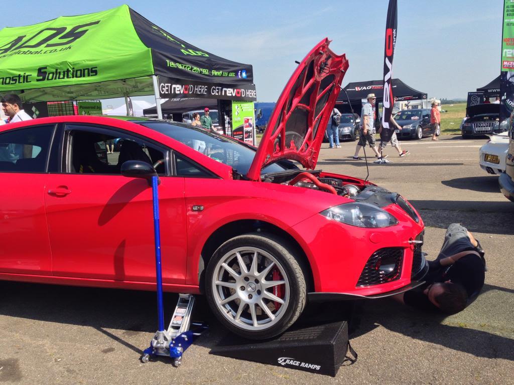

I managed to drive gently from Nottingham to Gti international without limp kicking in then as I pulled out of the junction at the raceway it went again  :sick:
Alex from AKS fixed it at the show, hungover. The legend lol
