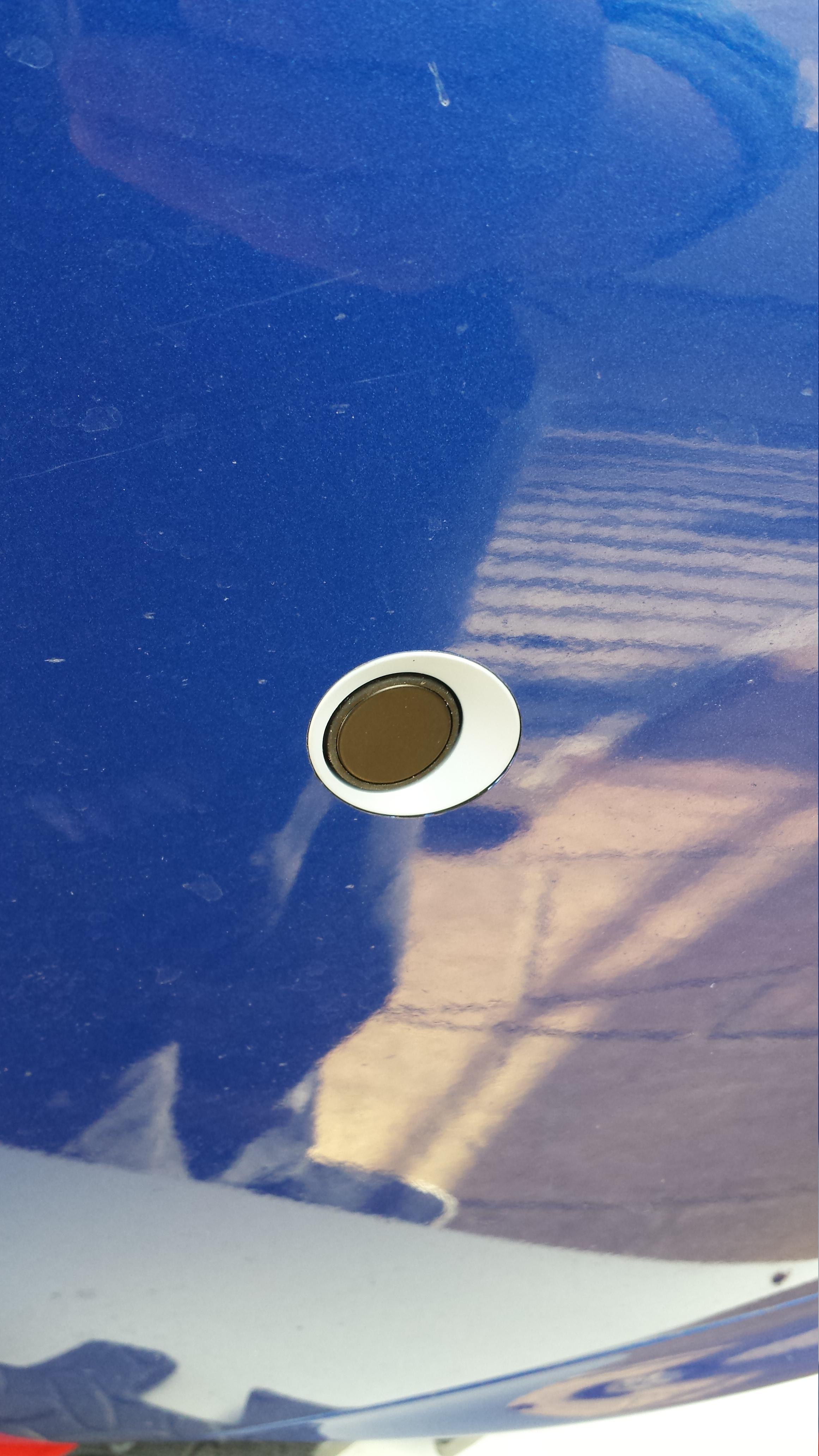

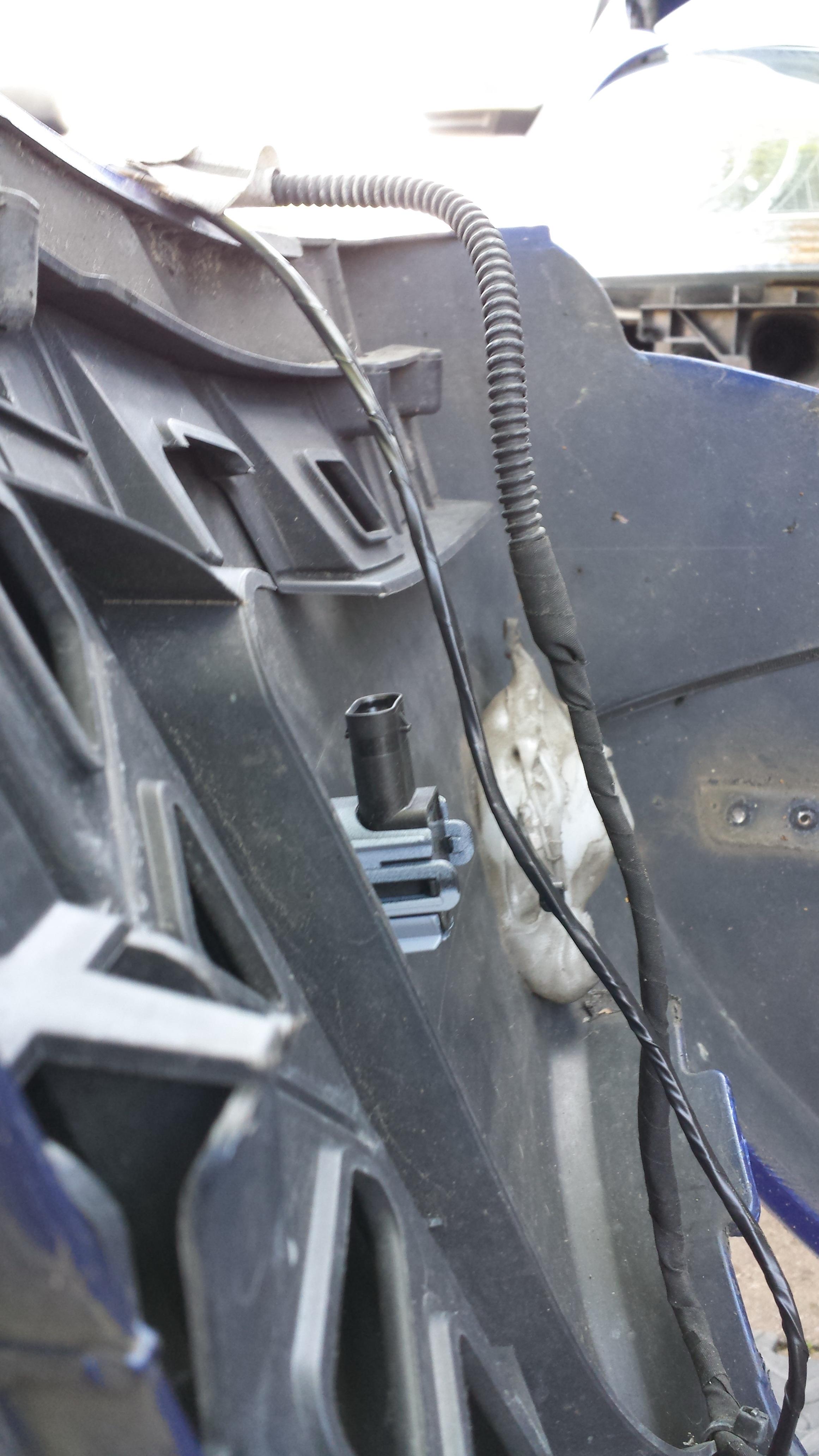

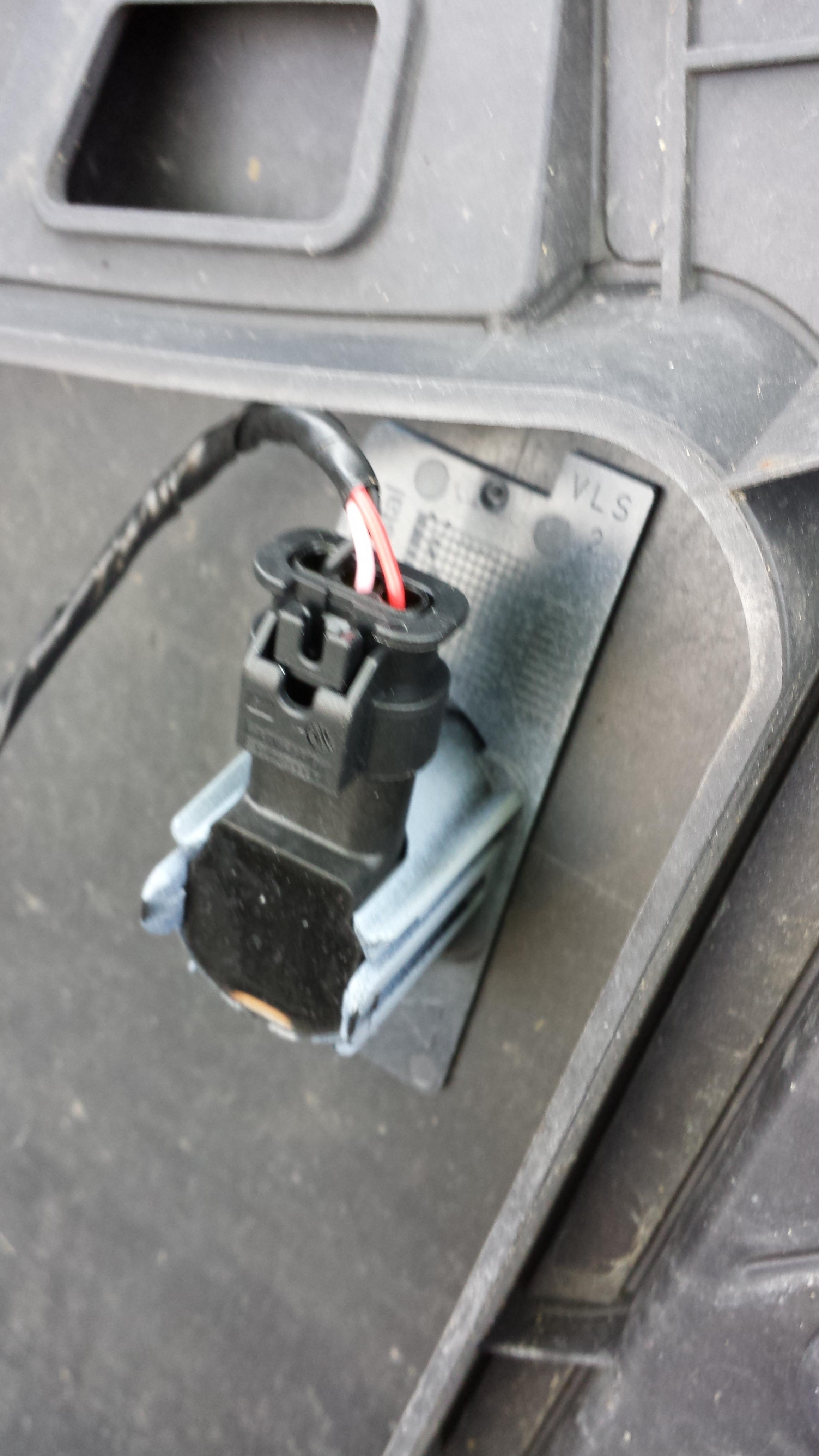

the other week i removed the front bumper, lots of guides already on line to do this and its quite easy once you've first done it

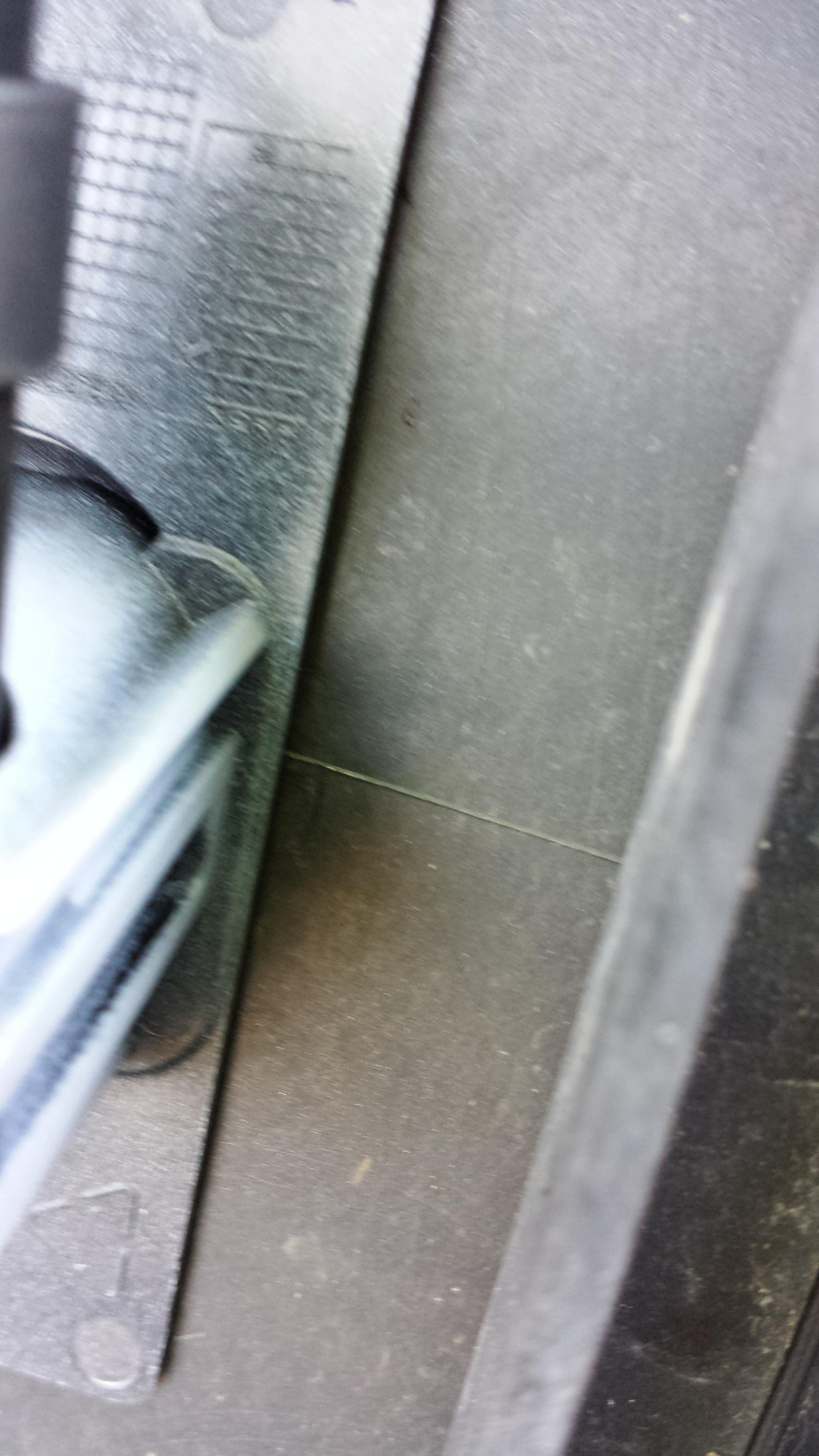

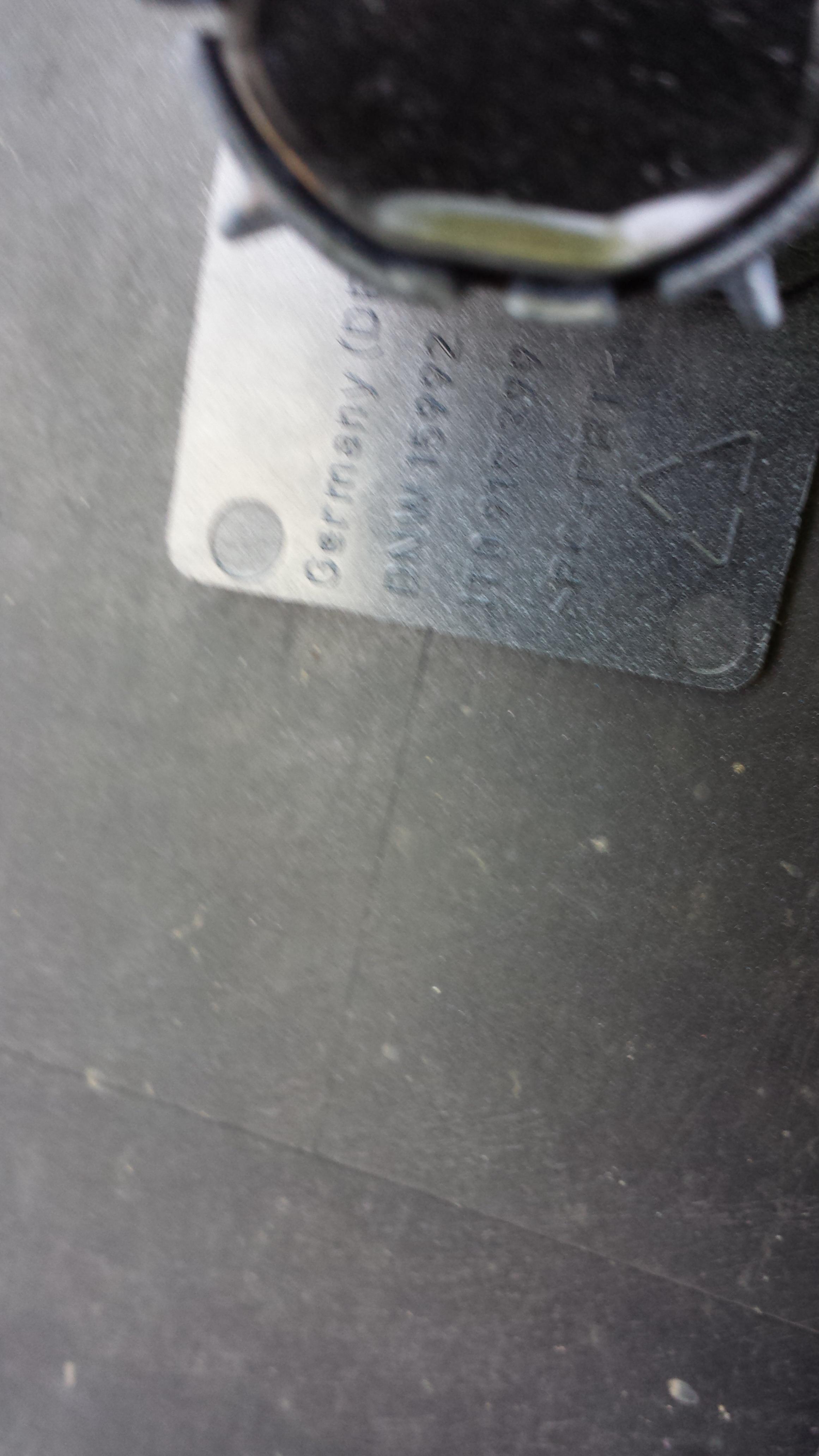

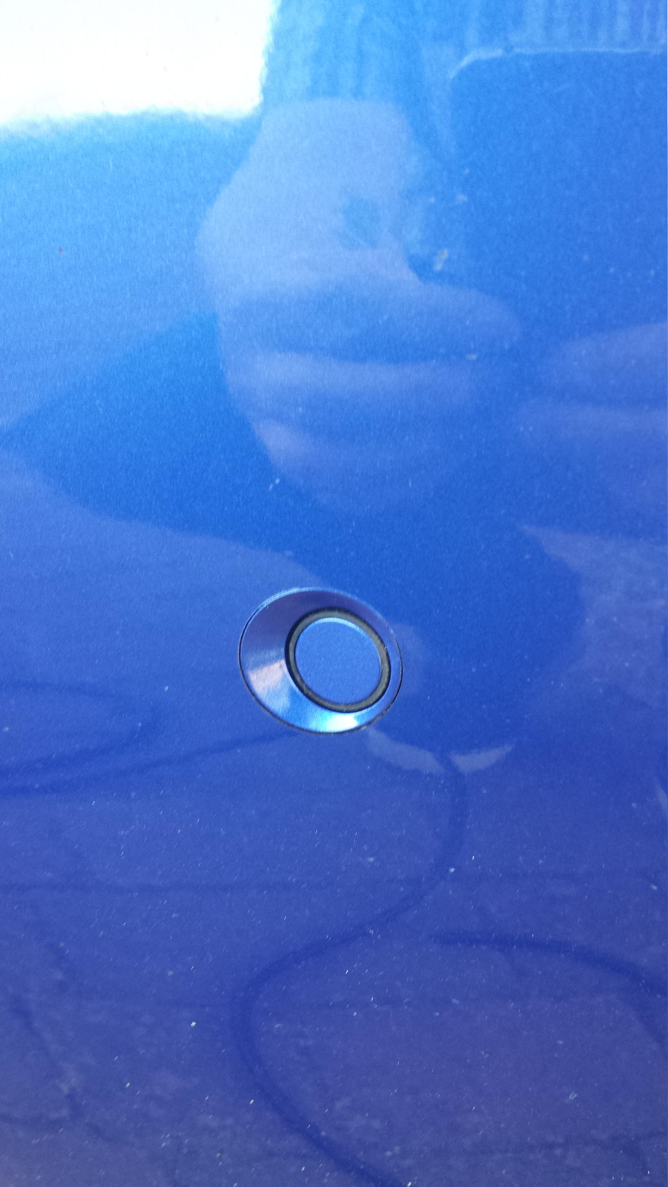

on the back of the bumper i checked i had room where i roughly wanted the sensors to go and on the back of the mk5 bumper it has some crossed lines in the abs plastic clearly park assist wasn't around then but i used these crossed lines as a guide to drill the holes.

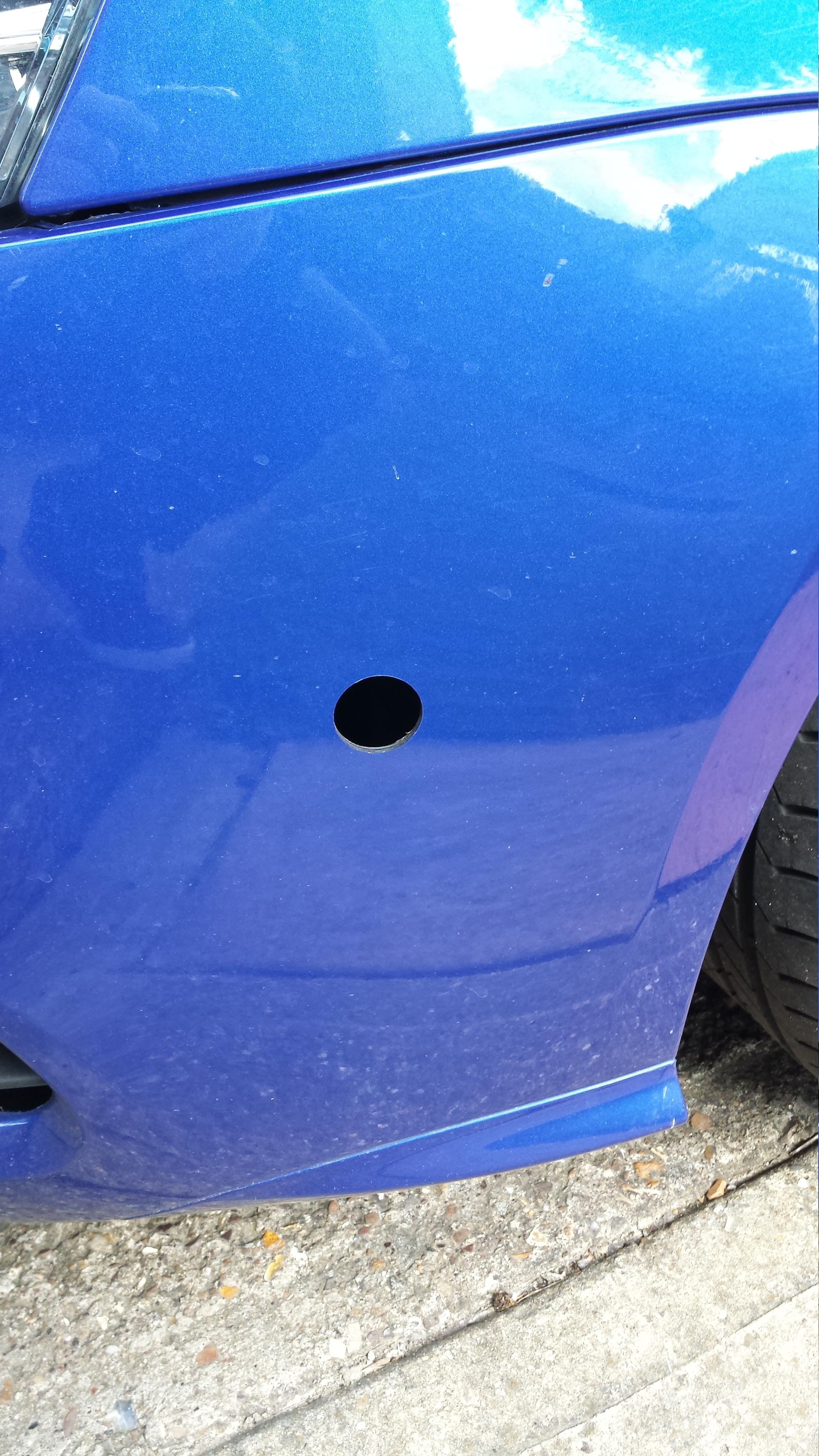

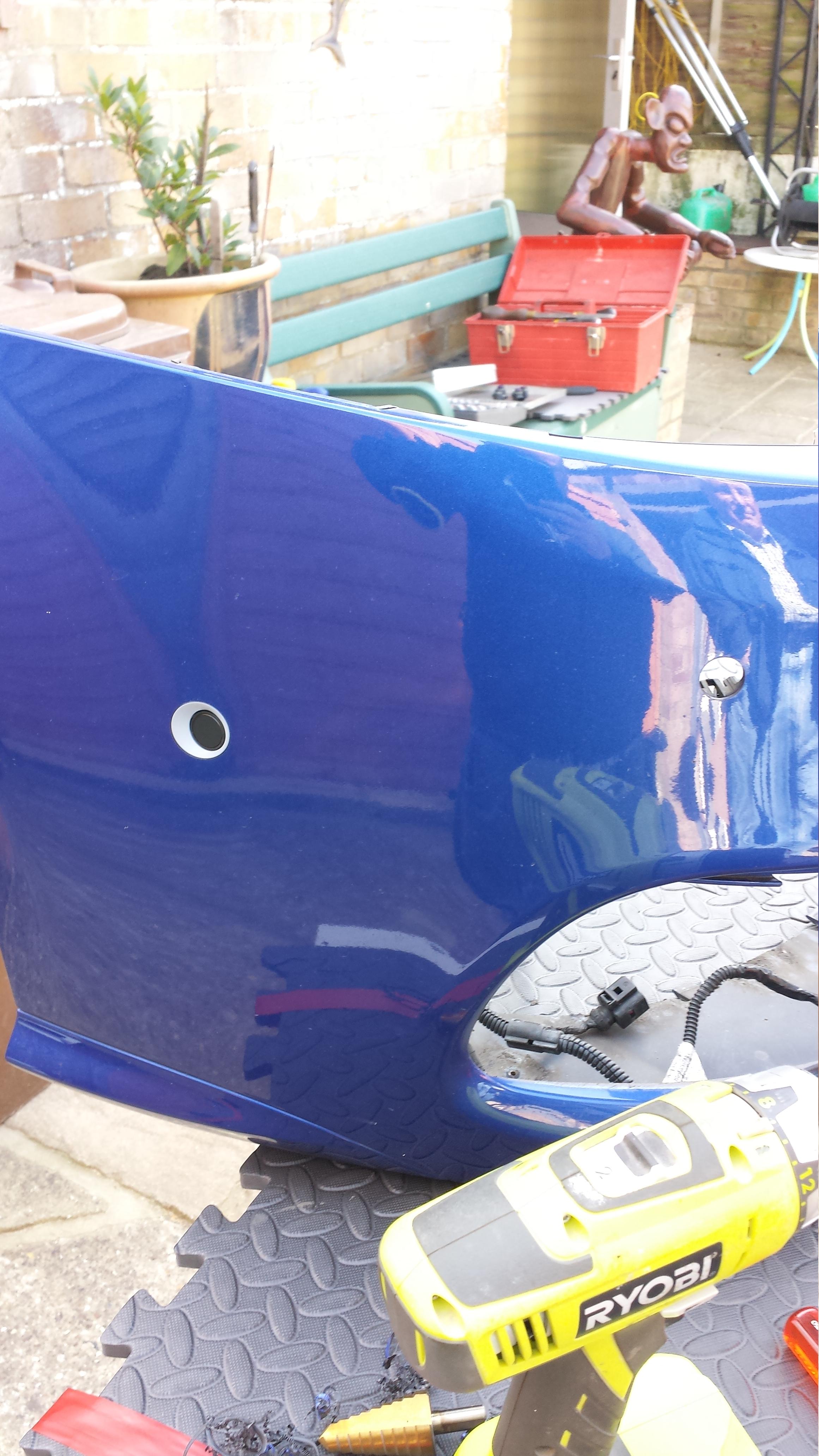

i used a 28 mm step cutter to give a perfect cut through the paint, the biggest of the 3, if you try to use a bigger one and stop on 28mm you'll just bugger up the hole and go through bigger as its not easy to stop in soft plastic. I have 18mm,26mm and 28mm for various parking sensor jobs
so the sensors need to be pointing out at roughly 90 deg from the car again its not that easy as it was never fitted to the mk 5

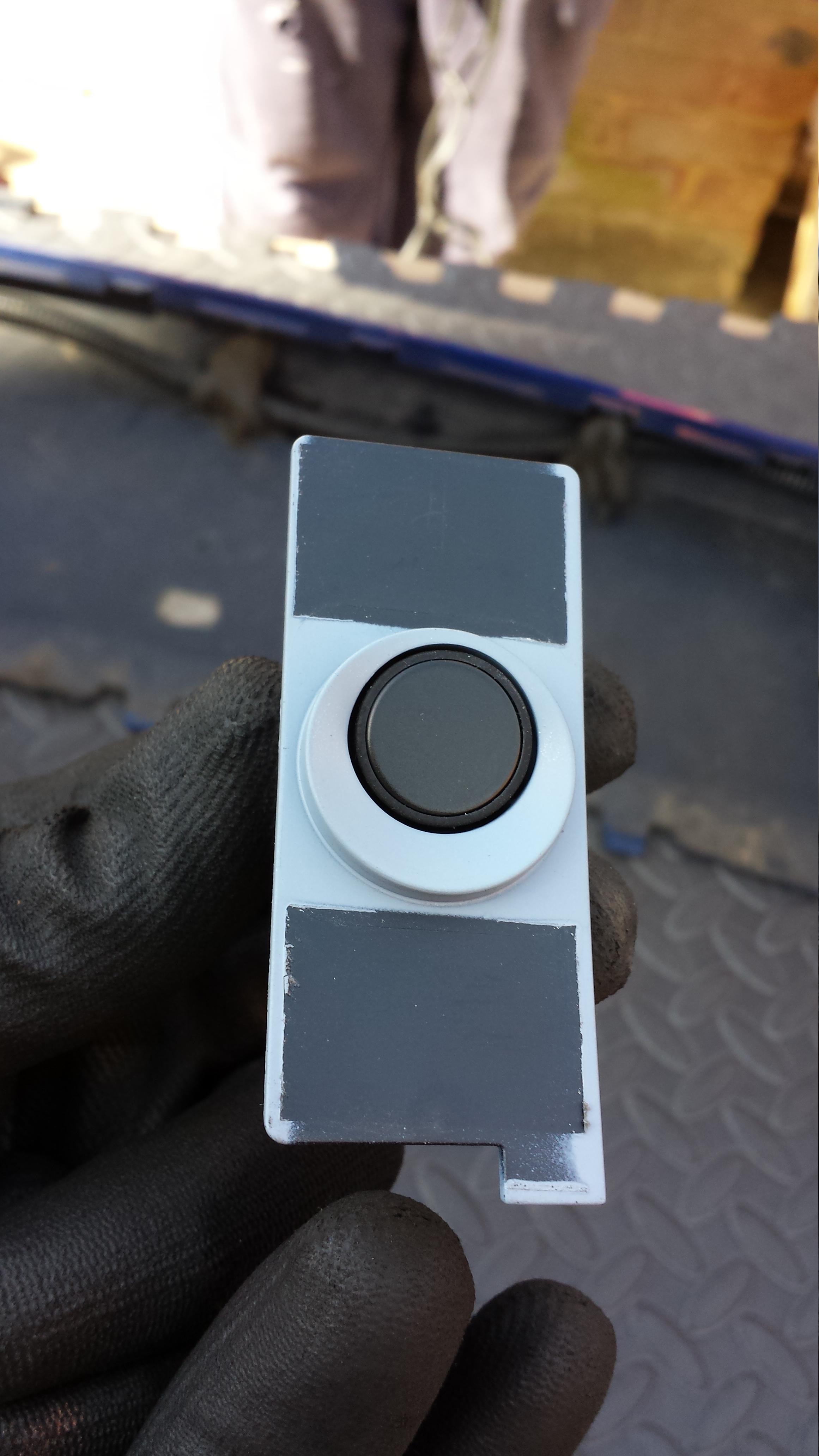

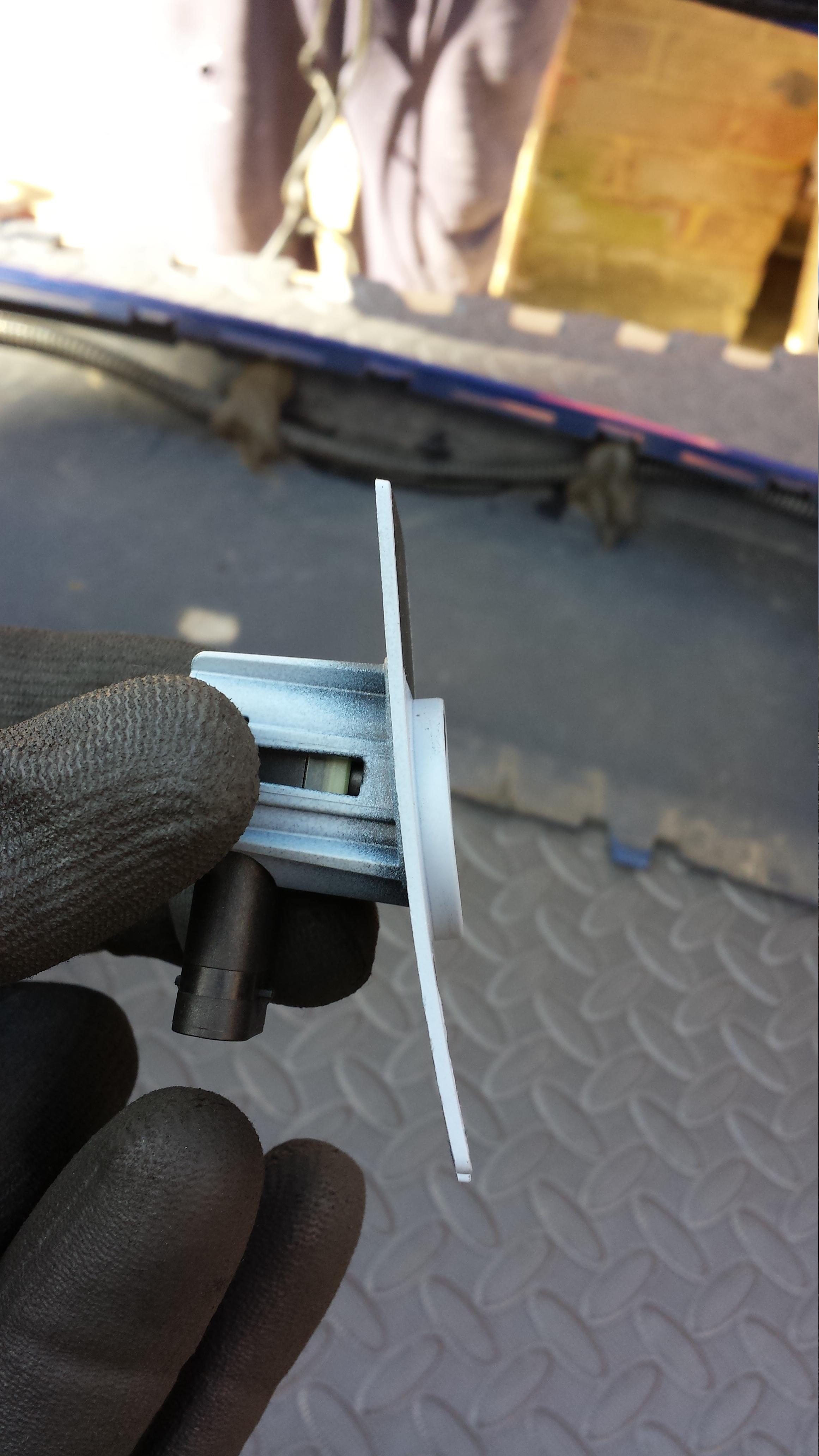

the sensor holder needed the foam sticky pads removing as we have thicker bumpers on the MK5 compared to the MK6, I will probably use adhesive silicone sealant to stick them in as i use this quite a lot and it works very well
here is the holder
tested for size in the bumper

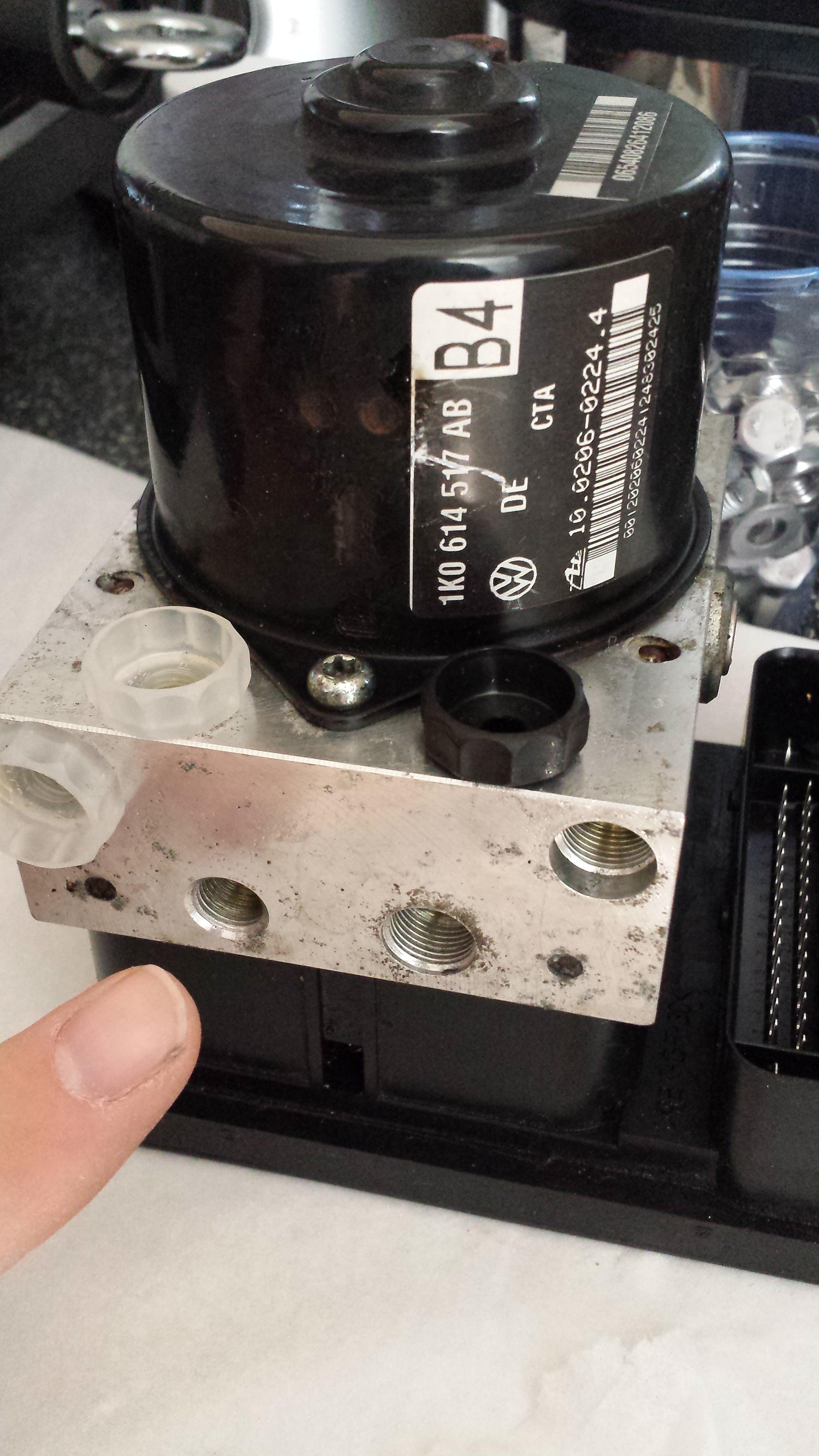

so now to the ABS unit, this is fitted behind the battery and airbox area right down the back. on LHD cars this is under the brake servo where as ours is on the opposite side
This is the little baby that needs changing
there are various units we can use here is a list
1K0 907 379  AT or BE or BJ or BL
AT = MY 2010
BE = MY 2011
BJ = MY 2012
BL = MY 2013

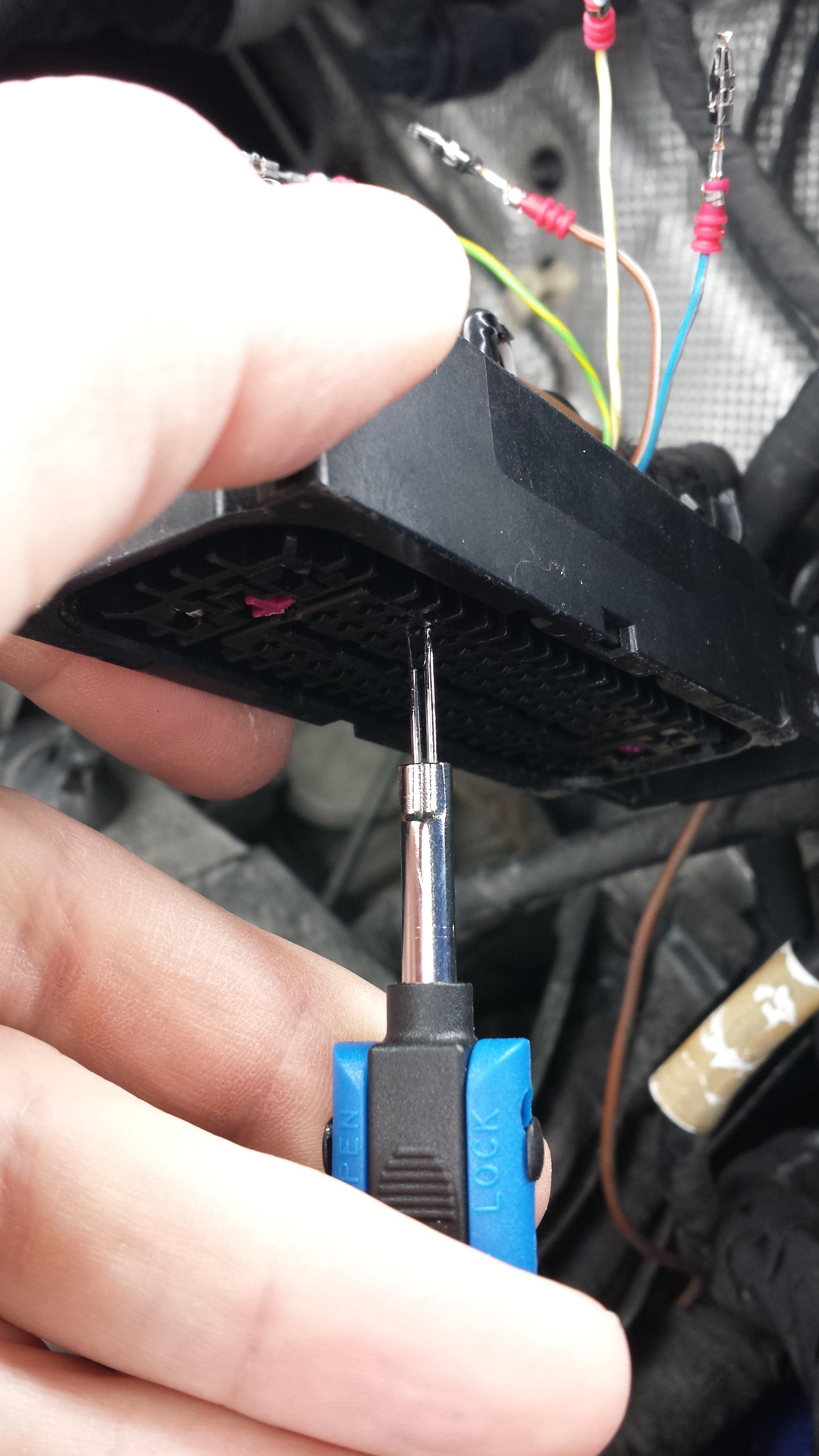

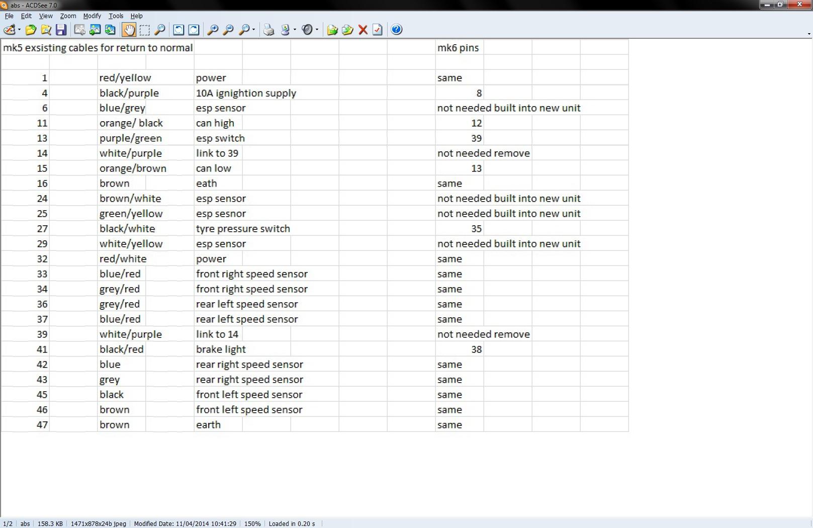

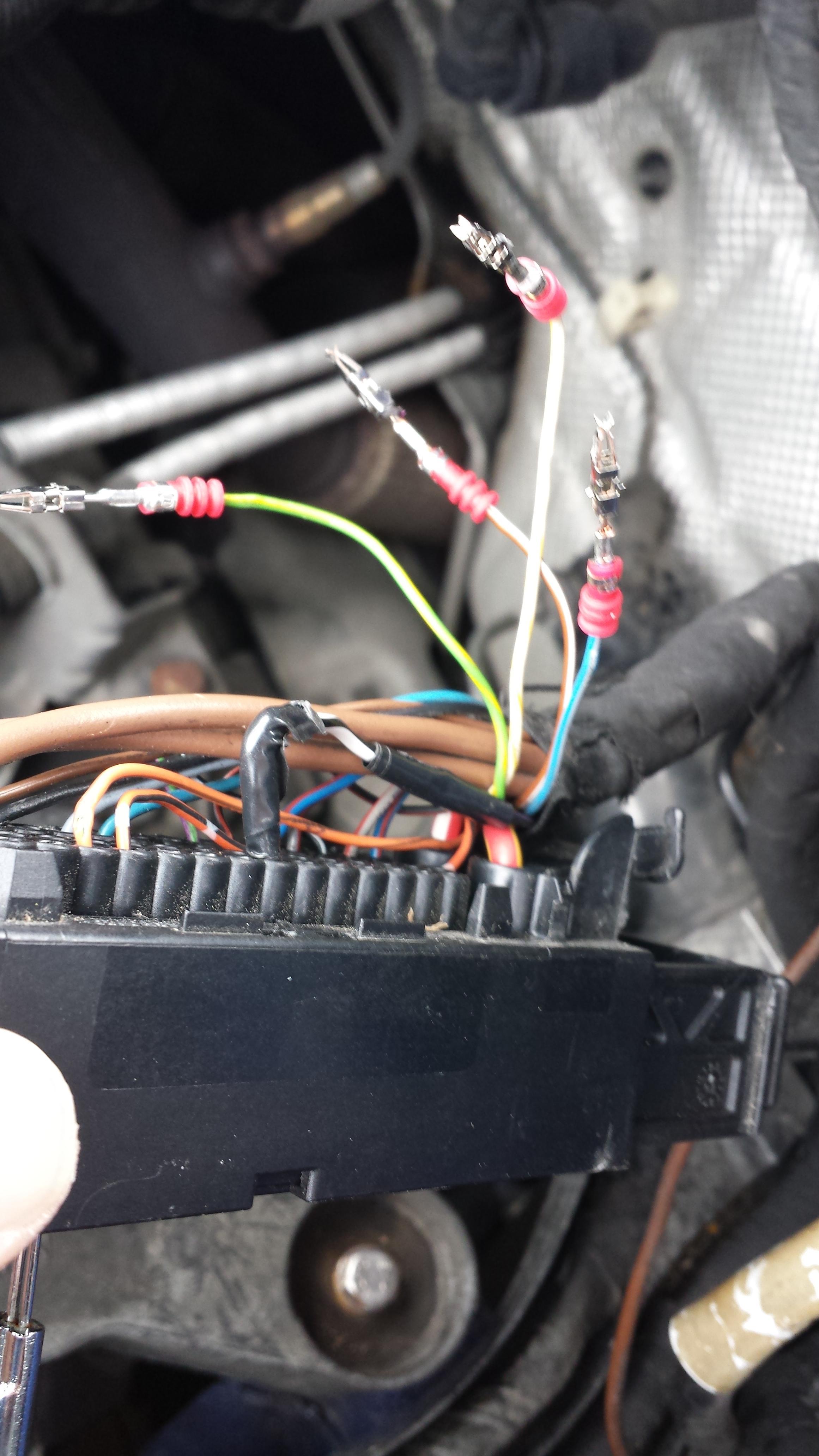

but first hurdle is the wiring as the MK6 wiring changed from the MK5, so i started on this first to re pin the plug with the correct wires in the correct pins.

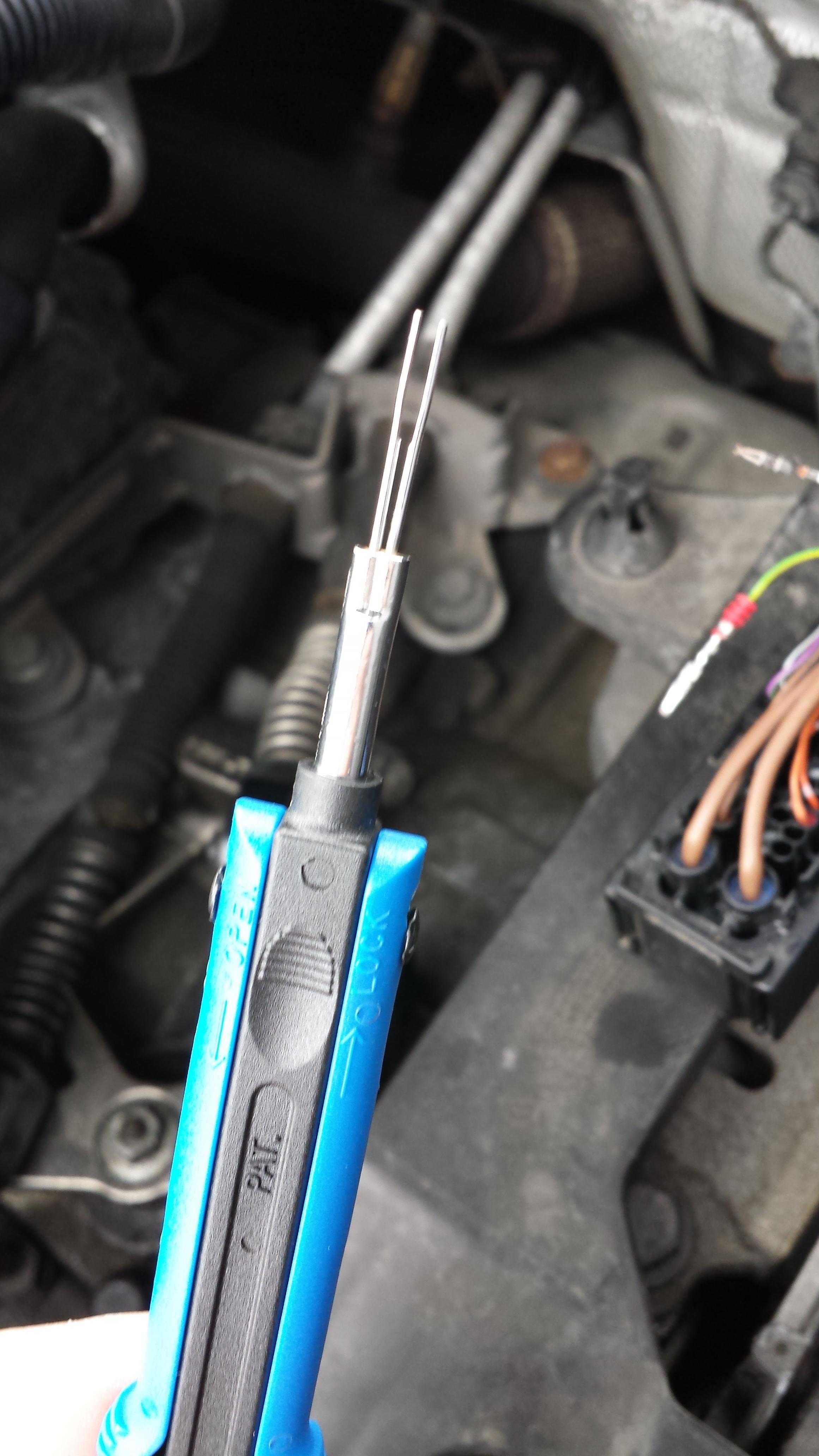

you will need one of these a pin removal tool
here is a list of what you need to do (i can't guarantee this is the same for every MK5 but it is for a 2008 R32)
take the back off the plug to see all the wires
slide the purple locking plastic to the open position in the plug
now use the tool to start removing the pins
so there are some cables that are not needed any more as the new ABS unit has some sensors built in rather than being a separate unit, so tape the cables up separately you have them.

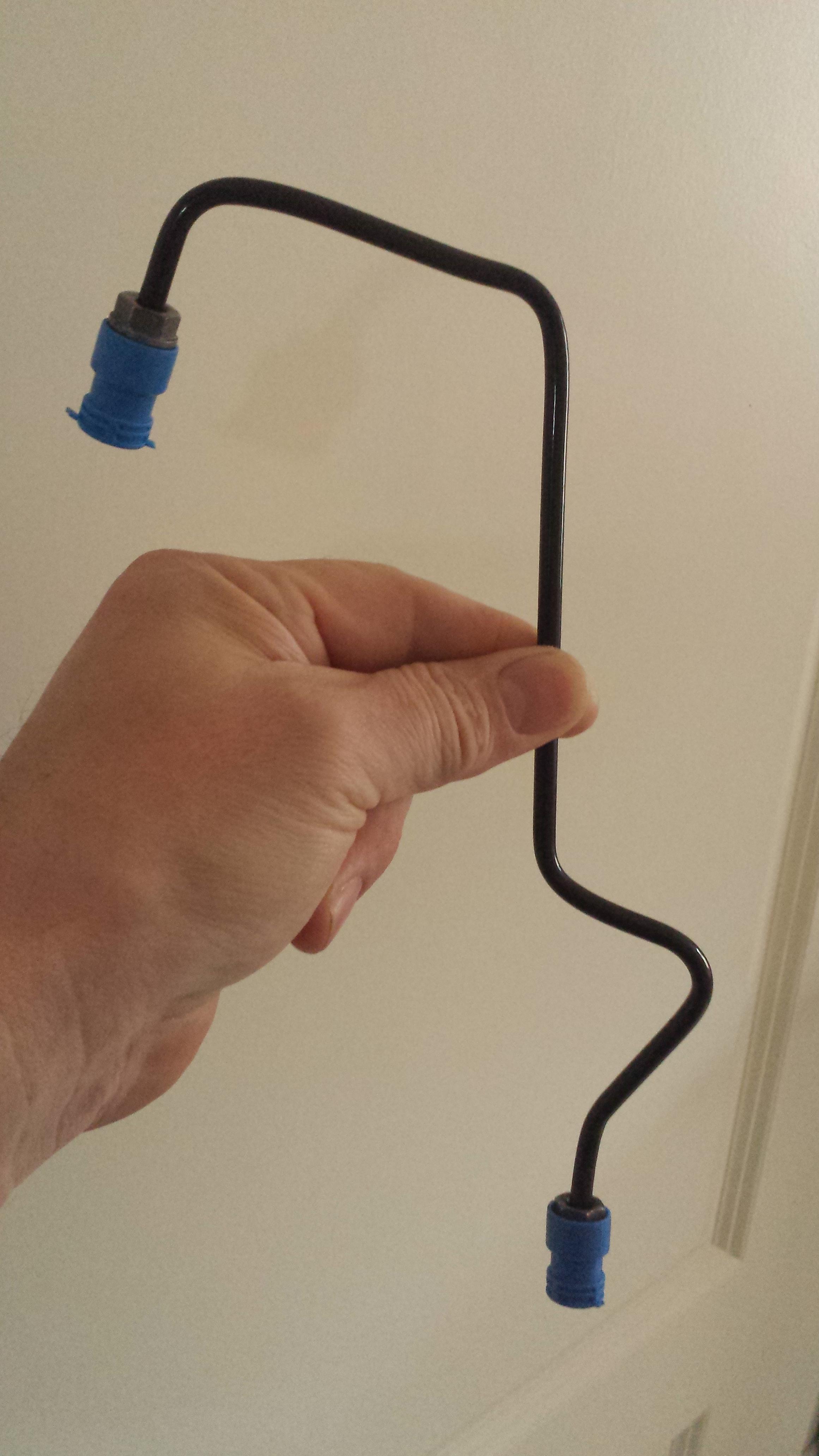

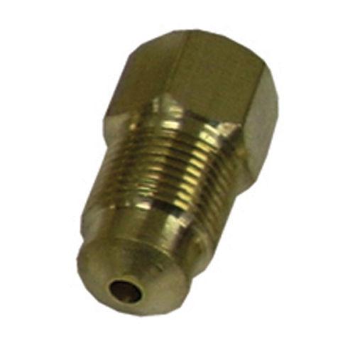

once the old ABS unit was out i discovered a small problem vw have decided to swap the size of the 2 inner holes here
what was m10 is now m12 and vice versa, so luckily brake lines are really cheap from vw so i've ordered a new passenger side brake line from the MK6 which has the correct ends on for the ABS to brake caliper. Ordered from TPS 1K2614723F and also I've got this coming (see pic and eBay link) from the USA (could not find one anywhere in the UK) its an M12 to M10 reducer for brake lines

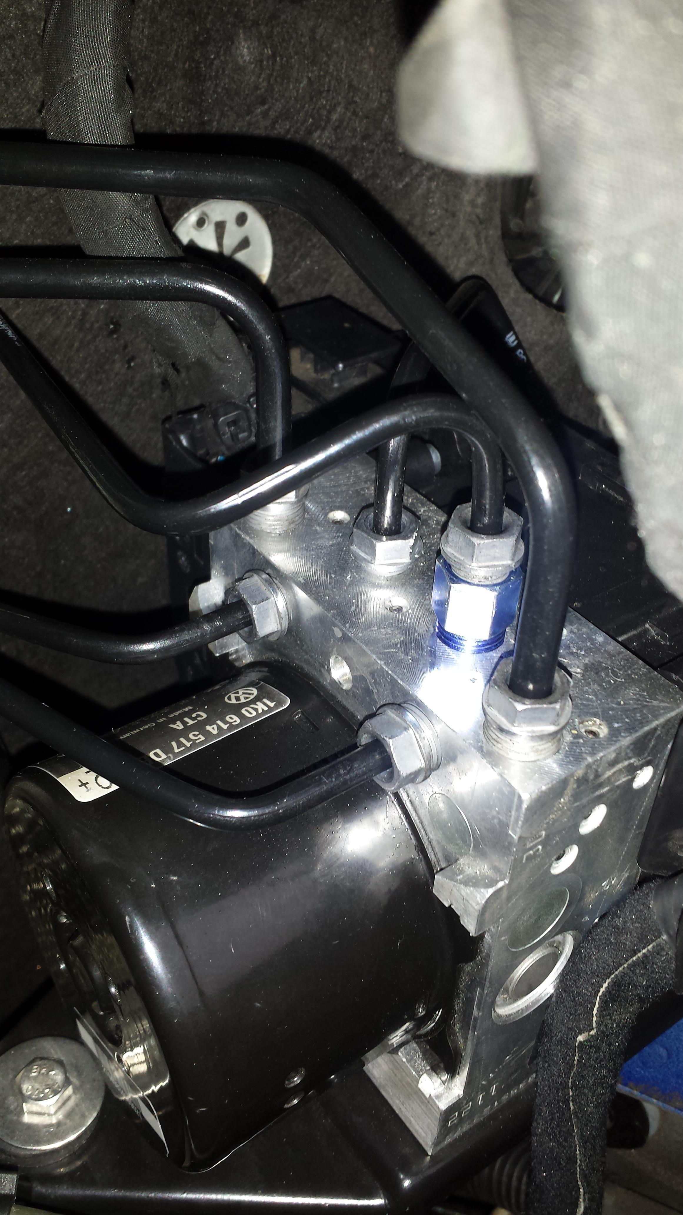

OK so eventually all my bits turned up, so i could crack on, so first I changed the passenger side brake line as it now has M10 fittings on both ends rather than M12 ABS end M10 brake end.
Then I put the ABS unit back in the car, I decided to order a new MK6 bracket as well, once in piped it all back up
The blue adapter is the M12 to M10 reducer i had to order from American eBay see link
http://www.ebay.com/itm/190856703804?ru=http%3A%2F%2Fwww.ebay.com%2Fsch%2Fi.html%3F_from%3DR40%26_sacat%3D0%26_nkw%3D190856703804%26_rdc%3D1
So at this point i was ready to bleed the brakes, many procedures on line to bleed your brakes, it was a bit of a pain as i'd only done this once before but I'm quite confident now at doing it.

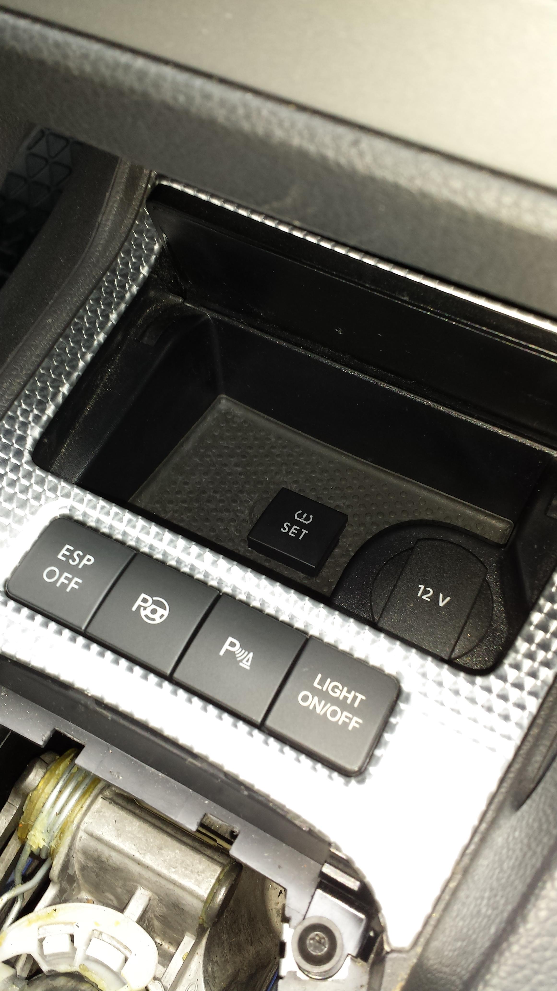

Right I could now concentrate on wiring the other sensors and the extra switch

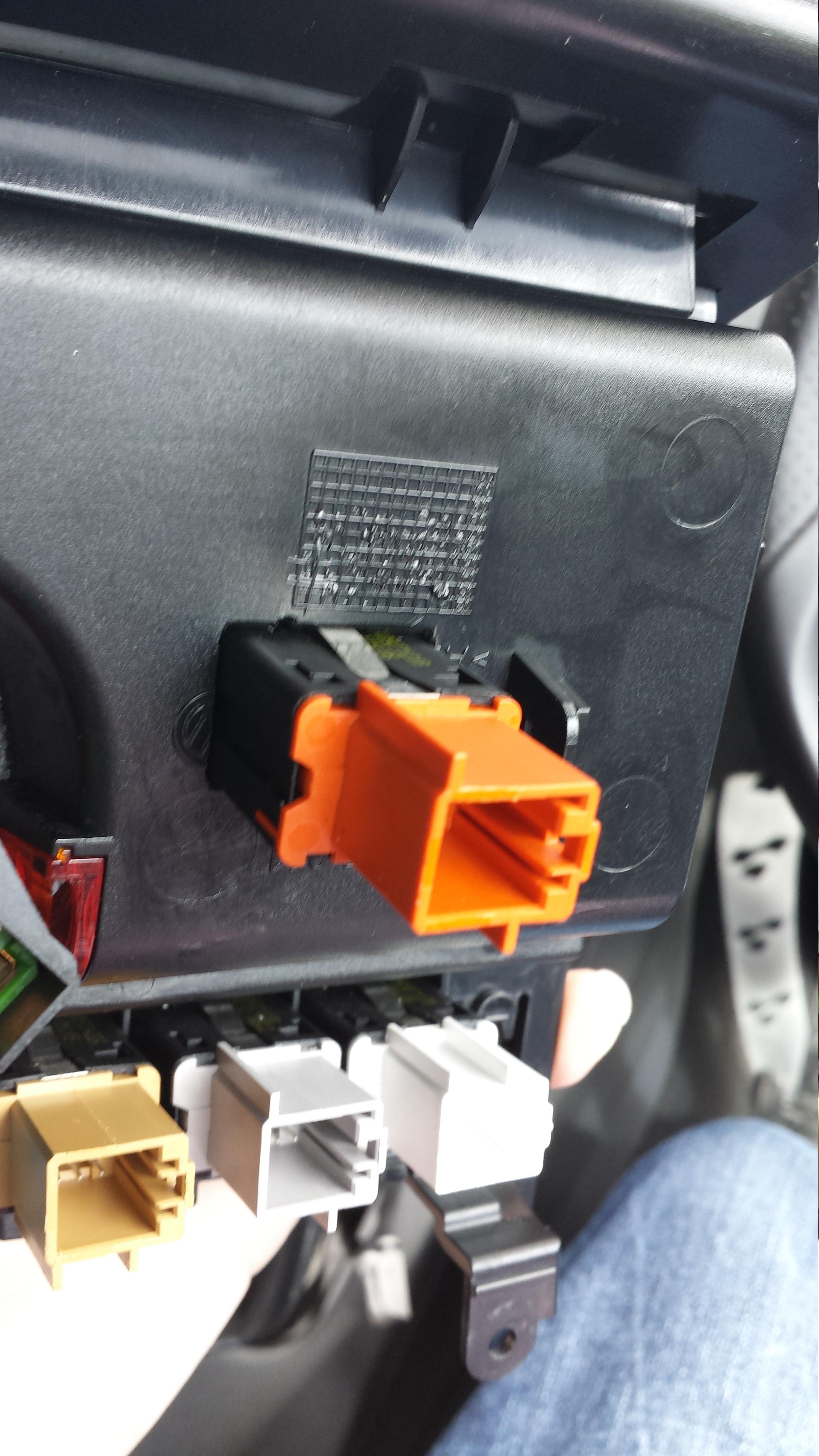

I decided i really like my Engine Spin pattern on my MK5 ashtray so I didn't want to buy the MK6 ashtray with the extra switch position in
I hardly use the tyre pressure switch but clearly i still want it, so i moved it to somewhere else, this is easily reversible by buying a new rubber for the bottom of the ashtray.
Now slight difference in location of the control module in the MK6 to the 5, my unit is behind the driver side trim in the boot MK6 is above the BCM at the front of the car, so i needed to extend the switch and front sensor wires with a bit of soldering to reach the back, quite easily done.
