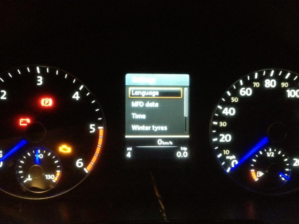

http://www.r32oc.com/topic/47115-a-uk-1st-scirocco-r-clocks-in-my-mk5-r32-sweeping-needles/
I'm sorry but this wasn't the first as I saw it done towards the end of Summer 2012.
Well, okay, first Scirocco R cluster
The ones I mentioned were Scirocco TDI R-line cluster , I can only presume it's similar to the 'Rocco R petrol ones.
Taken a pic from  his car which was working
Working with steering wheel controls, with immobilisor active and functioning correctly
a very good mod but IMO needs the rest of the interior lighting changing to match.
