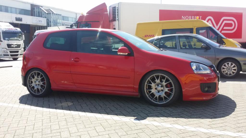

Hi meet dna
I got Edna in november and loving her to bits although she has some issue! She get quite smokey when I give it some and shes not making the power im expecting!
She is currently at stage 2
Forge twintake
BCS 3" decat
APR stage 2
Ran her on TXautospors dyno on satyrday and she only putting out 301bhp!
Edition 30 stage 2 issue:
id be grateful for any help and advise! Cheers

Welcome mate, you made the right choice buying an Edition 30 and get more pictures up. :happy2:

Cheers pal will do once shes clean
