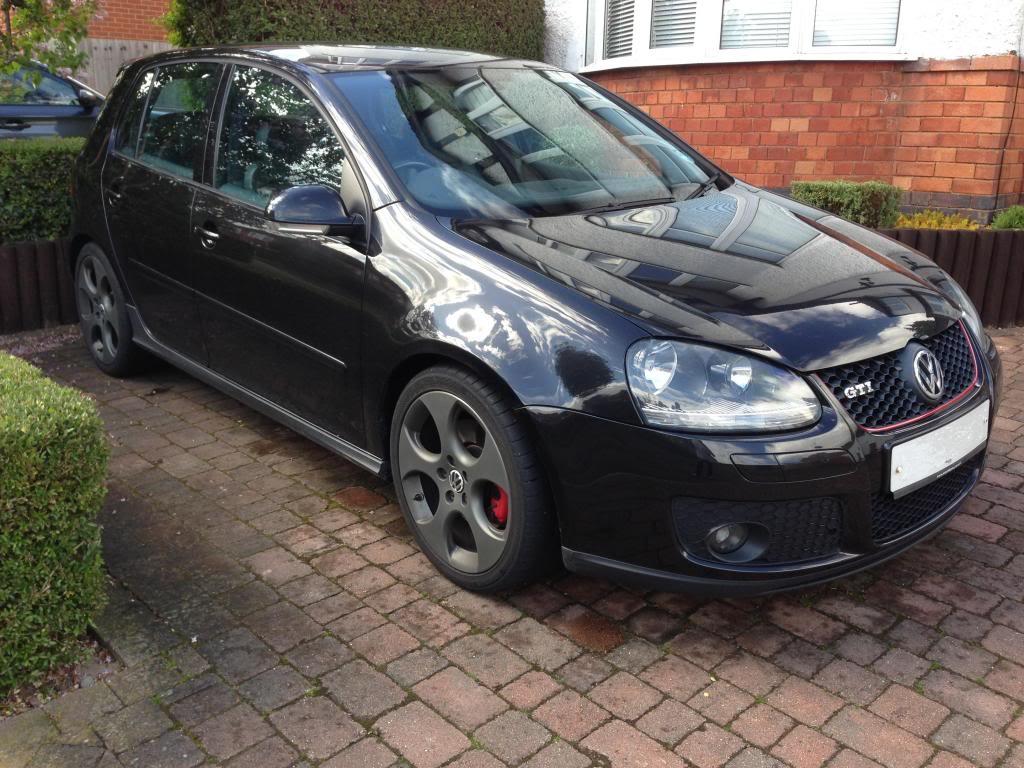

So, as requested I have taken a pic of the car (yet to be cleaned and polished due to the point above!) but not sure how to upload it  :ashamed: I see the insert image icon but it doesnt show me where to search on my drive. If someone could educate me here that would be appreciated.... but here is the spec to start with:
Heated leather seats, cruise control, dual climate, sat nav, rear parking sensors (to be fixed!), headlamp washer jets, multi function steering, 6 disc changer (I disconnected the iPod connection as I am old skool!), auto lights, wipers and dimming rear mirror, anthracite powder coated 18” alloys

Here she is:
 :driver:
