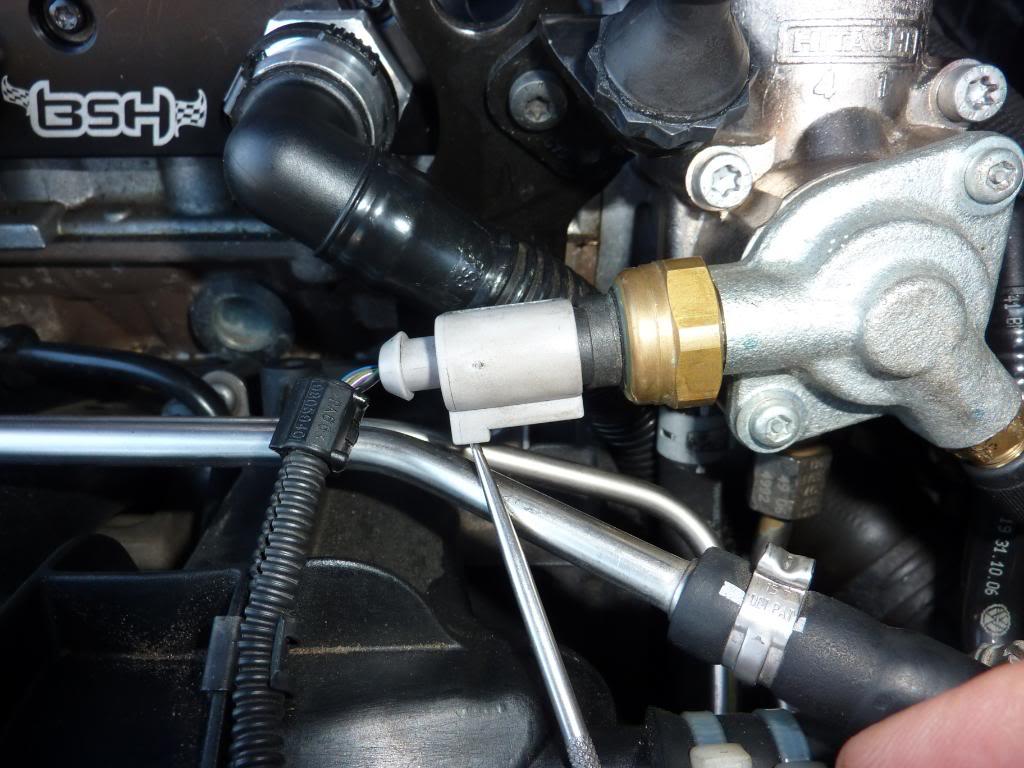

Firstly disconnect the 2 electrical connectors.

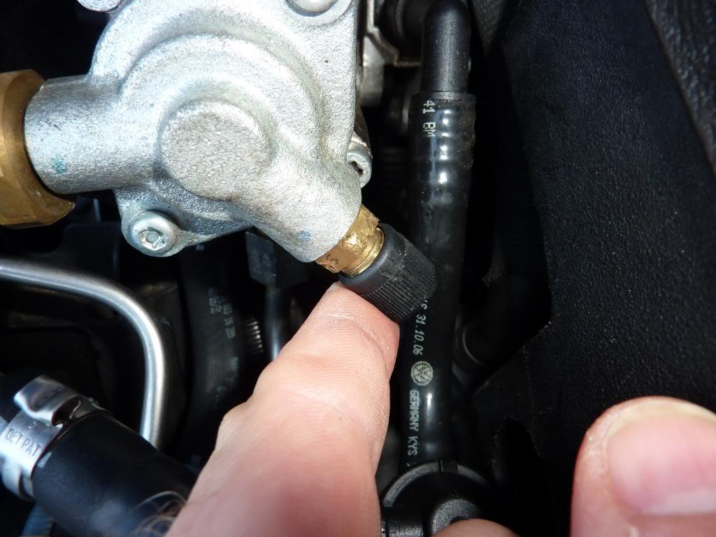

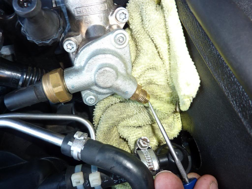

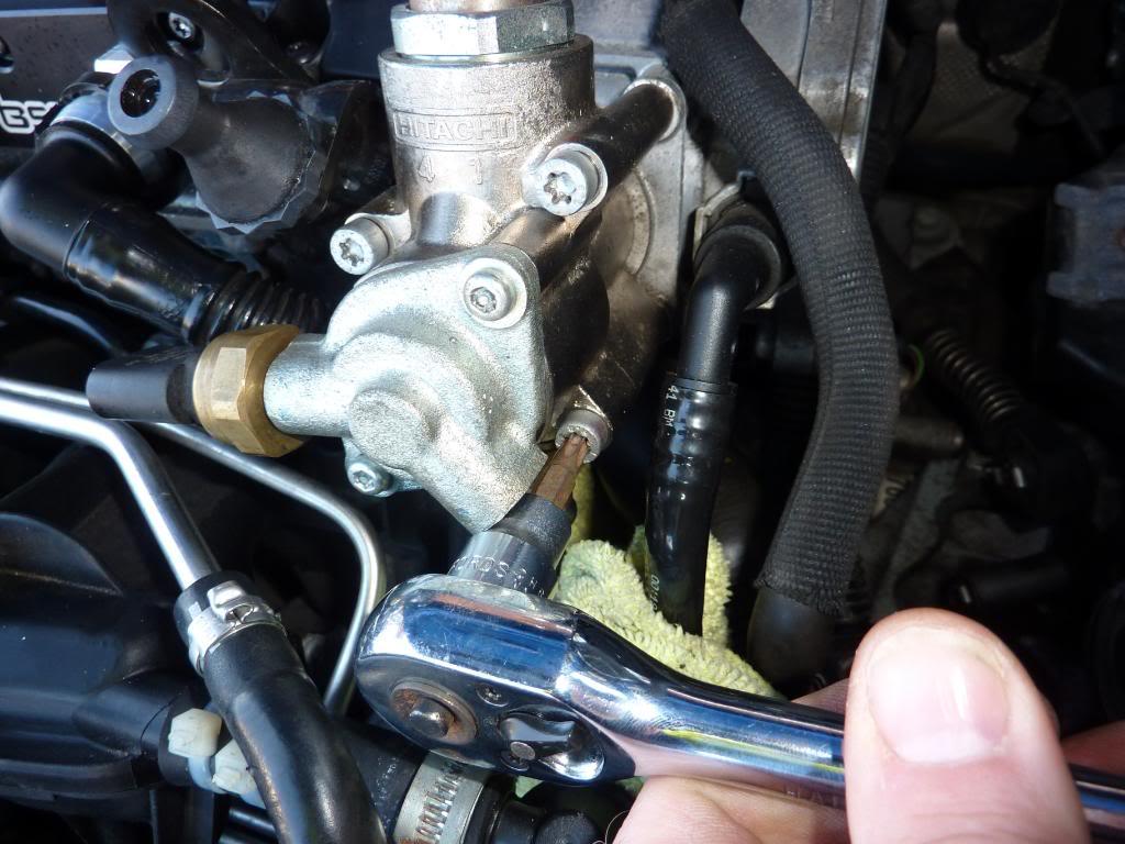

The next thing to do is to let out any excess fuel in the pump. On the lower right hand side their is a pressure valve. Remove the black dust cap then using a screwdriver or allen key press in the valve (same as on a tyre) and hold in till all fuel is released. Ensure you place a cloth underneath to catch the excess.

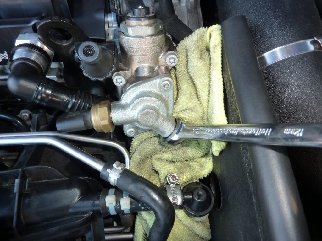

Once you have done that using a 13mm Ratchet spanner/Ring spanner. Remove this valve ensuring you leave the cloth underneath as a bit more fuel will leak out. You have to remove this valve to get at the bottom bolt on the pump.

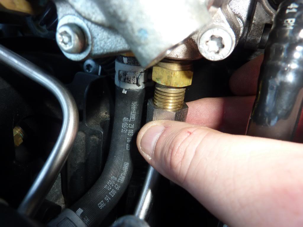

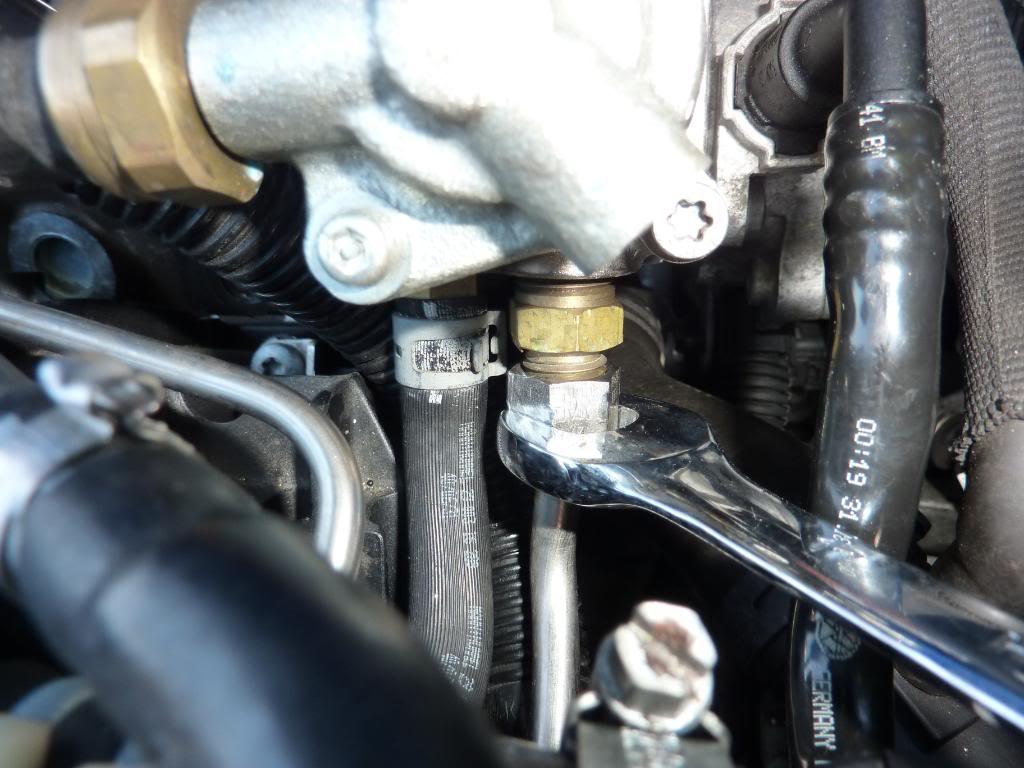

Now depending on how old your car is you will either have 2 metal pipes or 1 metal 1 rubber pipe at the bottom of the pump. Mine has 1 metal 1 rubber so the process is quite easy. I am assuming (but haven't seen the other fitting) that the 2 metal pipes are held in by the same size nut. Any way take a 17mm open end spanner and undo the nut all the way till it falls down the metal pipe. Again make sure cloth is underneath to catch any excess fuel.

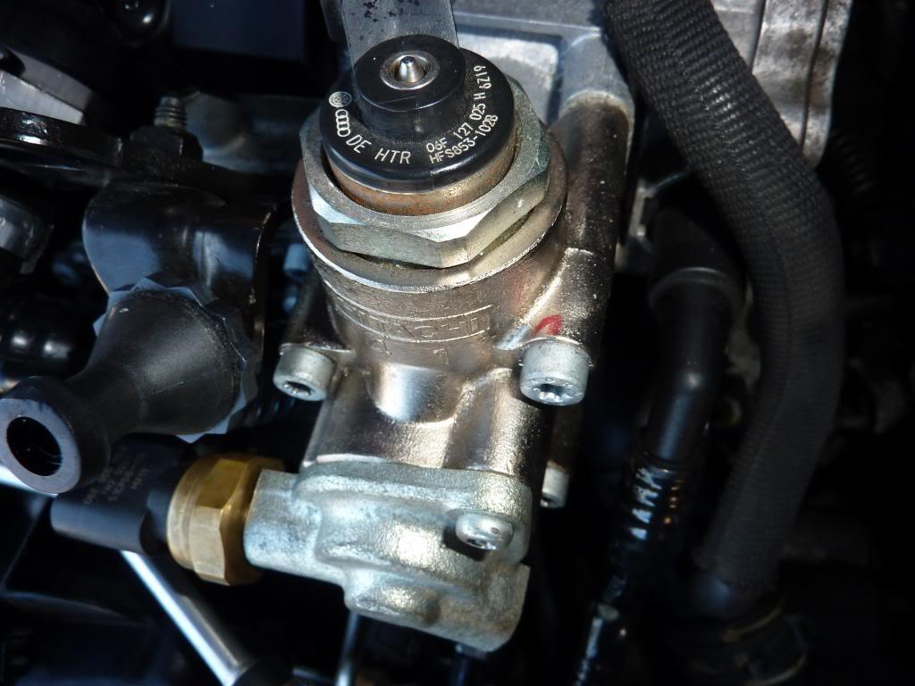

Once this is done you are now ready to tackle removing the pump. The pump is held in by 3 x T30 Torx bolts. Undo these bolts and remove. The pump will now come away from the engine.

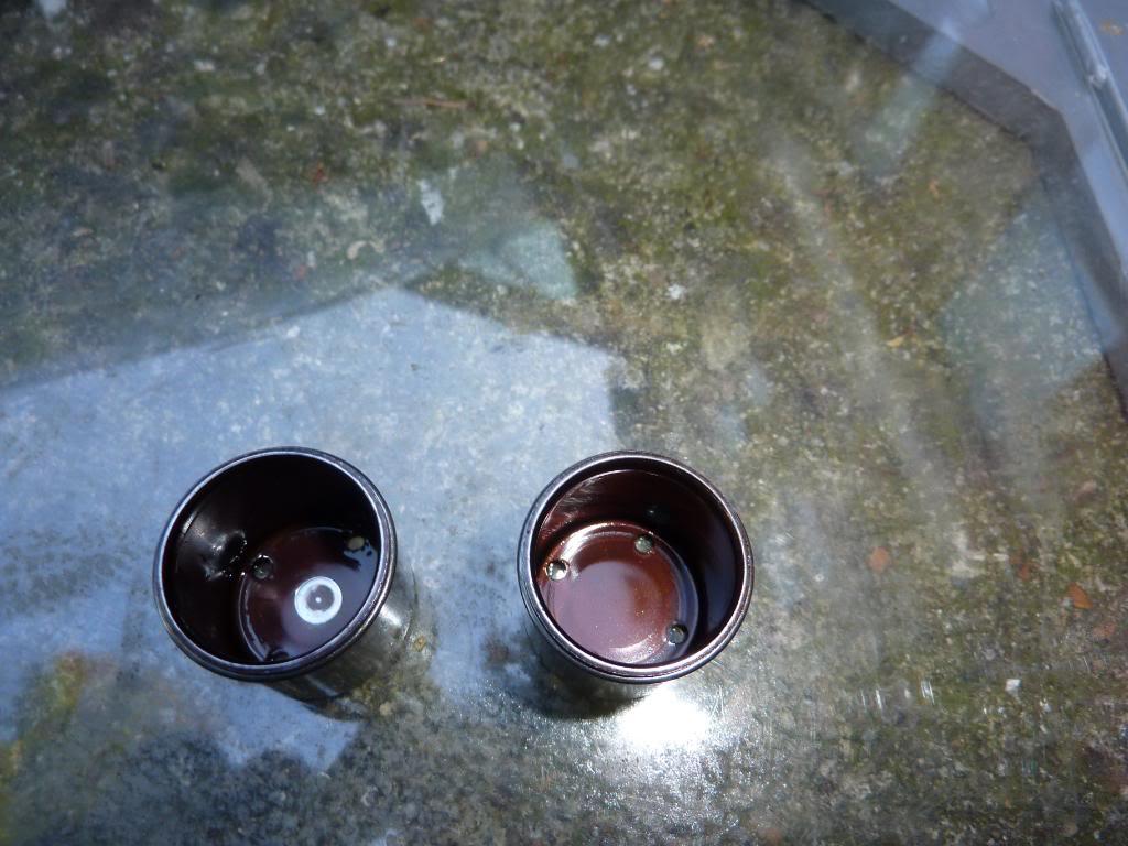

Inside you will see the cam follower. Using your little finger just pull it out. Check for signs of wear. This one has covered 14 k miles since it was last changed but i don't think that wear is too excessive.
Take a new cam follower and place into the hole you took the old one from. There is no need to coat it in oil/fuel etc as it comes already coated in the little pot it is delivered in.

Firstly line up pump and push up against engine so it is flush. Then by hand only tighten the 3 x T30 Torx bolts. This ensures the bolts don't cross thread etc. Once your happy the bolts are as tight as you can do it with your fingers and they are not cross threaded then using your T30 Torx bit tighten up the bolts. DO NOT OVER TIGHTEN. Basically do these hand tight using a ratchet. But DO NOT apply to much force. If you knacker the thread holding the pump in it's gonna become expensive.
Once they are done then reconnect the metal pipe at the bottom using hands first so no cross threading then the 17mm spanner. Note the nut does not go all the way to the top.

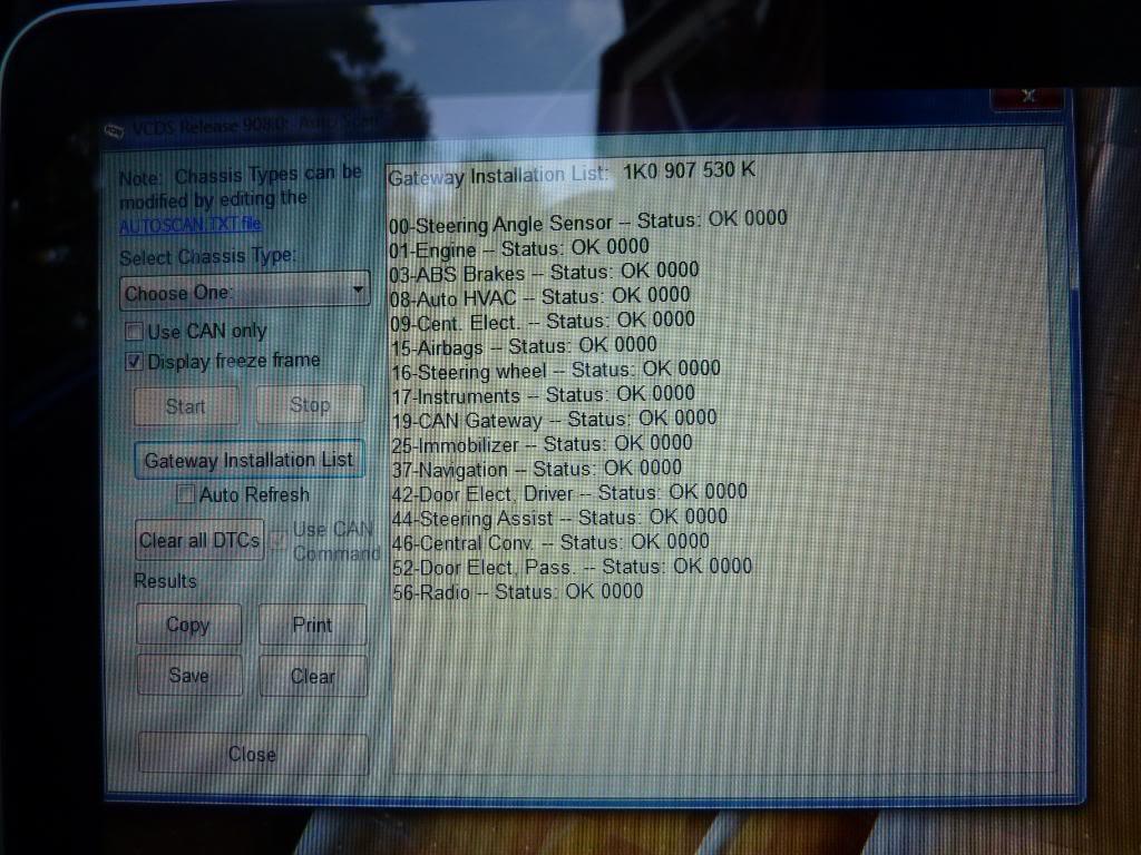

If you have VCDS check no faults and Voila all done.

Yup i had to use a hammer and Socket at one point. Basically whichever cowboy :surprised: :innocent: it was that installed the Autotech internals put it back on too tight and when it came to undoing it the edges of it just rounded  :fighting:. So now mine takes an 11mm Socket not a 13mm ratchet but for everyone else they need a 13mm one  :signLOL:
