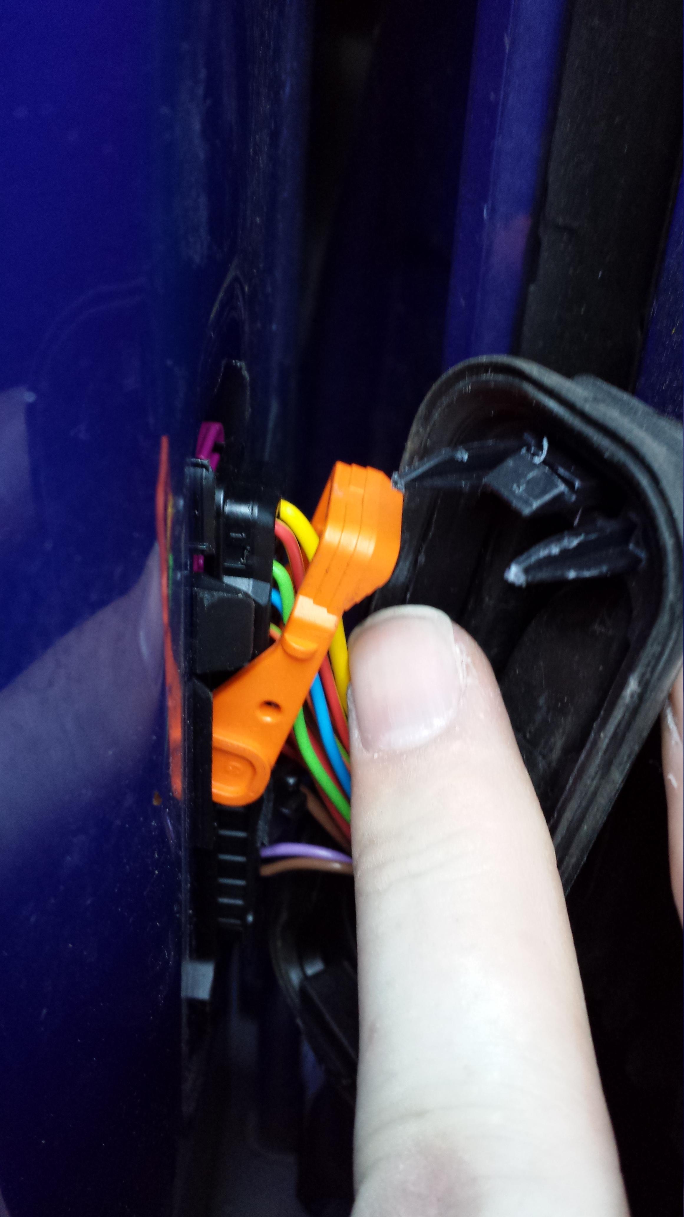

Cheers for the replies, how do you release the connector that the door wiring plug locates into? Lower A pillar(car side)
Its the one where the 000 979 020 male pins go into pin location 2+3.
I've made up wires already for both area's mentioned previously. Don't suppose you have any tips or advice on stuff that breaks or will prob need to be careful removing?

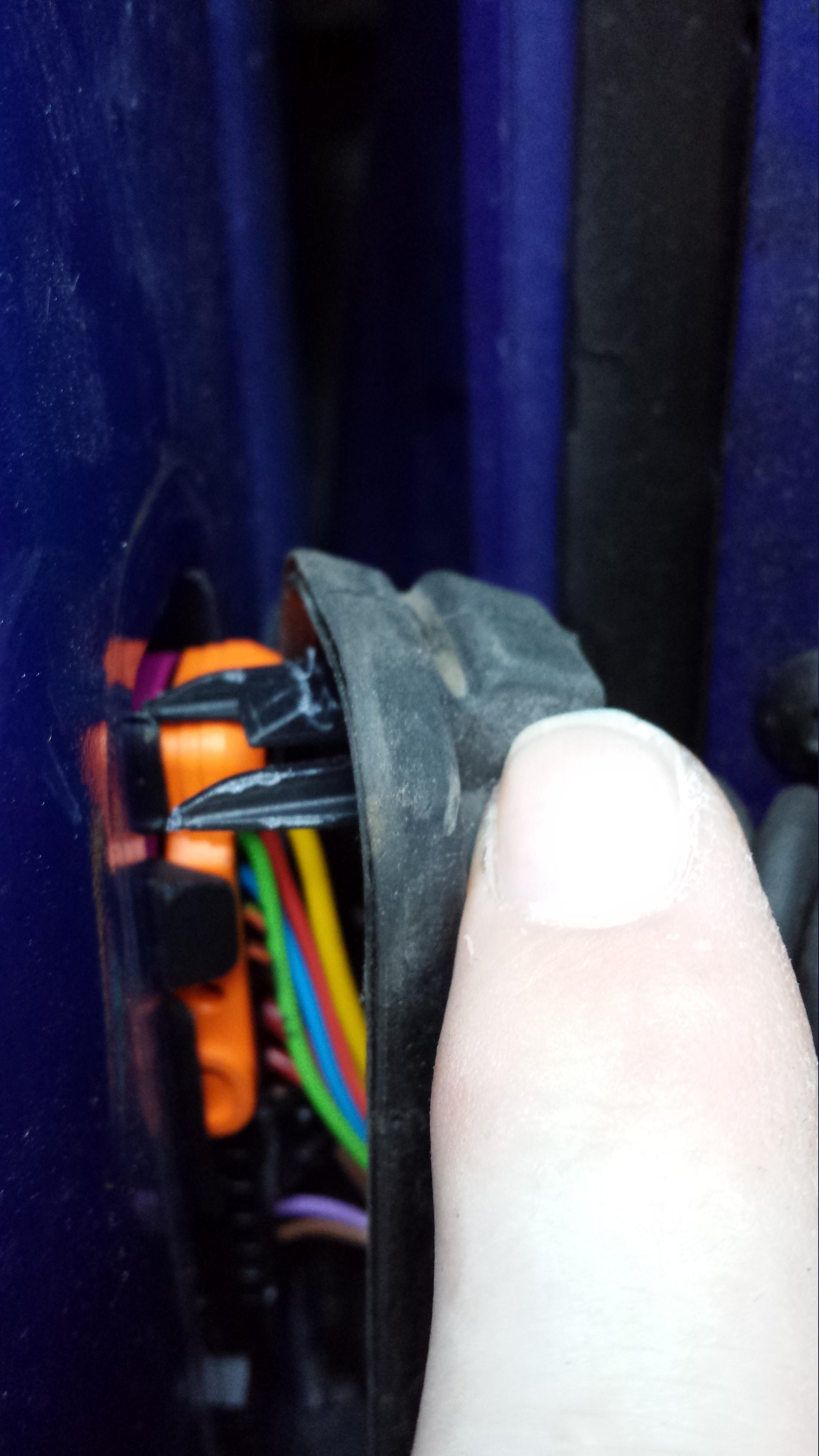

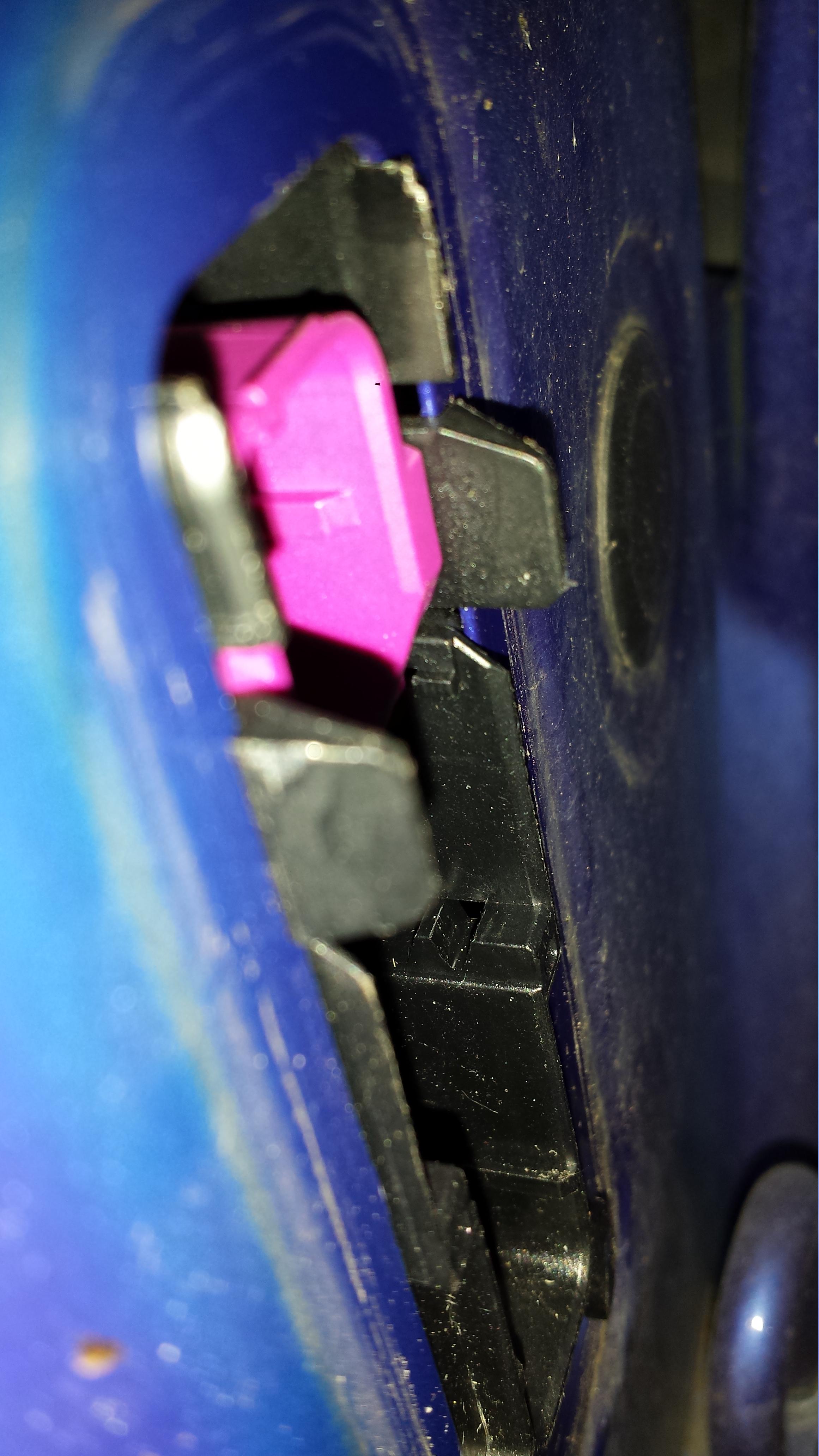

« Reply #5 on: May 18, 2014, 04:34:27 pm »
pull this rubber notch up here
this releases this clip inside here, then pull back gently
pull down on the orange lever, this will pull the plug from the door
then you need to remove the trim inside the car to get to the back of the socket, look this up on line
then push these 2 clips together and it will fall back inside the car for you to work on, fyi getting it back in can be a bitch if you don't have nimble hands, but perservre.
hope this helps
