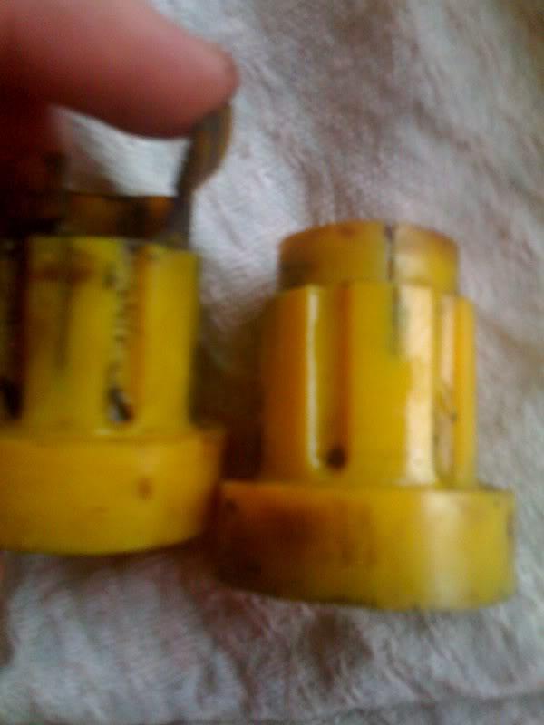

mine had lots of the grease in there  :confused:
What - between the inner and outer yellow bits?  You need to dis-assemble them from how they are supplied to get much more grease in them.  I'm guessing that on yours, only the metal hex end of the TCA was greased.  How many miles did yours do before they let go?

Re: whiteline (WALK) failure...
« Reply #19 on: October 20, 2009, 02:18:11 pm »
cleaned all the crud and grease off my old ones so u can see the split
« Reply #20 on: October 20, 2009, 02:23:47 pm »
Hmmm . . . that doesn't actually look like a 'failure' - because the main 'body' of the bush is still perfect.  Or have I missed sommat?
« Reply #22 on: October 20, 2009, 02:25:40 pm »
the one on the left the end split and the one on the right split down the middle oh and this is the inner bush
« Reply #24 on: October 20, 2009, 03:06:00 pm »
Ahhhhh - I see the split in the right one.
Maybe your next mod ought to be a  . . . . . better camera! <ducks for cover>  :evilgrin:
Where?  :chicken:
« Reply #25 on: October 20, 2009, 03:08:56 pm »
its a 2 bush item ie one big outer bush and a smaller one inside and the pic was just a quick one and if u like i will take them to a better location and get the tripod out and use my better cam  :P
