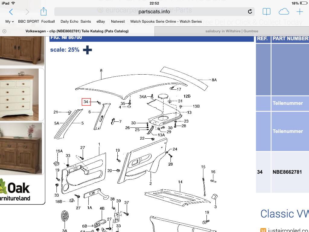

Right then wise ones, when removing the b pillar trim (undoing the Torx screw behind the airbag logo)  I though to myself, I best keep that safe.............
Upon re-installation of said trim I lost the screw down inside the other trims etc and I can't find it anywhere.
Does anyone know what size etc this screw is or what I can use instead? I've added a pic if people are unsure

Can find loads of threads and diagrams online about it but none give the size of the thread of the bolt just the size of the torx fitting required  :rolleye:
Maybe unscrew the other side and be careful his time lol

M5 x 16, check VW part number N104 301 03
