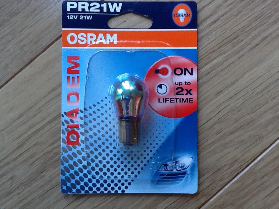

Thanks for that. Would it be possible to use 2 clear inners to balance the back out a bit, use a silvertec red bulb?

^^^^ Just remove the red inner reflector from one side and the clear reflector fron the other side, will be fine. Just get the bulb I've linked too below. Info From a post I did a while back.......

No extra caps (assuming your talking about the internal plastic reflector covers) are needed. Either swap or remove just one. If removing just one then replace the current bulb with one of these OSRAM Diadem bulbs (not cheap though).....
