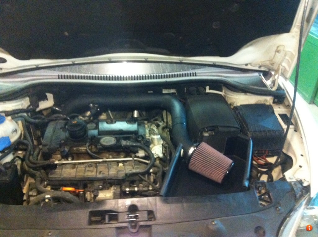

Pic of the filter fitted

Hi mate
Pritty much all aftermarket open filter intakes makes the sucking/whistling noise mate.
To be honest there's nothing you can about it unless you go back to oem with panel filter or try an enclosed canister intake to minimise intake noise.

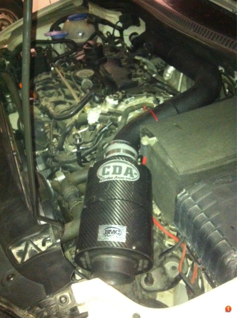

The noise is still there even when I changed the open cone filter that came with the kit.
I fitted a enclosed carbon bmc box, and the whistle is even louder.

« Reply #13 on: May 20, 2014, 10:58:27 pm »
I had the same on my FR with the BSH kit - you won't get rid of it until you change your intake.
I made my own intake with bigger diameter pipework and the noise is non-existent
