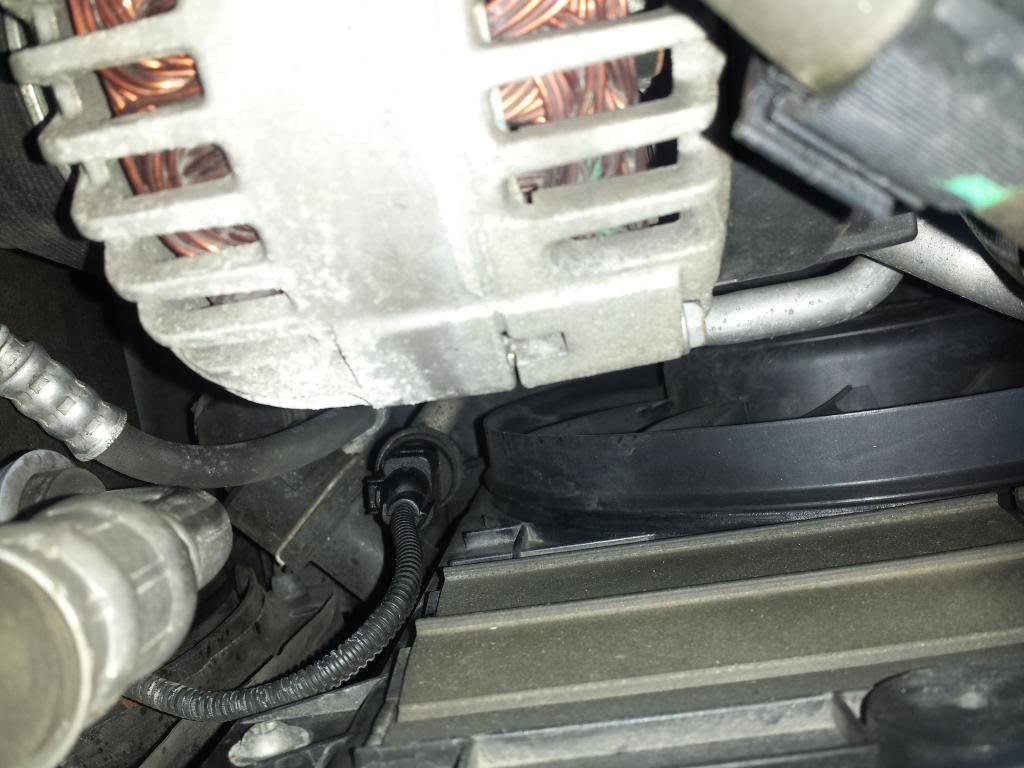

Check around the pressure switch as it could leak through hear and you'd probably hear a hissing noise

I checked something, might be the pressure switch you mentioned, heres a pic below
that bit with the wire covered in black?
I touched it (  :signLOL: :evilgrin: ) and almost immediately the hissing started and little farty sounds like pfrtt hisss   :signLOL: :signLOL: seems like its not secured IMO or something like a washer or seal is worn, or even the electrical bit that's coming from the top maybe that's got something to do with it? this is fun poking around the car  :smiley:
