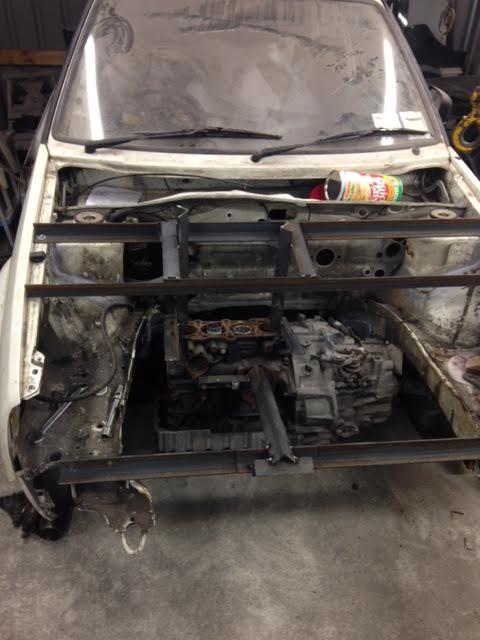

Stripped the car of all the dash and interior bits n pieces.
Bought another Agu engine as the one I had was missing one or two small bits.
Finally I feel like Im getting my a55 in gear now with regards to it!!!!

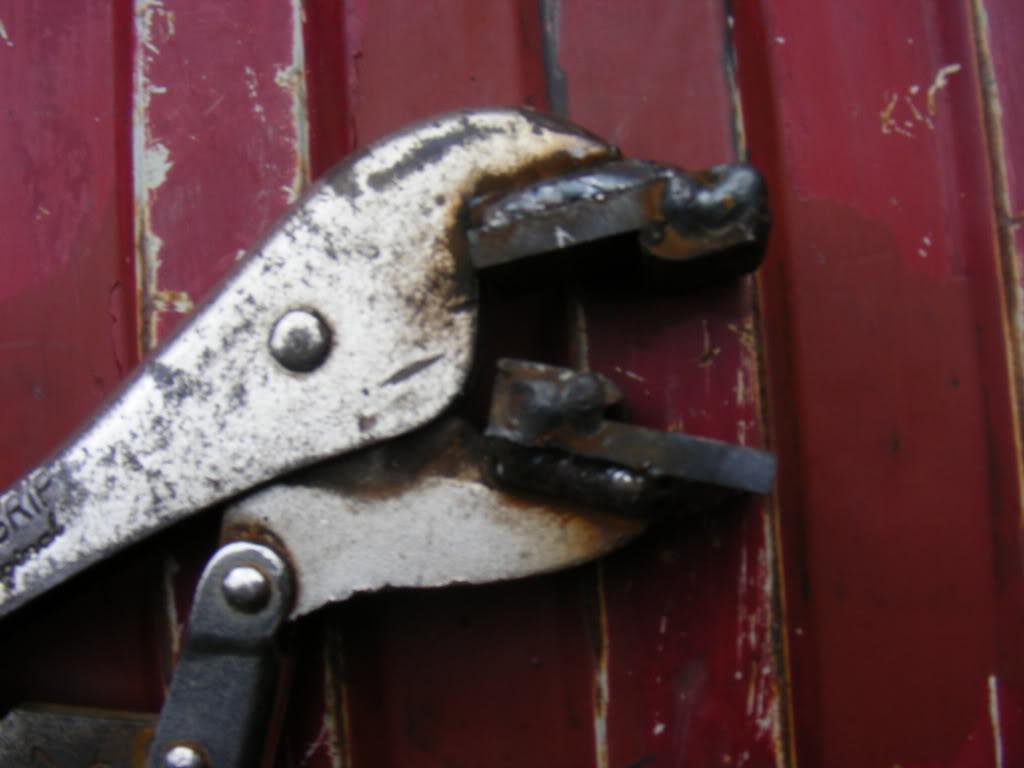

The immediate problem arose of, with the floor panel beat flat, the floor gap to the tunnels flanges was 'large'... for awhile I was stumped TBH.... I had researced all of the 3 online forum documentaries of this type conversion -only one (on vw vortex -building/converting a 4 door golf to a 4x4 'Golf country' high rise creation) documented this process - it seems he 'overcame' this problem by filling the floor with house blocks n bricks till the floor did meet the syncro tunnel and welded the edges in a 'blaze of glory' - hardly ideal - my prefrence, and proberley Marks aswell is a more factory/original syncro finish...
...Long story short I ended up with a solution of a welding up a 'joddler' type tool out of; a 'good' vise grips (sacrificed for the cause!) 6mm plate cuts welded together, 30mm 'wide' with 40mm throat;
The steps were linished down to give a 'curved step' shape as per the factory syncro floor...
...it worked brilliantly, albeit very slowly, and leaving me with a 'stigmata' like hole in my right hand from clamping it down;

...aye I knew they available alright; had one years ago; it fell to bits - I made this one up outta 6mm plate to give the 6mm 'step' - the usual Joddler tools only give a 1mm step...
I have another vise grips that I made into a '1mm joddler' years back, but it sits about and has 'gone stiff' - if at all possible I prefer the 'butt welds', time consuming and 'warpage risking' that the are... overlapped seams are notorious for rust...

Trial fitting!

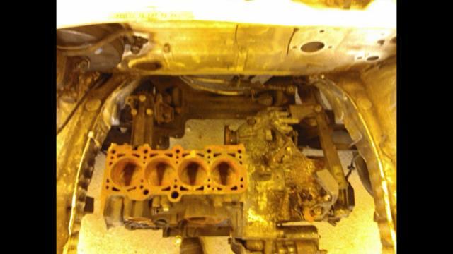

Here are some photos to update whats going on with the car.
So the engine thats in now is just in for a guide / reference on how the TFSI should sit once bolted in.
