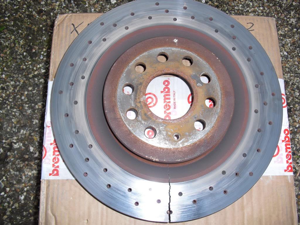

After experiencing 2 years of overheating brake problems I have discovered the problem is with the stability control.
I have cracked two sets of Brembo discs from the Gran Turismo upgrade kit ( now have 2 piece brake discs full floating with AP rotors ) and gone through more pads than you would believe to finally discover there is a stability control devise working even when traction control is turned off. At my last track day ( Brands GP ) after about six laps the brakes were overheated so I pulled two fuses out which shut this down and the brakes from then on were fine for the rest of the day. Does anyone know how this can be turned off in isolation as when fuses are removed other items are turned off such as speed related power steering control ABS etc along with lots of warning lights showing.

There seems to be quite a bit of bluing on those they've got hot and then cold very quickly for that kind of metal fatigue to manifest itself. Purely from a curiosity point of view did the crack appear after the disc had cooled or in operation
Your GT calipers, are they the ones with the internal connecting pipe or do you have a pipe under your caliper.
If you have the newer design then it is possible that you have corrosion behind the pad slide plate, its caused by differential cooling between the caliper and the steel screwed in slide plate which the edge of the pad slides down.  The problem is a build up of dust and probably pad material behind the slide plate, this aint a problem in itself until it starts to corrode the ali caliper and the steel "bulges" preventing the pad from withdrawing. Its amazing how much force corrosion can generate.
Only thing is a full rebuild really, alternatively it could be a sticky piston - in either case it wont do any harm to strip down the caliper remove the corrosion, etch and re powder coat the calipers. If you do have a sticky piston then they are easily replaced from Porsche dealers about £25

When using Brembo drilled discs the holes drilled will ultimately cause cracking/weakening of the disc. Porsche use forged items hence they cost more but are resistant to track use. Slotted AP's should be good but track work will be equally cruel to big brake fits.I've been down this road before.
I think on a budget the OE discs possibly with a Cupra set using OE rotors will be cost effective with good high heat pads such as Pagid/Ferrodo/EBC etc and good fluid.
