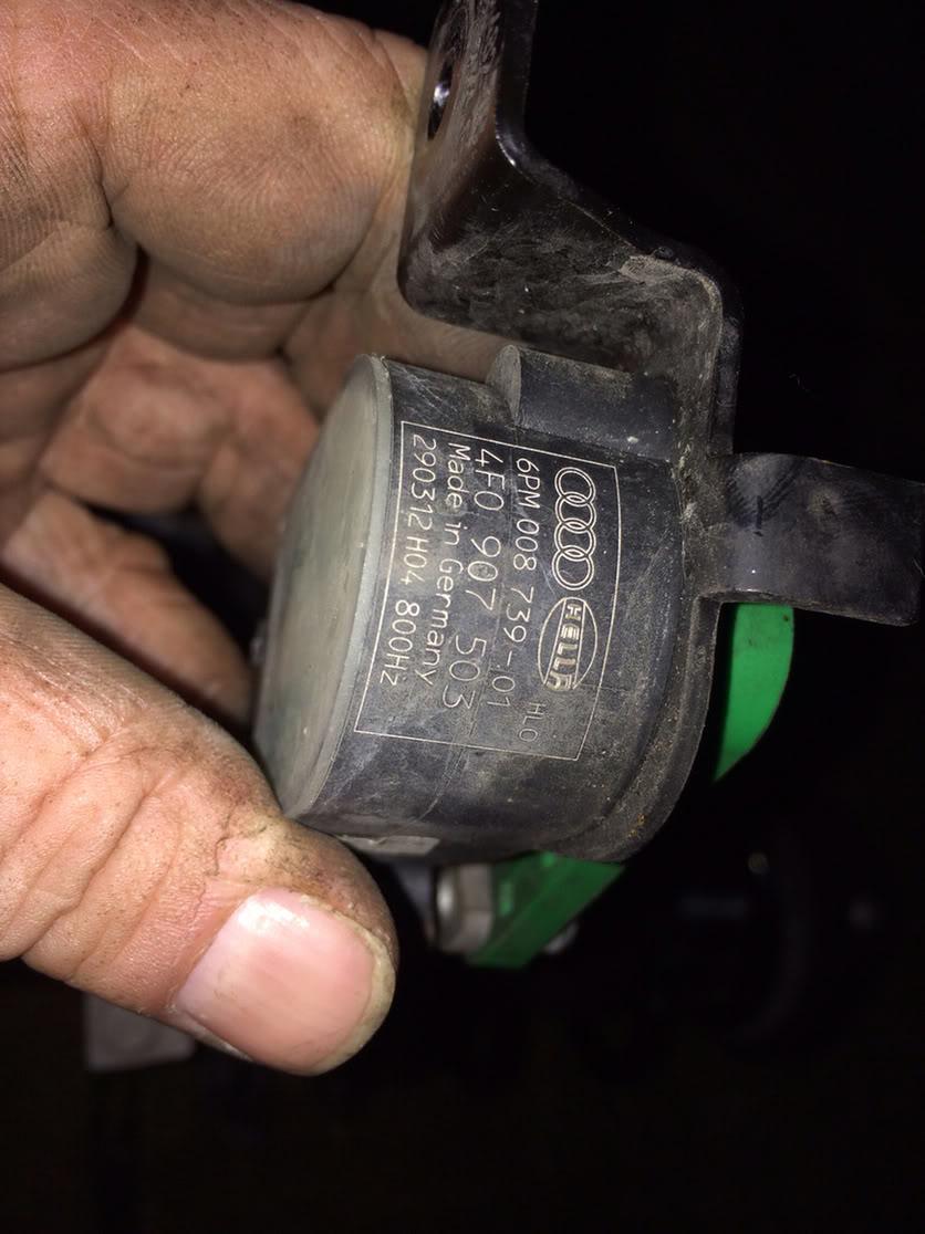

Ive got the height sensors and arms got a pic some where, standby 1
Found it, from a 2012 TTRS
« Last Edit: July 02, 2014, 12:05:16 am by DaveB1970 »
Are you selling the parts Dave???  :laugh:

They're sat here doing nothing mate so yes PM me an offer I'm not greedy.
