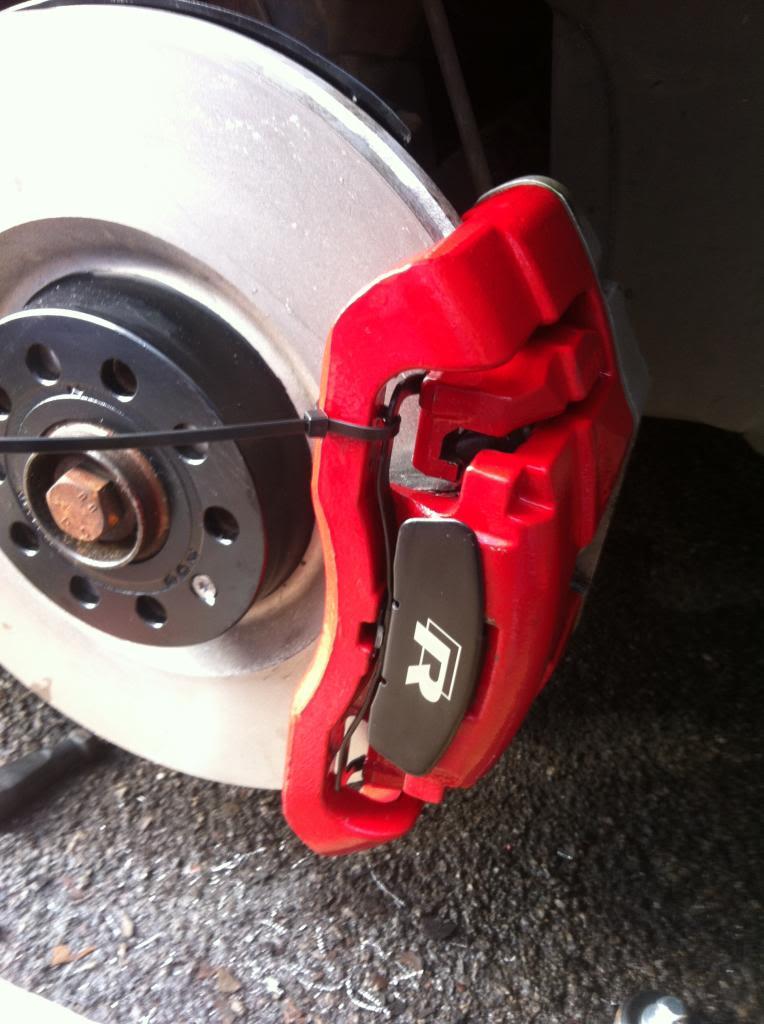

Done...
Cable ties are magic!!!

Got a couple small ones when removing the old clips... Cable tie the lower arm tight then put a tie on the upper arm and pull that as far as it can go. Then put another tie on the upper arm and while pulling that tight push the centre inward and it should just pop in place.
Touch up and scuffs and off you go!
