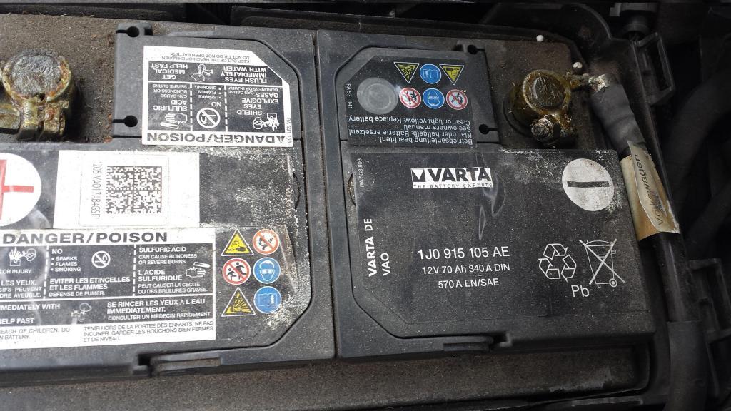

After helping to sort my sister with sister with a new battery, my attention is focusing on my ED30.
My battery is the OEM Varta Battery fitted from the factory so is now 7 years old:

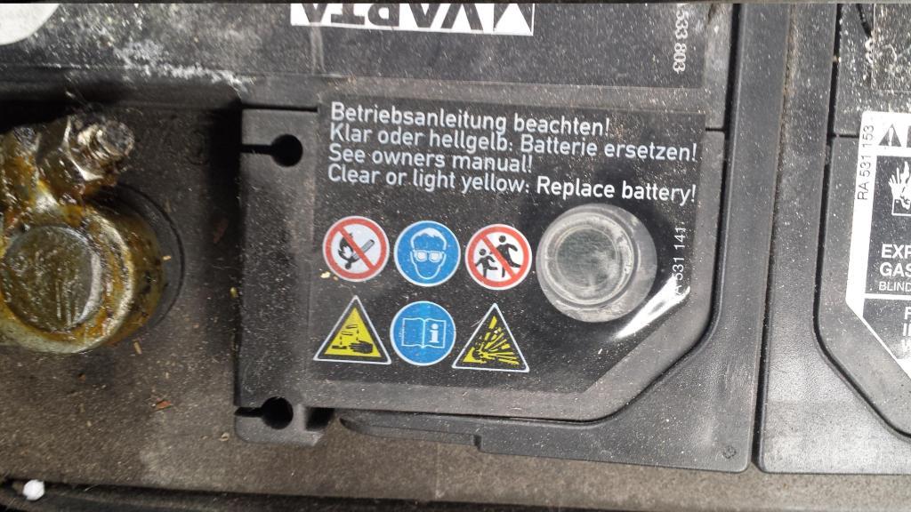

Ive noticed that it takes a couple of turns before it fires up when starting. Coupled with the fact that the little inspection window looks clear which according to the manual means its time to replace the battery:
You reckon its best change the battery now due to its age and condition?
Im thinking about changing to the Bosch S5 007 battery which a few members already have.
Thanks

btw the inspection eye goes colourless even in an ok battery around 4 years of age.

In the market for a new battery for my mk5 fsi 2007... looking at the op's pic, my current varta is probably the original?
Does anyone know the oem code out of interest? I've got my eye on a Bosch S5005. Slightly shorter in length than what's in there now but that's not a problem is it?
Thanks.
