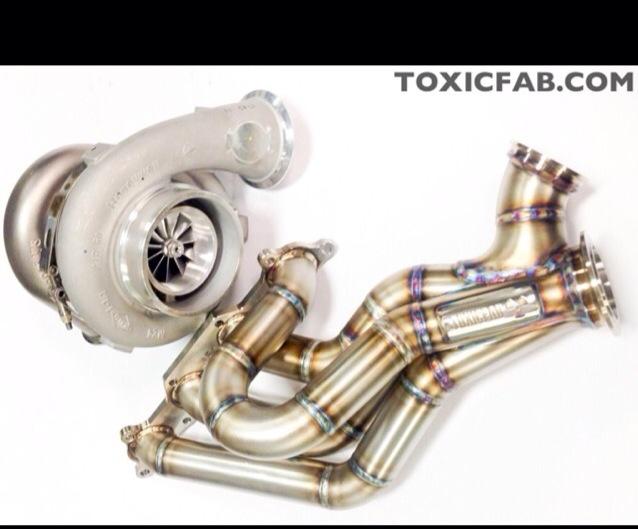

I shall flick them an email :)
Something similar to this but a mirror image...
Looks very good,is there enough space to fit inside the mk5 engine bay?

Re: Front facing Evo turbo...
« Reply #10 on: July 07, 2014, 01:25:48 pm »
I think those long manifolds look a right mess if I am being honest.  :sick:

Each to there own but the craftsmanship that goes into a good manifold can't be denied!
