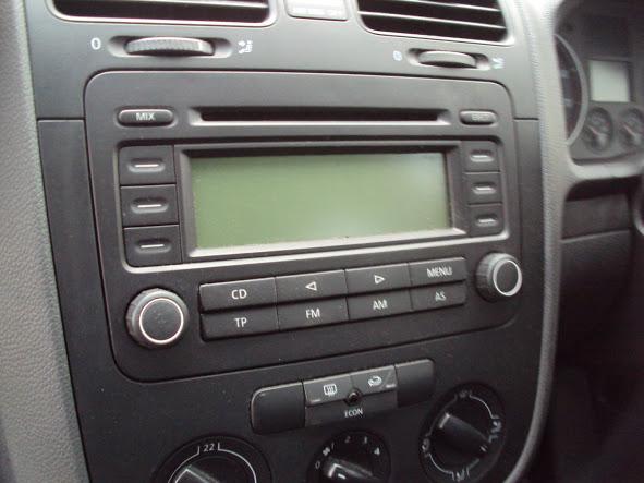

I feel if I leave my car over night it has a slow turn over in the morning I know I've read about certain car stereos giving battery drain will the stereo I have do this just trying to rule out options!
This isn't my car just copied another pic of same stereo
i guess only the retrofitted rcd510 rns510 will couse battery drain  :confused: :confused:

As above, that radio shouldn't cause battery drain.
