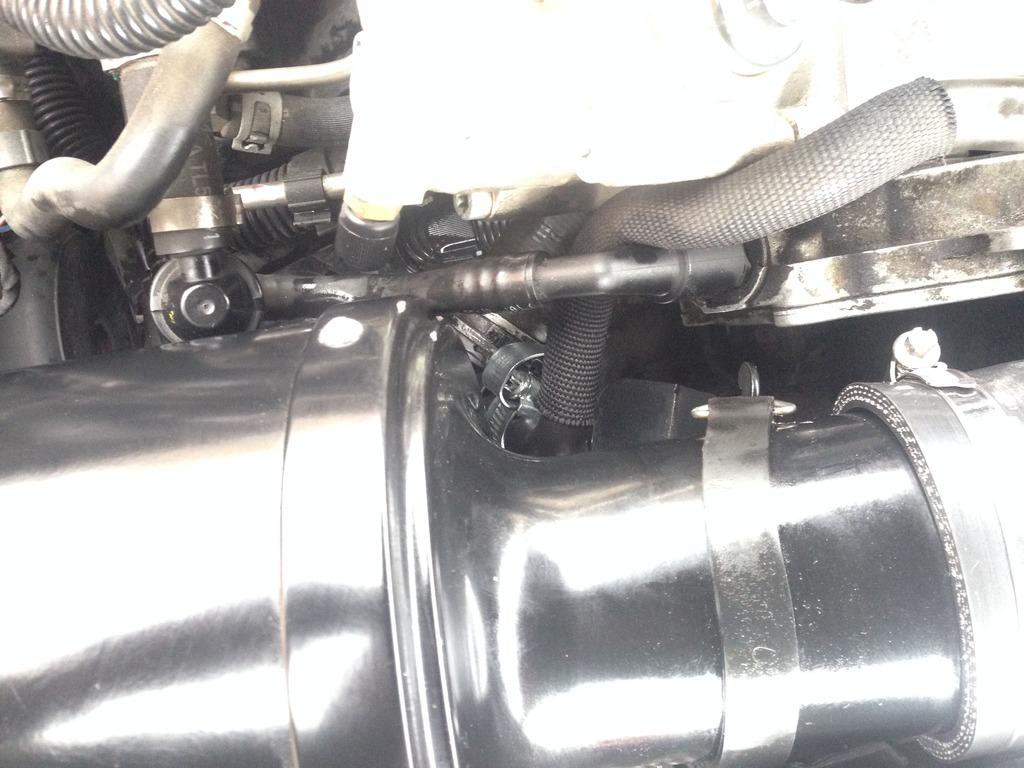

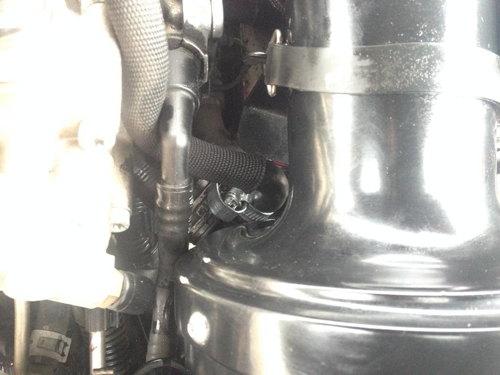

So installed mine at the weekend and had tye same issue with the coolant pipi in the way. Also the grille attachment for mine was for an audi so made it more complicated.
Basically I remove all 4 pipes off the coolant t piece and then reposition so the nozzle was more down to the right but not by much. Fitted hoses back on and then the intake sat just above it. It is slightly touch the fat pipe coming from the radiator but not putting pressure on and intake quite solid so does not move much.
I love the sound of it, very quiet but can hear slightly when boosting it. When have more time I am going to look at trying to fully reposition the coolant t piece as ideally still do not want it sitting under the intake.
I dont get a whistling at all so must be something loose I can only think of
Will try and post pics up so you can see.

Basically I removed the clamps and twisted the pipes off, need to be careful with the thin pipe that goes down by the DV as it spits coolant out so just loosen the pip to twist rather than removing.
Here it is on mine, as you can see not ideal as pipe for the nozzle I have tucked behind another pipe. Also the nozzle is a bit bent down enough so does not touch the intake but ideally I want to try and relocate it. I have the Audi grille attachment on mine but the way I have fitted it, it is solid and does not move.

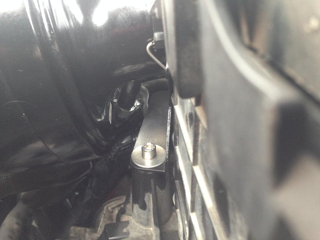

So, mine is sorted. Some shims on the mounting bracket, plus a new hose & all is good.
The filter is no longer resting on coolant hoses - it is still snug, but not pressing on things. I should have checked when it was fitted, but I didn't expect to need to!

Hi shoaybmakda, hi Pudding - yes, that's right - looks to be 3 or 4 washers that the garage fitted.

That's a good idea.  A more flexible coupling would allow the canister to kick up more and clear the hoses/N80 pipe etc.  A short, straight piece of silicon has virtually no flex.
