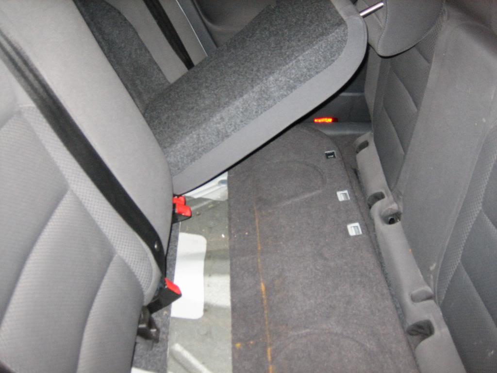

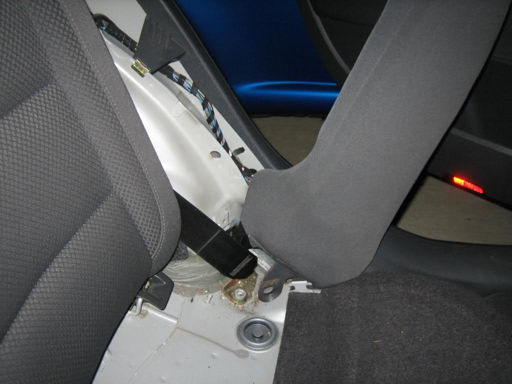

Remove rear seat bench:
Pull off seat side cushion, upwards and outwards. Undo Bolt at base for side trim:

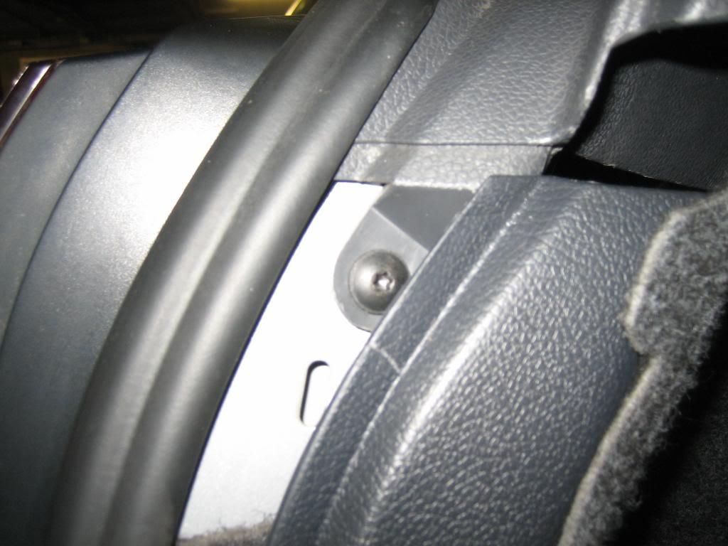

Undo torx bolt at top of boot side trim:
Undo torx bolt at hatch side of boot side trim (I just pulled the boot lip trim aside to access rather than fully remove as I'm lazy :) ):

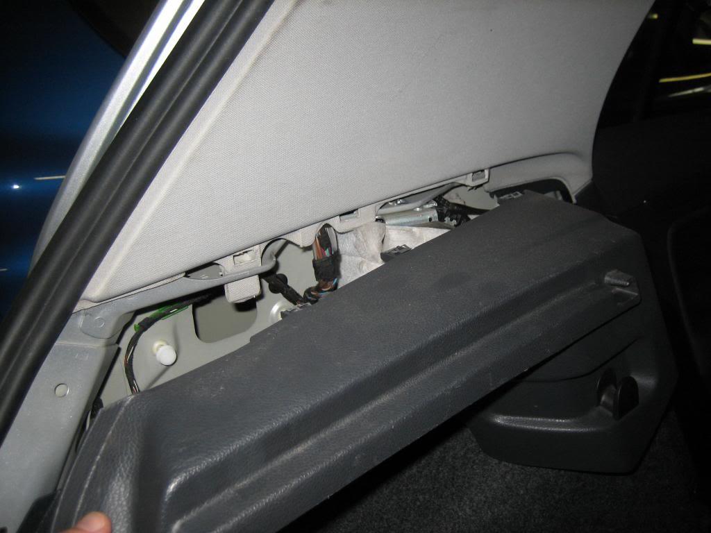

Remove boot side trim:

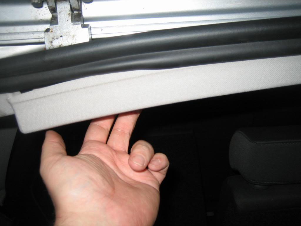

Pull down rear liner edge trim:

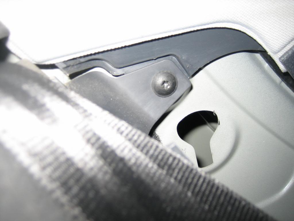

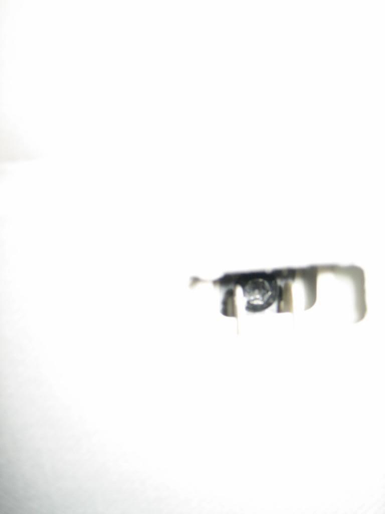

Undo C-Pillar trim bolt:

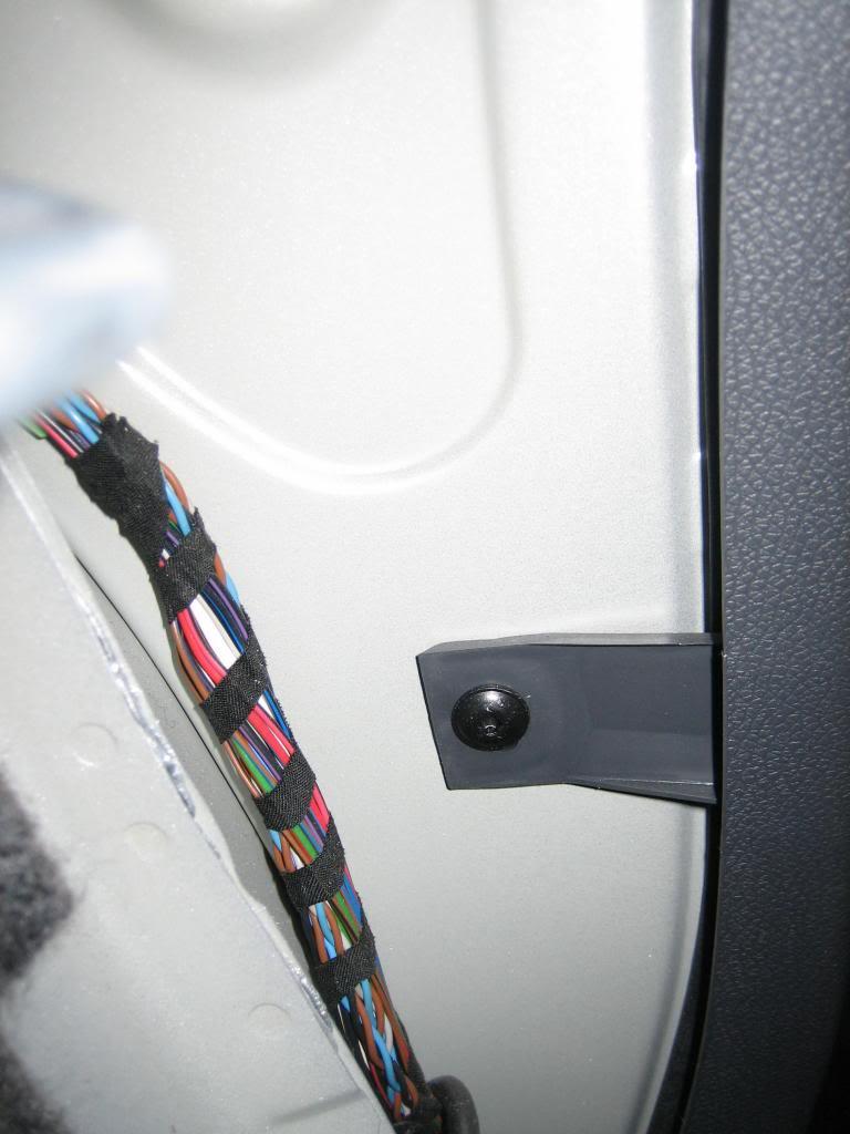

Undo rear side sill trim torx and remove trim:
Remove Airbag emblem and undo torx bolt:

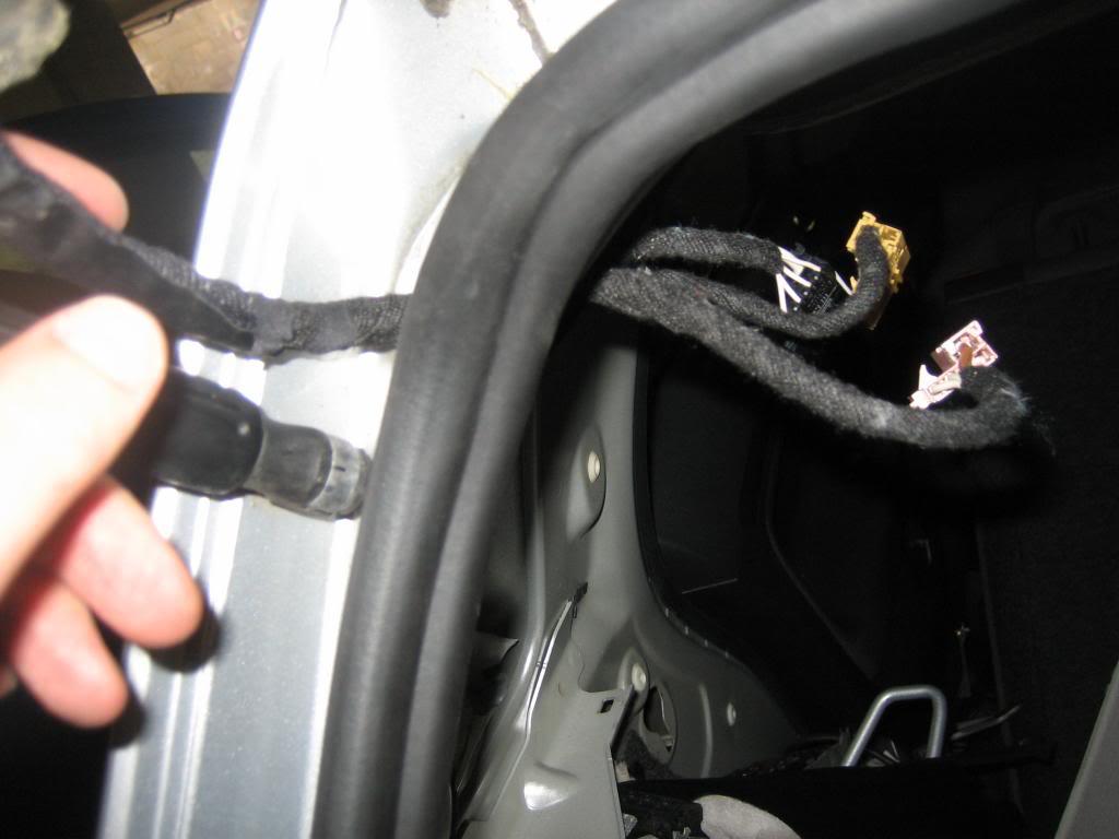

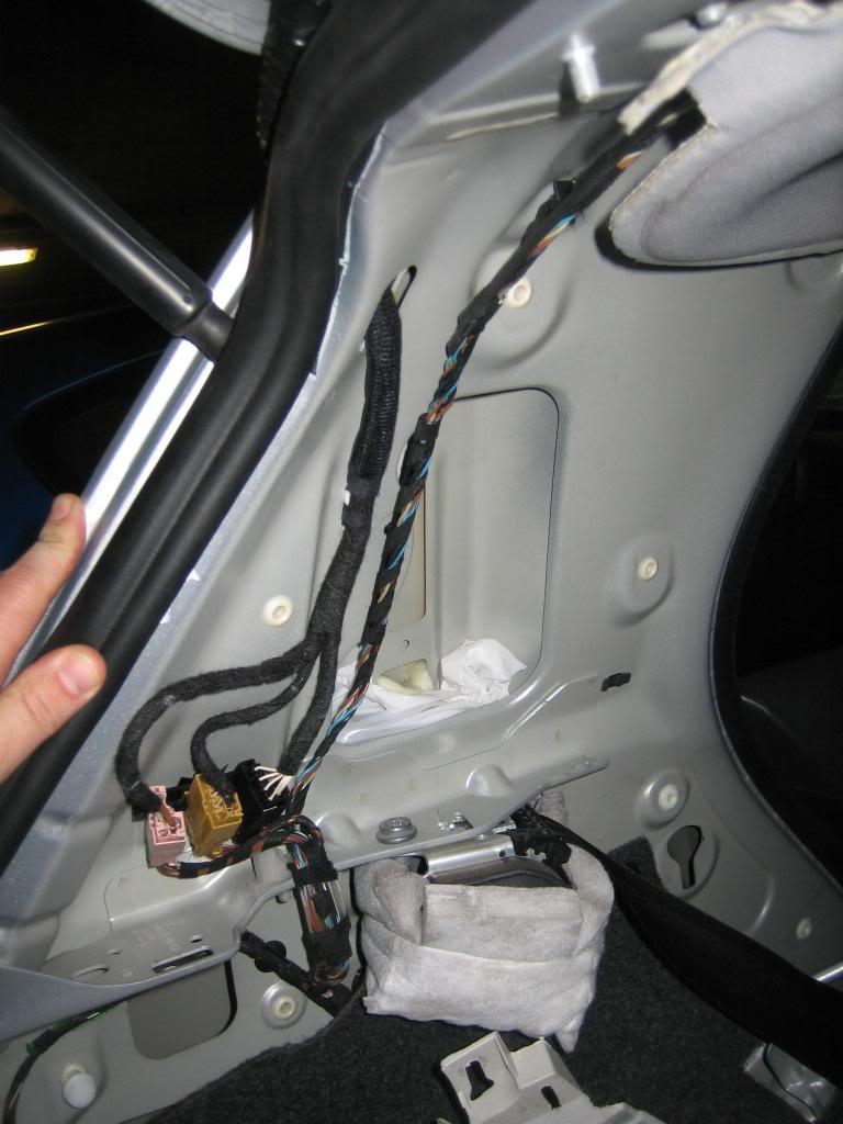

Remove C-Pillar trim and unplug the three old connectors from the harness:

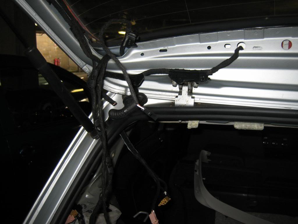

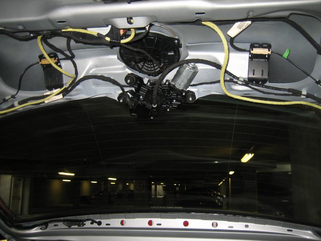

Thread the old harness back through the tailgate. I cut the old cable to the high level brake light at this point as I hadn't worked out how to remove it. I later worked out you could carefully pop out the brake light with a penknife in the end and disconnect that way:
Remove inner boot trim (two screws recessed in inner grab handles and then just pull, there are 4 clips along top, 4 at the bottom and two at the sides) Also just pull and remove inner rear window trim and then you should have access to everything:
To avoid confusion I cut the old loom at the hatch side and threaded the new one through to the body. I then only removed the old wiring as I had connected up the replacement as its a long loom with various plugs/connectors. Push the high level brake light cable back in through the hatch and connect up and carefully push light back in.
