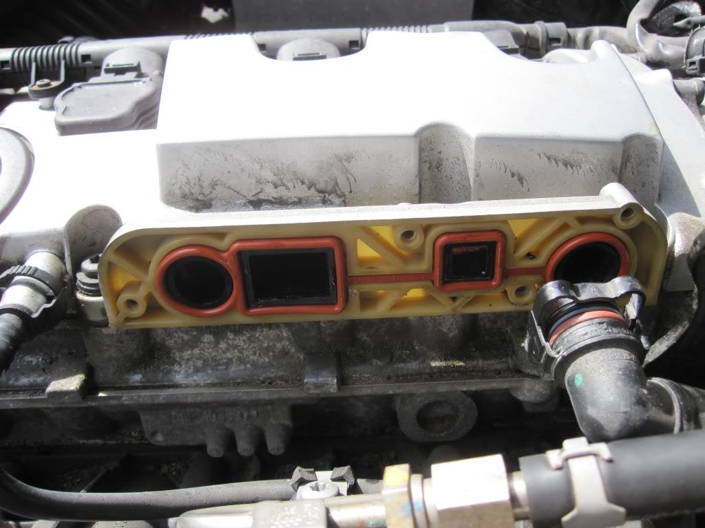

Not absolutely necessary but I would suggest you also change the pcv gasket (orange coloured) before installing the pcv delete.
Part number 06F103483E
