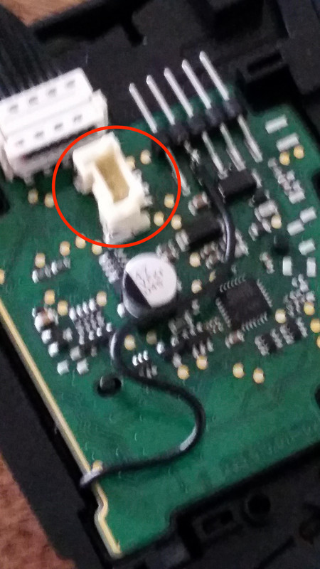

Hi everyone.
I'm in the same situation. Did this mod, only left side illuminate.
I think we need add a wire between left and right side, but any idea where ?
Don't know if this help but in my configuration, the plug circled in red in the photo aren't plug anywhere. There is only a 5 or 6 wires loom between left and right side.
Thanks a lot !

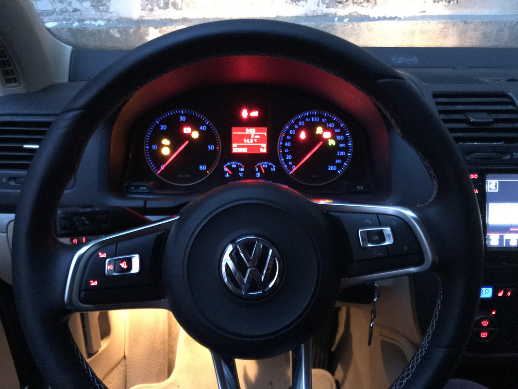

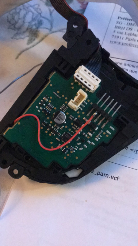

To everyone struggling with only one side that illuminates, I think I've got a fix !
You need to solder another little wire between 2 points. Not easy to explain, photos will speak better.
I already done the mod from @SI-R32 (thanks a lot to you) but as many of you, I got only one side that illuminate.
Do some tests and referring to a photo of another wiring, I found a way to illuminate both sides.
And lights goes on ! Both sides !
Hope it helps some of you.
Cheers  :drinking:
