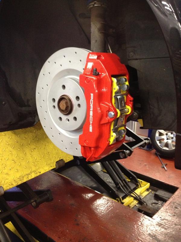

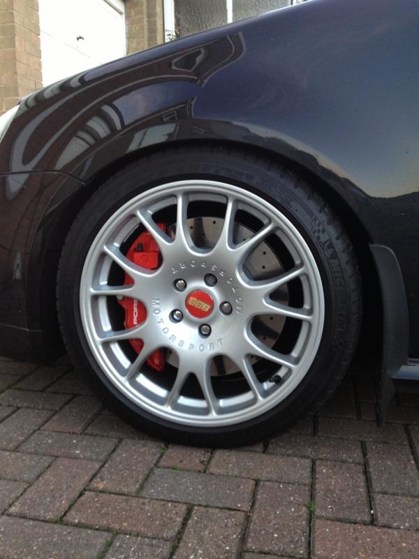

18z brembos work perfectly fine on my ed30 mate, pedal feels good and works fine with std master cylinder. I used caddy 2k rear calipers but would work much better with R32/S3 vented rears.
Nicky
Cheers mate! Are they 350mm Zimmerman discs or 330mm's?

Merc ML350 350mm discs. (Zimmerman)
