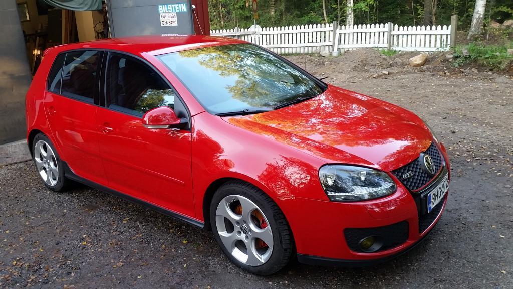

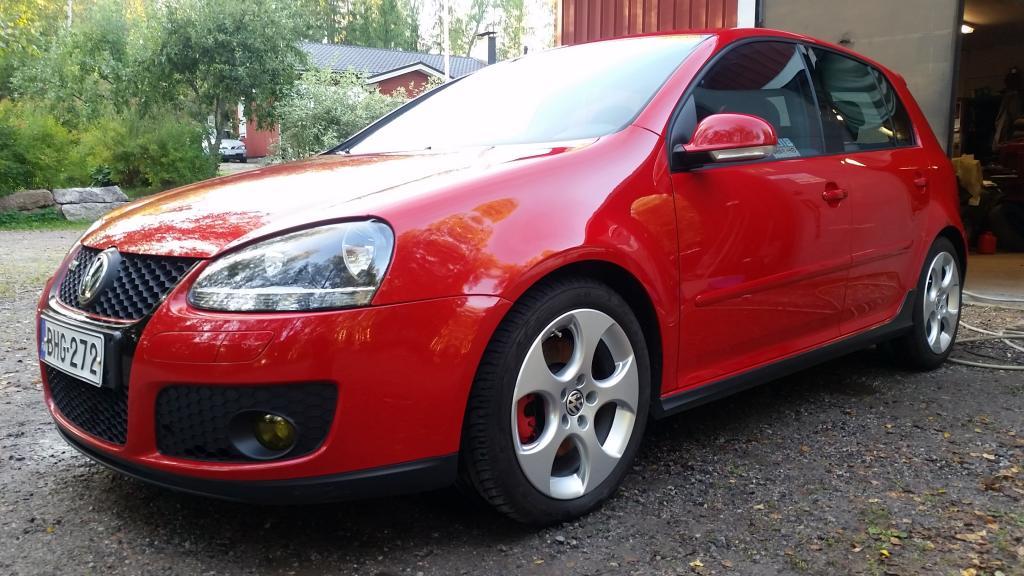

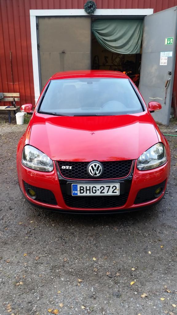

heres some pics that i got the sameday i got the car home.

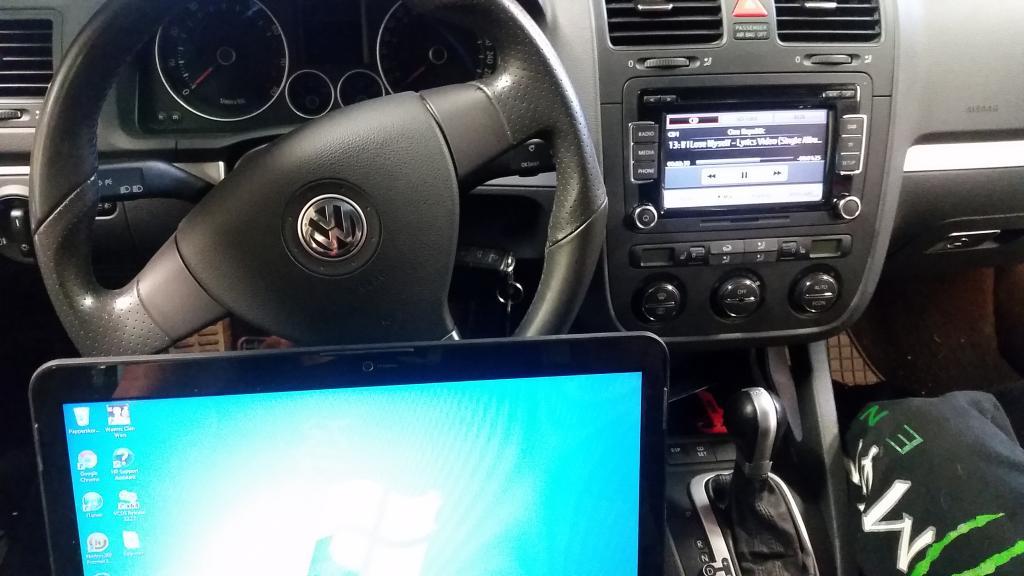

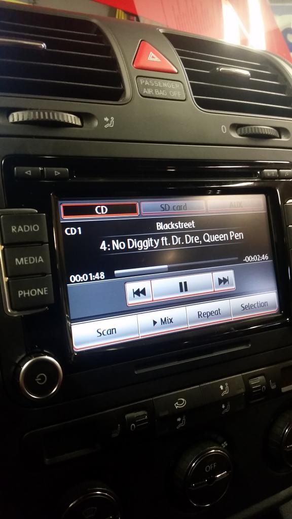

Got my new headunit delivered :)
then the same time i bought a new gateway to prevent the battery drain from the rcd510.
It was 60€ delivered from ebay and all i had to do was copy the old data from my old gateway before installing the new one and when the new one installed i opened VCDS and just started to select everything that i had selected on my old gateway and then a full-scan and removed the fault codes :)
annnnnddd.... it's done :) tidy up the interior.
the same time i played with VCDS i had to try the blinker as running lights and i endeed up with this

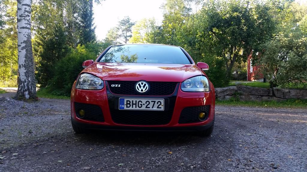

and here some random pics after a good clean and dont mind the rust cover on the brake disks as i used iron-x on the wheels... :indifferent:
