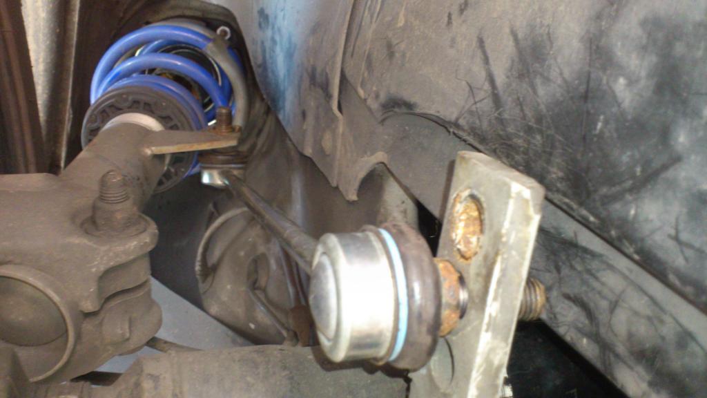

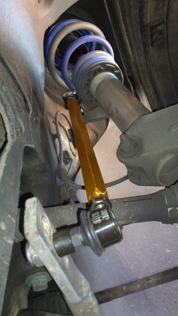

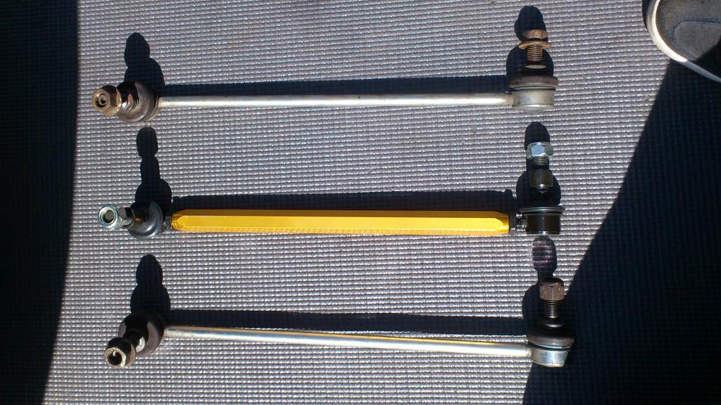

« Reply #5 on: August 31, 2014, 07:41:15 pm »
Please excuse the dirty photos, need to get it cleaned under there!
OEM vs Whitleline Adjustable !
Passenger side !
So this one fits ok, as you can see the plate attached to the shock, where the droplink attaches too, then down to the ARB, with the nut on the inside of the ARB.
Drivers side !
As you can see, the plate attached to this shock is to the front !
With the Oem Droplink set in to show, the only way this would fit, and also to have the nut on the inside of the ARB
Also set the ARB to Med , just to try it out... It has tightened the front end up, will know more over the next few weeks of driving...
Please Correct me if this is wrong or something does not look right !
I maybe did not explain it to well at the start.... :stupid:

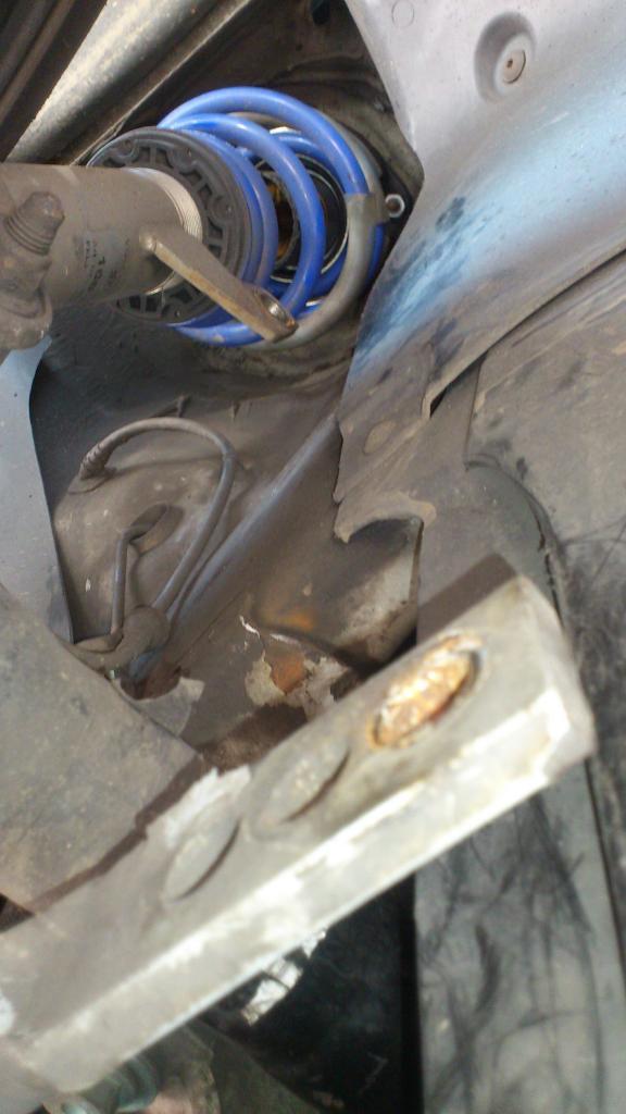

« Reply #11 on: October 07, 2014, 09:27:50 am »
Driver side looks like this:
My knowledge on this sort of thing is non-existent so I literally have no idea  :ashamed:
