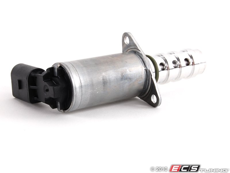

Hey ppl long shot in the dark by me describing would any1 know what the part is called when your looking at your engine bay top right hand corner of the head there's like a module with a plug in clip on it mines leaking oil I think and the clip is more or less broken cheers

Do you mean this? If yes it's called a camshaft adjuster control valve (N205), part number 06F109257C

« Reply #3 on: September 01, 2014, 03:39:16 pm »
Yes that's it thanks will that cause damage etc to my car because some how there is oil leaking from the connection by the looks of things I could be wrong but I took it to the garage and that's what he said

« Reply #4 on: September 01, 2014, 09:01:16 pm »
Assuming the part isn't registering a fault code on scanning then you should be ok.
If the retaining bolts are correctly torqued, replace asap to stop the oil leakage.

« Reply #5 on: September 01, 2014, 09:51:09 pm »
The oil seems to be around the wires and I think coming out of the top of the actual plastic part :/
Current price for that part number £88.96 full retail inc vat :happy2:
