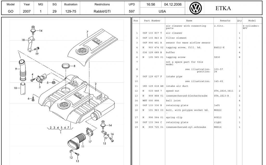

They fit into the standard Engine cover and into the pegs.

036129689B    :smiley:

Do you know the part number of the post they fit onto?
There's 2 on the front of the engine which screw into brackets?

036129689B    :smiley:
Excellent, cheers pal :happy2:
Called a ball joint, part number is WHT 000 898A

#5 and #14

Is this the part numbers for the uk I'm after item 14 . Can't seem to find these in the uk on this part number
WHT 000 898 A, this is the correct part number as Bacillus has listed above

A good tip when refitting, is to put some vaseline around the plugs. This should stop them from tearing as they tend to do after a few yanks.
