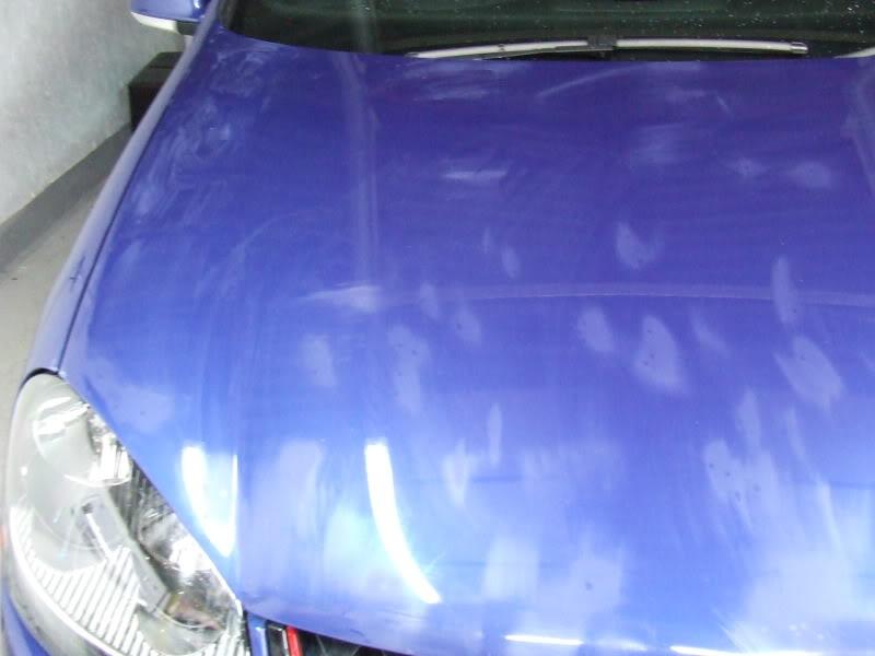

hi mate
yeah is scary but a bit  patience
here's my bonnet
1st paint applied(looks rough I know)
2nd paint rubbed done(a deep breath was taken before LOL!)
http://i75.photobucket.com/albums/i281/stuupnorth/DSCF15722.jpg
3rd bonnet cut and polished
Stu

Great work on that bonnet!
That's a good idea about getting a scrap piece, think I'll do that before I even co side going near my car.

Is the above results with a Chipex kit?
I've seen wet sanding a few times but never had the balls to try it. Now I've got a DA I think I'll try it on a spare panel and see how it goes, as said above.
