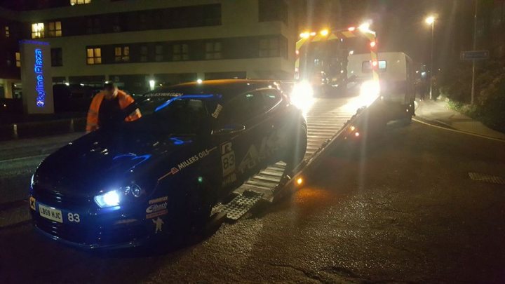

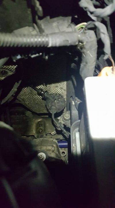

« Reply #461 on: December 28, 2016, 01:37:00 pm »
Was driving to shops. Midway through a tunnel run went to change gear and pedal went to the floor.
I falsely diagnosed it as a duff slave cylinder. As my clutch is a heavy 6 paddle I imagined it was on it's way out anyway.
Infact , and luckily for my bank account, it wasn't anything so dramatic.
A clip which holds ones of the clutch lines in decided to disintegrate. Causing fluid leak and lack of hydraulic pressure.
I could have drove home clutchlessly but not ideal given my journey had lots of traffic lights etc.
