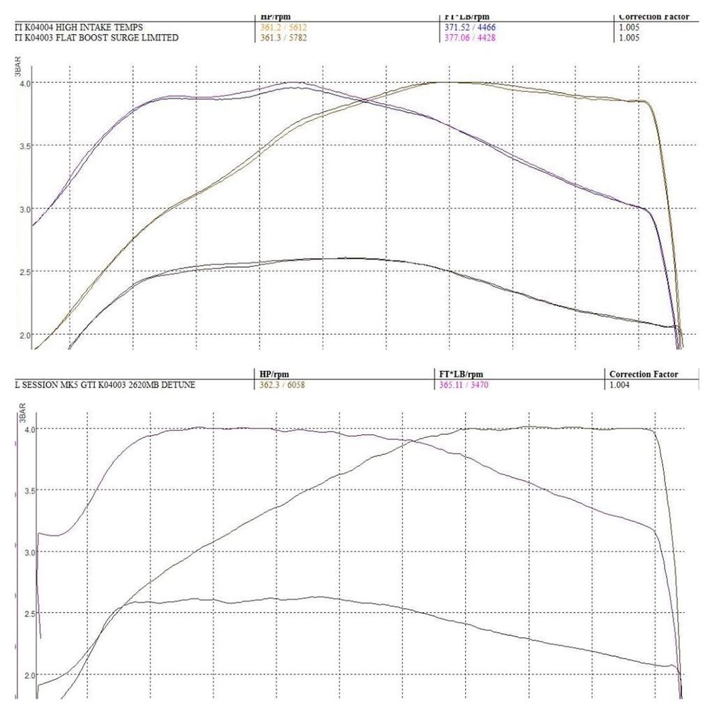

So the car has been collected and I made it home. Been a really long few days so was pretty tired and didn't go too mad with it on the way back.
I'm only able to have the one map so we've done a nice well rounded and safe one for road/track/top speed etc....
This is the result
As you can see peak numbers are good but nothing spectacular as it's more about what's under the graph and helping the engine handle my rather aggressive driving  :signLOL:
Best peak numbers were 372bhp and 395.4lb/, Niki said with meth it's 380+ and 400+ all day.
This is mine compared to a stage2+ without anti surge.
You can see how mine (below) just comes in and holds torque and power whereas the normal K04 has to be mapped around the surge and can't hold it as well through some parts of the rev range.
Car was amazing on the way home. Slip road destroyer.

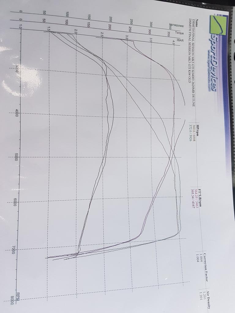

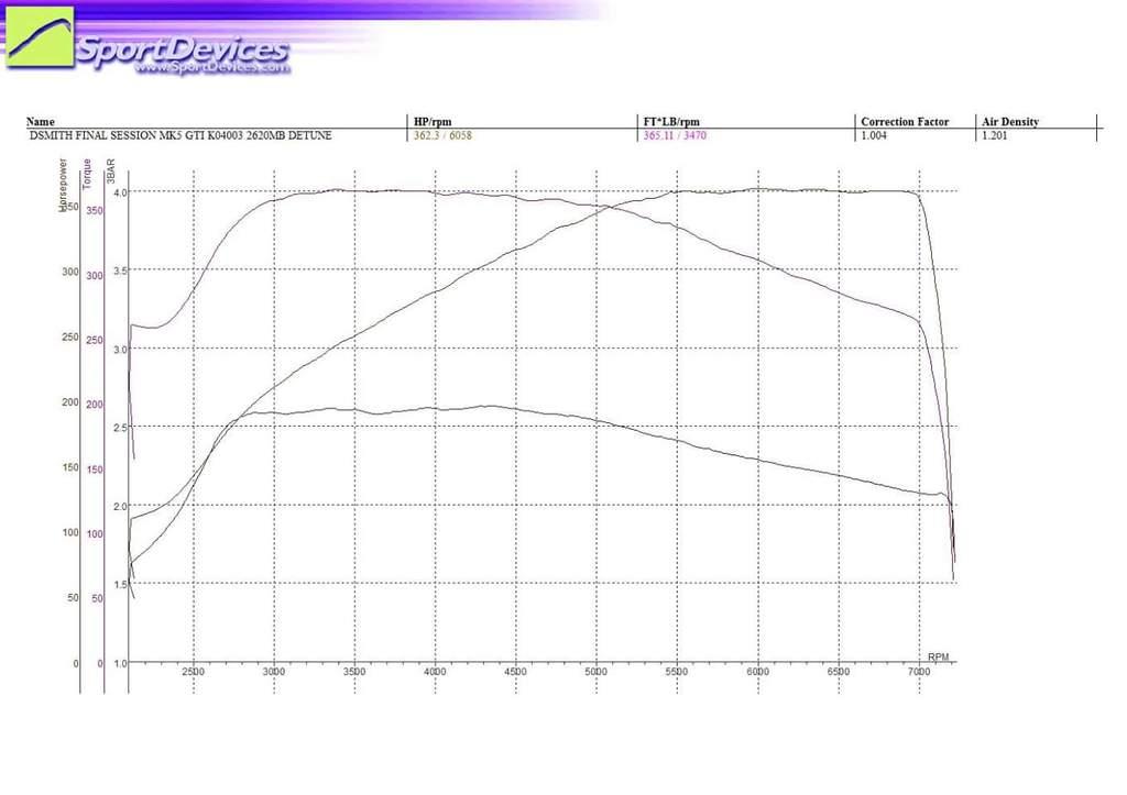

Found the graph that had peak numbers. So many torques the graph couldn't keep up lol
