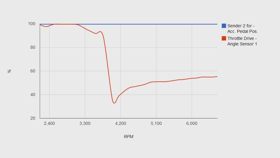

Lack of boost again  :sad1:, slightly different feel to this issue than before the N75 was swapped.  Just done a couple of 3rd gear accels with VCDS and noticed the pedal position is 100% but the throttle position is backing off.
Any pointers as to common causes of the throttle backing out on the TFSi even on 100% demand.

For Clarity this is my main area of concern

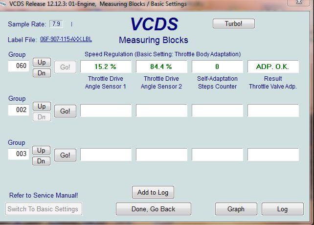

cant you monitor
Sender 2 for -
Acc. Pedal Pos.
Throttle Drive -
Angle Sensor 1
with ignition on but engine off?
http://wiki.ross-tech.com/wiki/index.php/Throttle_Body_Alignment_(TBA)

Thanks Dazza.  Will look it the monitoring of those parameters later.  Adaption process all good according to software

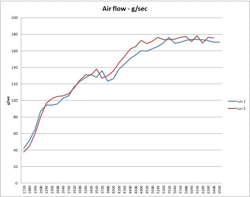

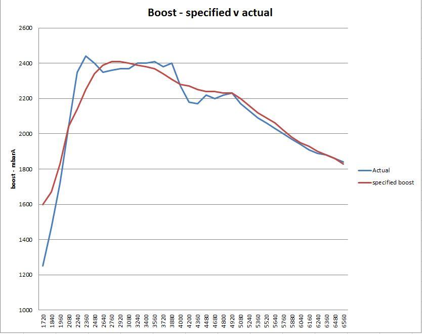

Problem seems to be changing slightly.  More consistant issues over the weekend and it feels similar to what I had previously so the n75 swap may have been a red herring.  Just done a couple of pulls to check the boost and timing.  Boost seems very on off and thats proven by the specified v actual below, airflow into the engine is similar which may be due to the turbo demand being spikey also.
Car idles fine and behaves as normal off boost.
Boost specified v Actual
Mass air flow from 2 runs.
Apologies @dazza for not using your fancy import function for the data.  Can't get it to run properly (probably me bud  :grin:)

It's not you mate it wont show in preview. And not set up for multiple logs in one file. Next time post it any way send me the link so i can take a look.

The intermittant issue here was quite likely to have been I'd been running very close to the torque limit that has been set and only going over it occassionally, with the recent colder weather the issue had become more regular with the cooler intake temps and subsequent increases in torque it kind of made sense.  You should be able to see from the logs @dazza kindly put up that the throttle closing starts at around peak torque area.
