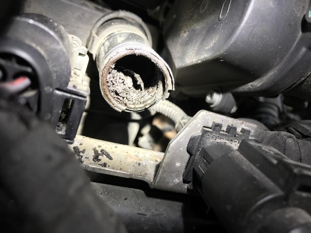

Unless your hands are that of a child I recommend getting a needle nose pliers in there and just cutting the connection on the old pipe.
While I was there I cleaned the carbon from the connection. You can see just how much built up here:

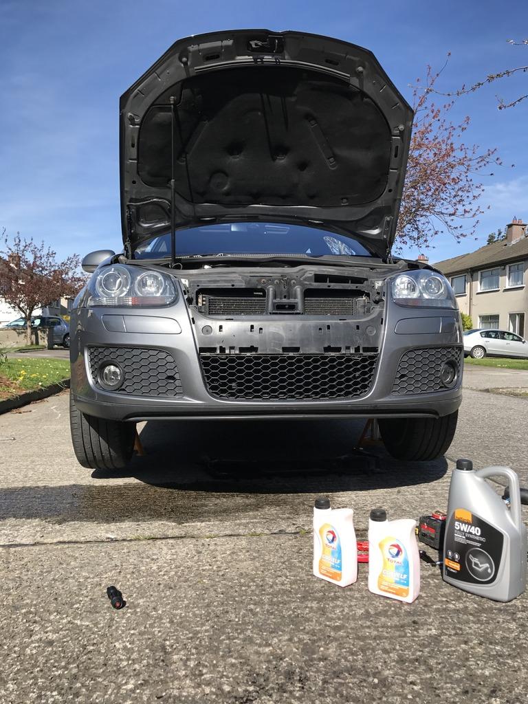

I jacked up the car, removed the plastic underbody protection and that gives you enough space to pop the old one out.
Then with a very strong hand I took off the thermostat and in the process ingested about 2L of coolant. I imagine the addition of coolant in my system will give me better performance.

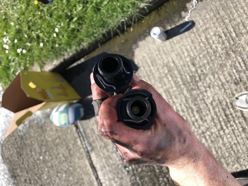

Old vs new. Same part numbers.
I topped up my coolant but didn't drive it.
Wait 10 mins and turn it off and then top it up.
Then I started car and did a few metres and then topped up.
Finally I left it overnight before topping up.
When I got to work that morning it also needed another 100ml.
It seems strange that the coolant took so many attempts to fill the entire system.

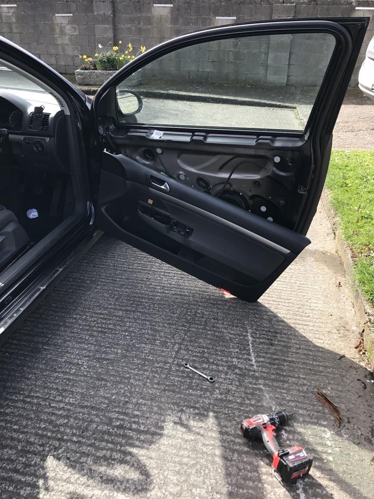

Door Lock Switch
VW quoted me  €40 + vat for this but thanks to @fab5freddy I picked one up that he had lying around for €15.
Not much to this one:
Pop off handles and disconnect
Remove 2 x T30 torx behind handle
Remove 3 x T20 torx on bottom of door
Remove 1 x T20 torx on top left corner of door
Pop off door skin from bottom up. Do it in warm weather or clips might break
Remove 2 x T20 torx from inside door handle
Pop off door handle
Replace switch
Didn't think to take a photo while my door skin was off but since I was changing my gf's wing mirror I just by chance happened to have her door skin off so here's a photo of that
