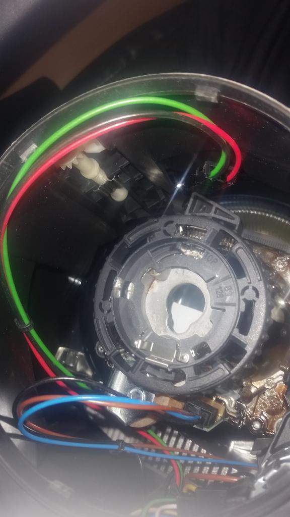

ye i noticed now  :happy2: so they are the same for right and left side?
this is a pic from the d2s inside, missing anything exept the bulb?

« Reply #6 on: November 10, 2014, 07:50:38 pm »
Yes the same left or right. You have the retaining ring so yes just missing the bulbs and igniters  :happy2:
