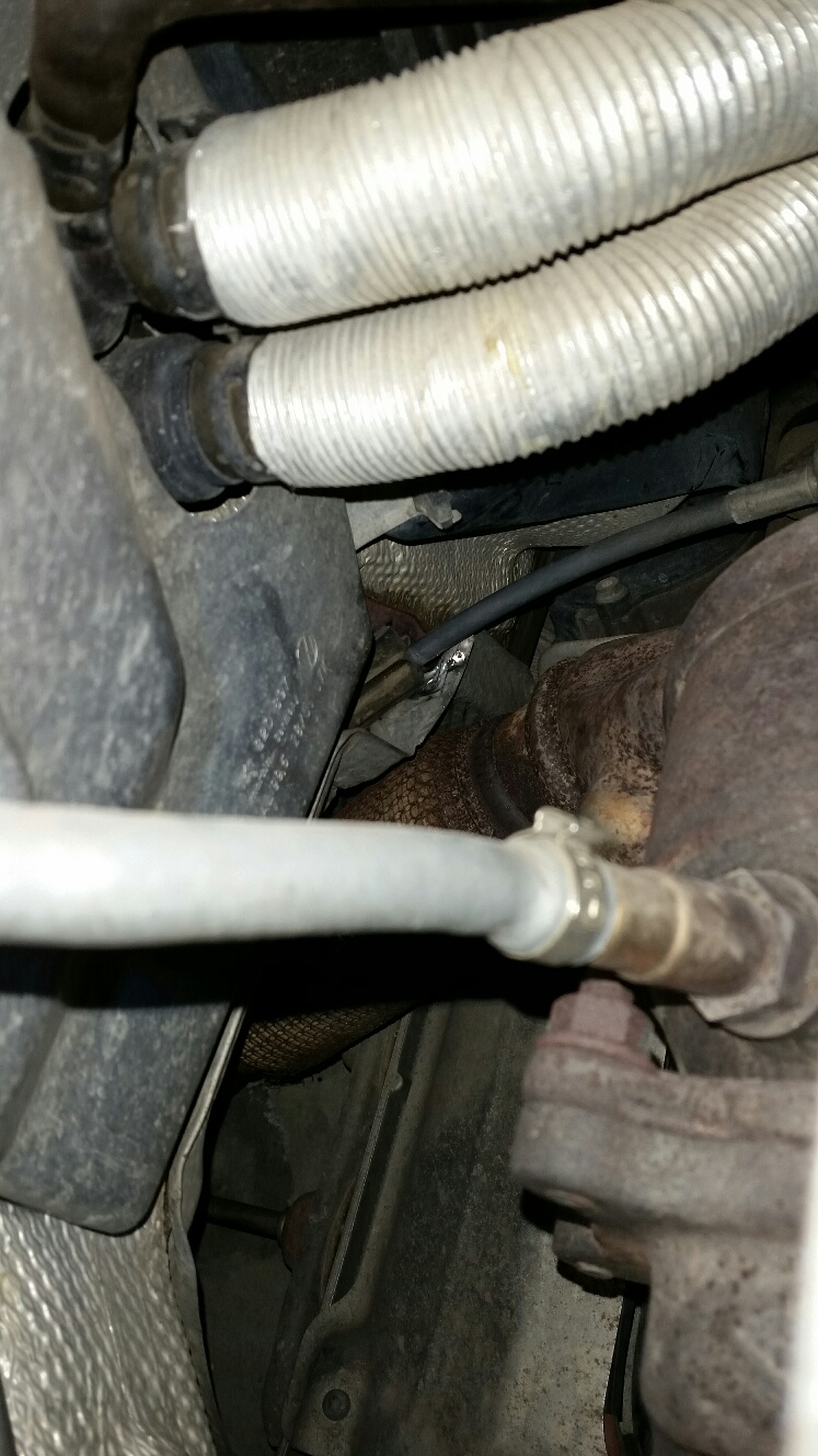

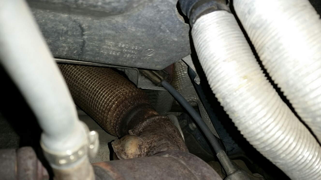

« Reply #290 on: March 07, 2016, 12:15:53 pm »
Not done much lately. Annoyed with the vibration i have at idle when in gear. Don't know what to try next the dash is vibrating and i can feel it in the steering wheel.
Noticed the DSG selector cable was touching the heat shield pushed it down slightly with my finger. Think it has stopped the clunk i was getting when selecting reverse.

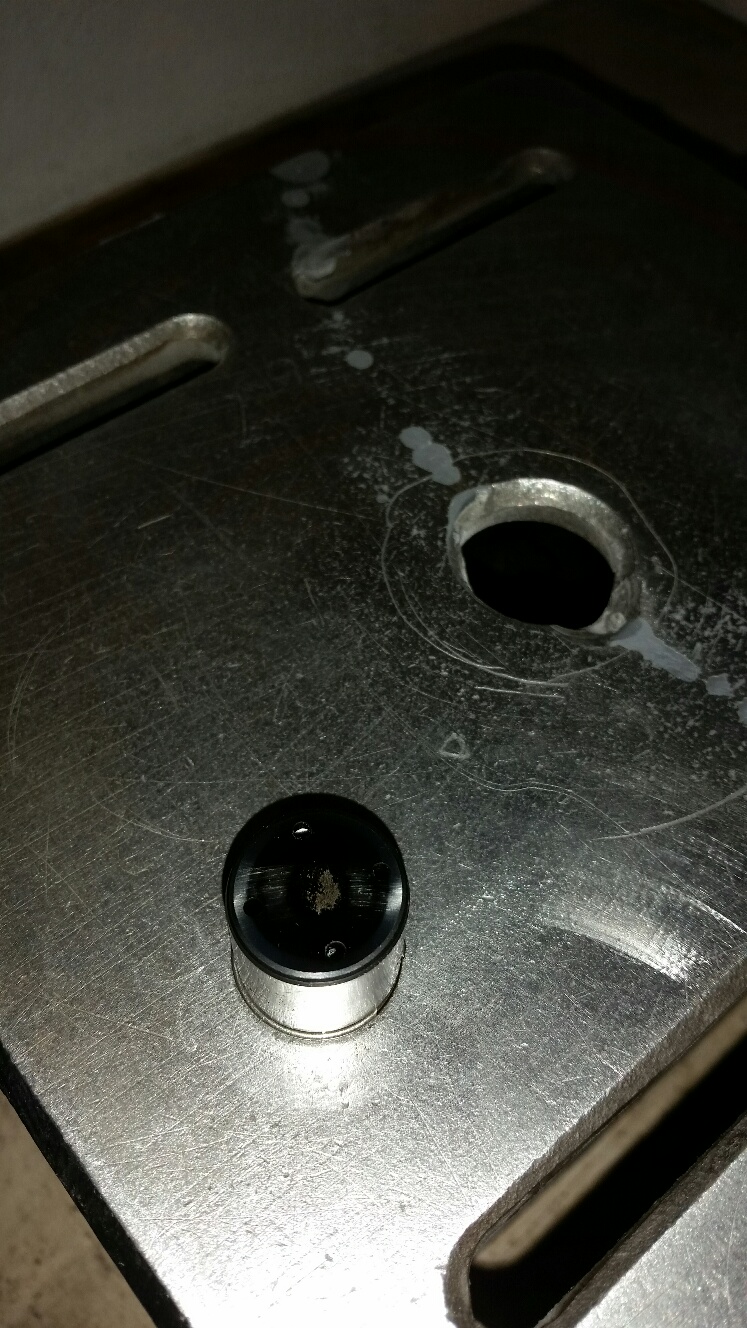

« Reply #296 on: June 08, 2016, 02:00:45 pm »
Finally did some work on the car today.
Oil, oil filter, air, pollen filter and checked the cam follower.
Dropped one of the rubber bungs from the engine cover on refitting spent one hour looking for it... where could it be  :thinking:
the cam follower is a little better than last year so i put it back in for now.

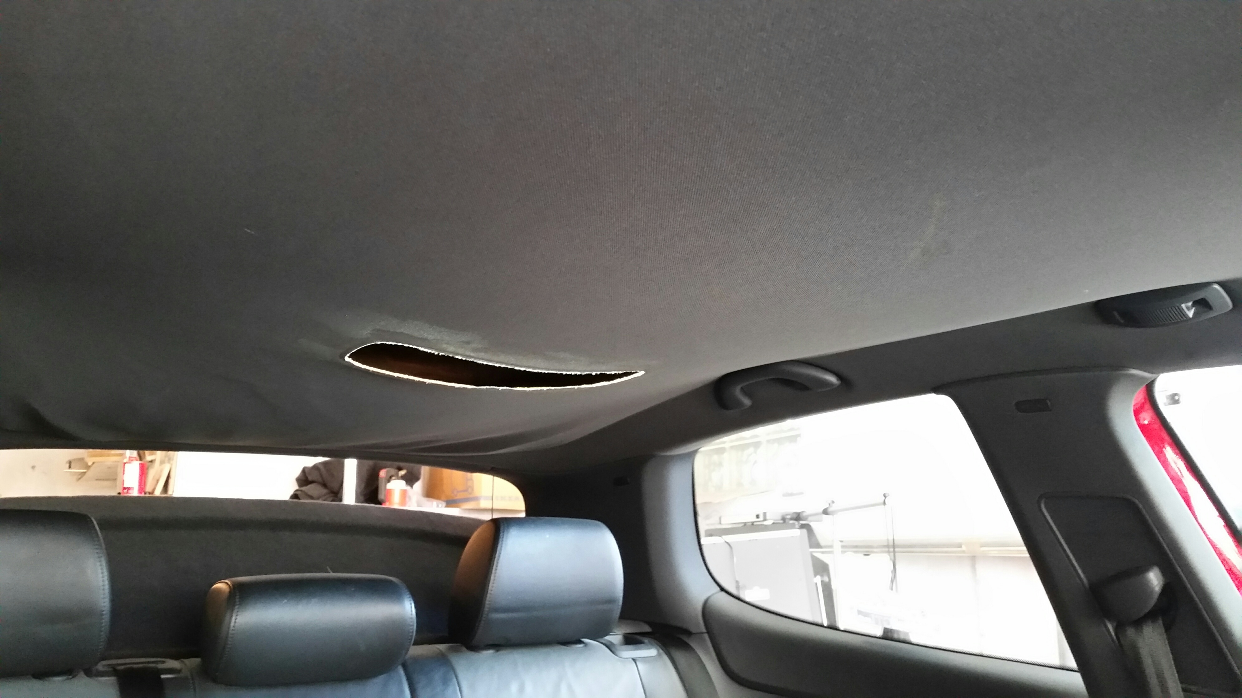

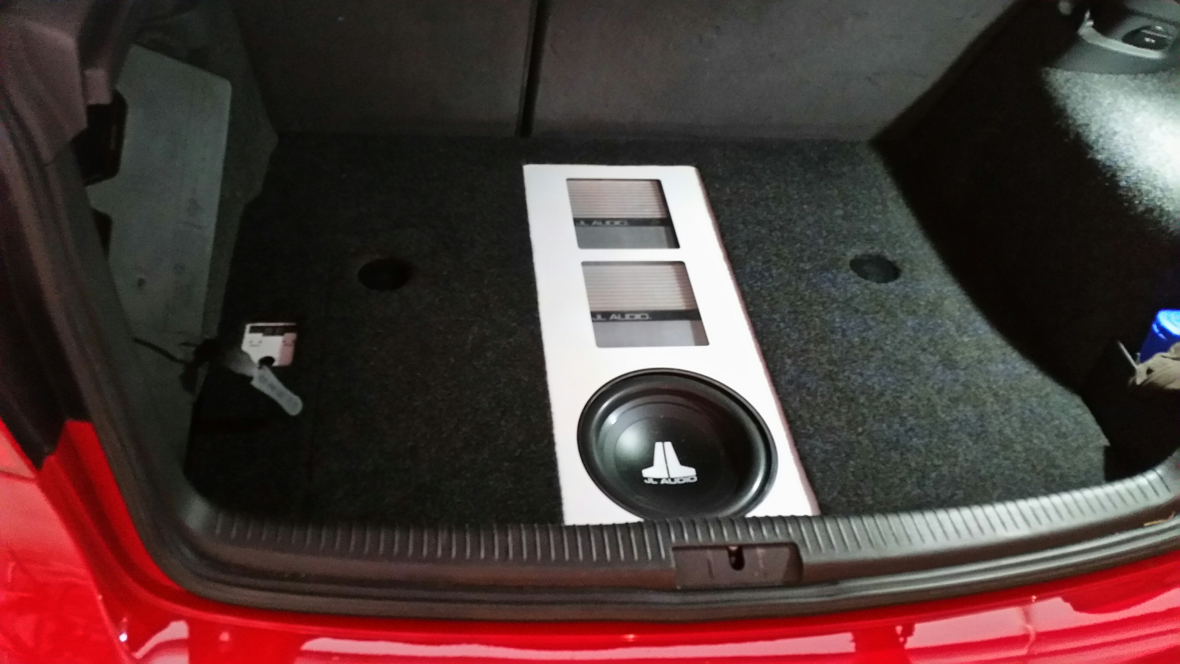

« Reply #297 on: August 20, 2017, 03:30:11 pm »
Two years on slapped some carpet in the boot as i may have to put her up for sale.
Headliner has completely failed the kids got a face full of foam  :signLOL: when we took the car out for her first run in three months.

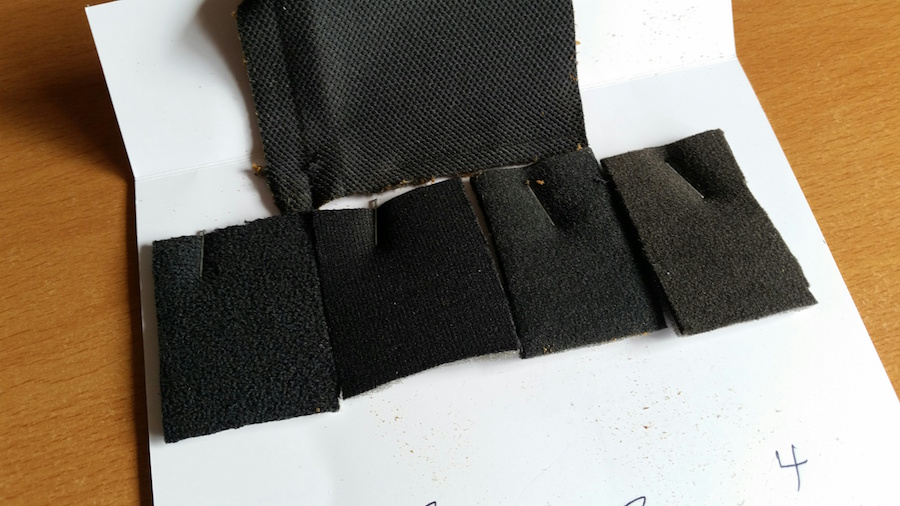

« Reply #298 on: September 03, 2017, 05:41:25 pm »
received some headliner samples the texture is different but the colour is not too bad.
Think i will go for the third one from the left.
