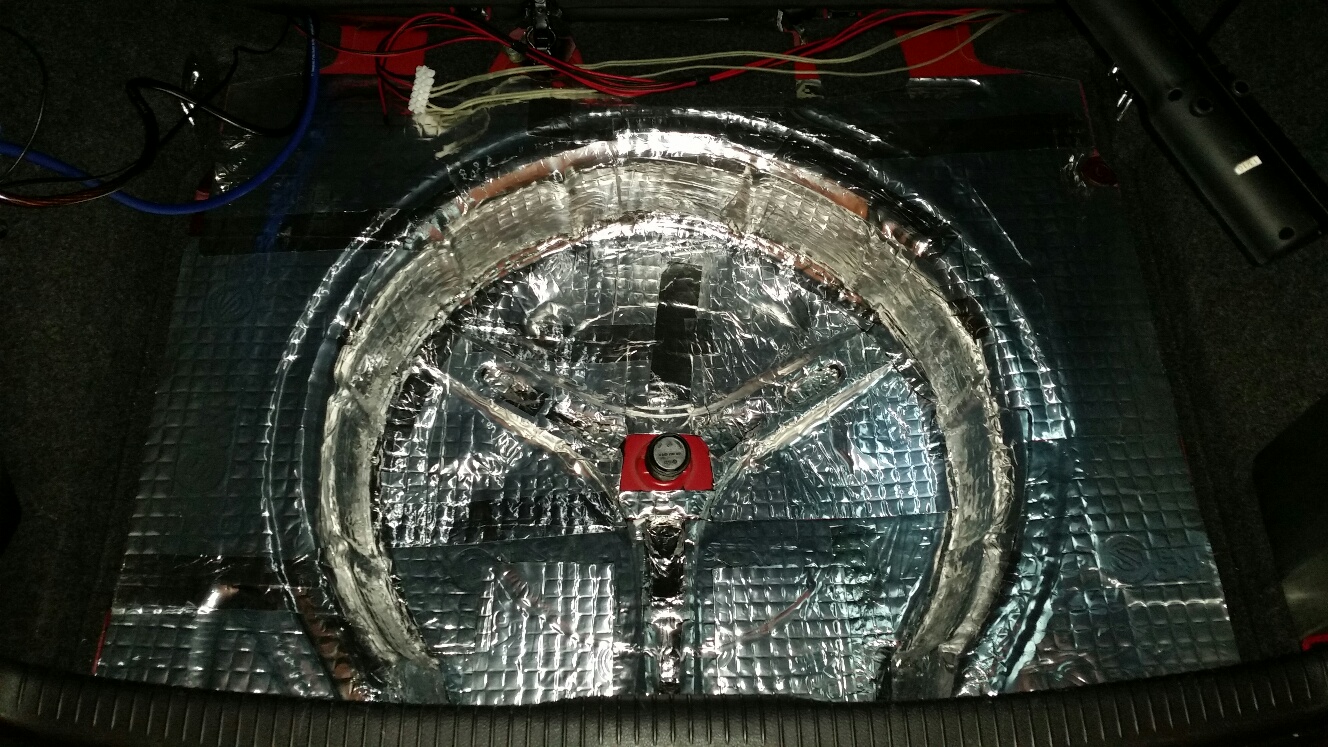

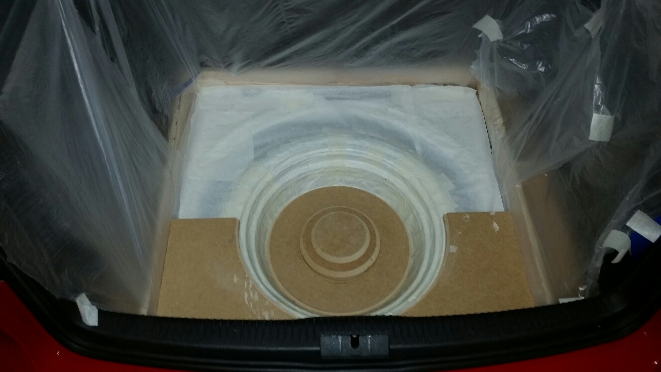

On hold at the moment as i'm waiting on some fibreglass to utilise the space in the spare wheel so i can fit the sub.
Did manage to deaden the boot though.

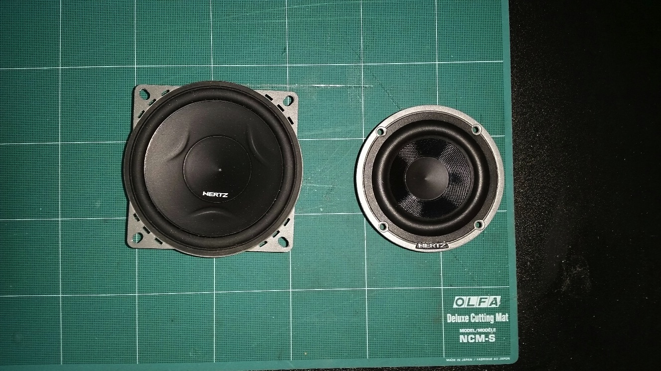

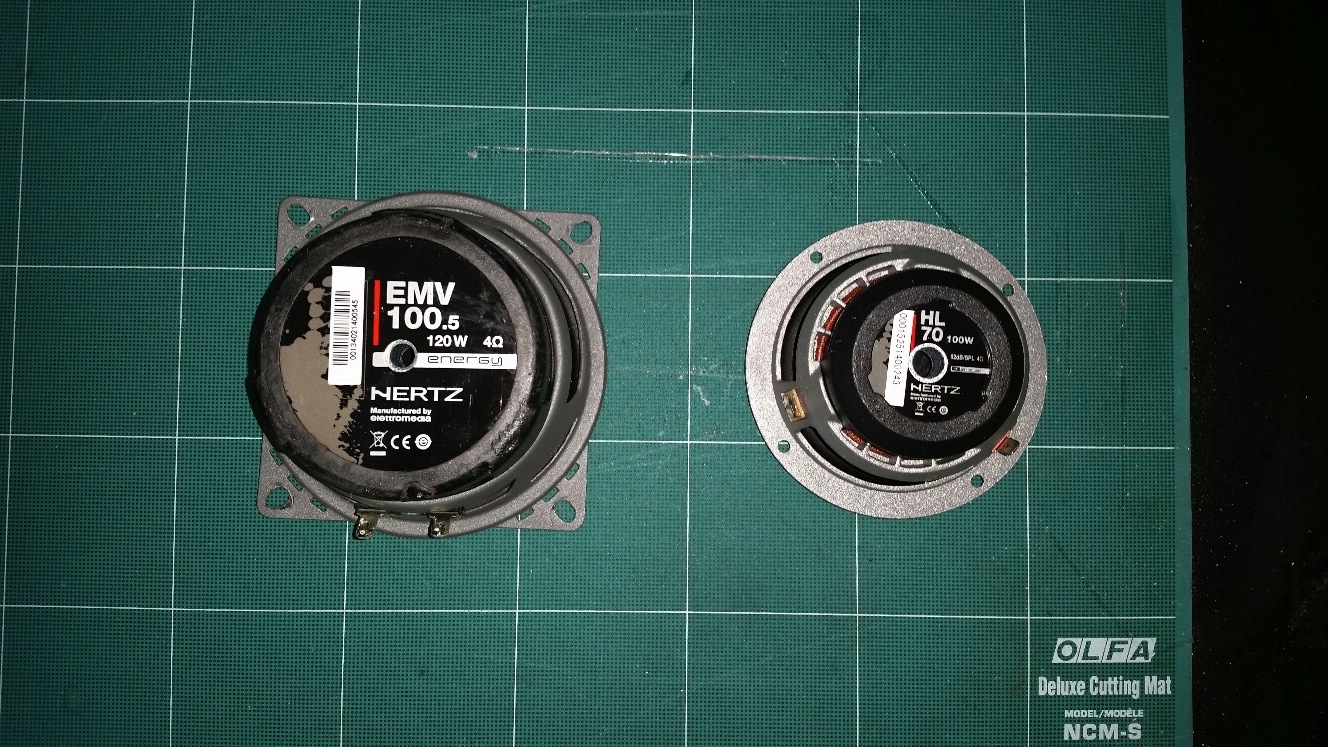

Started switching out the speakers in the drivers door. Luckily i did not have to take the outer skin off to get the cap behind the mid back on.
Things would have been much easier if i didn't solder the speaker wires.
As the mid is much smaller i will have to make more adaptors.  :sad1:

Ah you got them. They will fit much better and should sound even better for you.
Yes mate did not realise they will be that small. I wonder if they have as much mid bass as the ones i took out.
Did you make adaptors to fit them?
05 | Tornado Red | DSG
Offline jedi-knight83
  • -Receive: 41
  • Posts: 1355
Re: Dazza's Maintenance Thread
« Reply #100 on: February 05, 2015, 08:55:11 am »
Just mdf adapters.
They def aren't bassy but then I doubt this mids you had were either. The bass will all be coming from the 165 woofer and these little ones are for vocals.

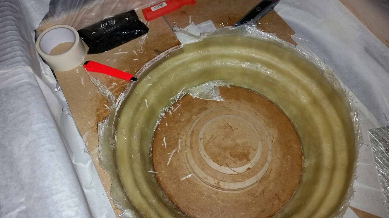

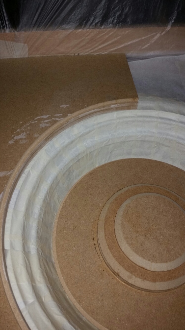

Got two layers of fibreglass down. Wasted a lot of resin did not expect it to cure so quickly.

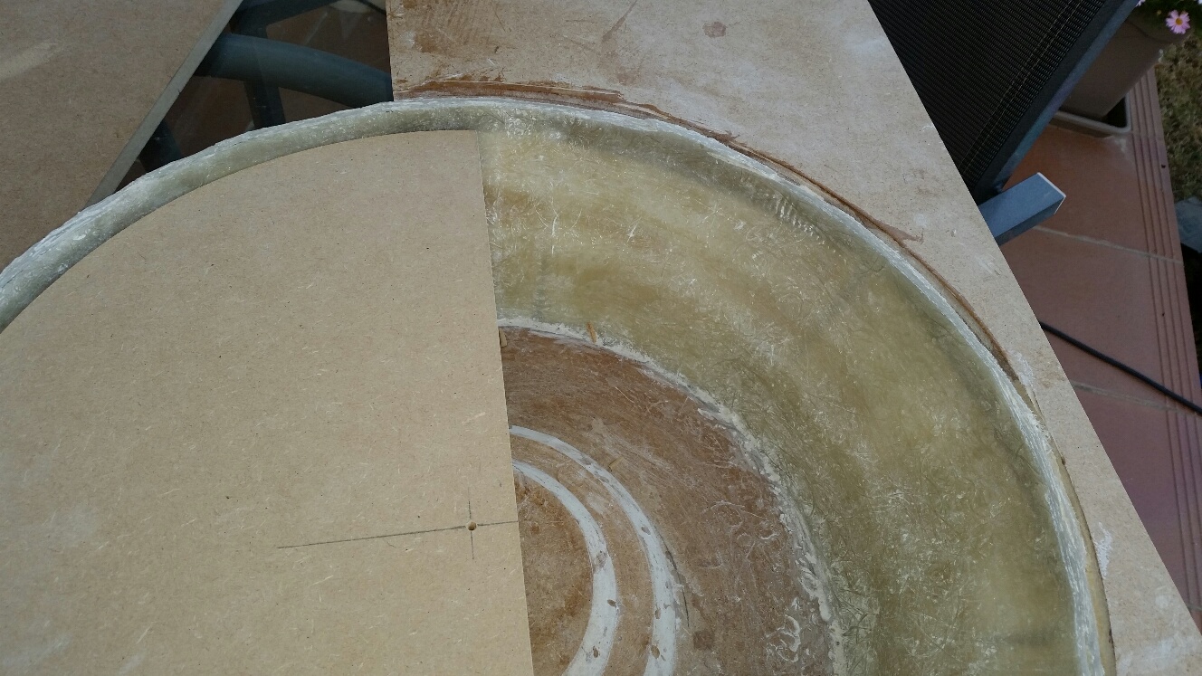

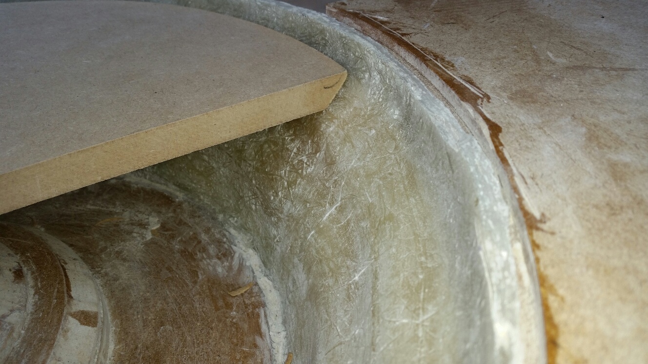

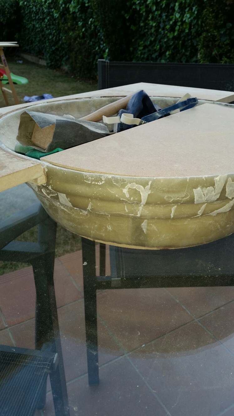

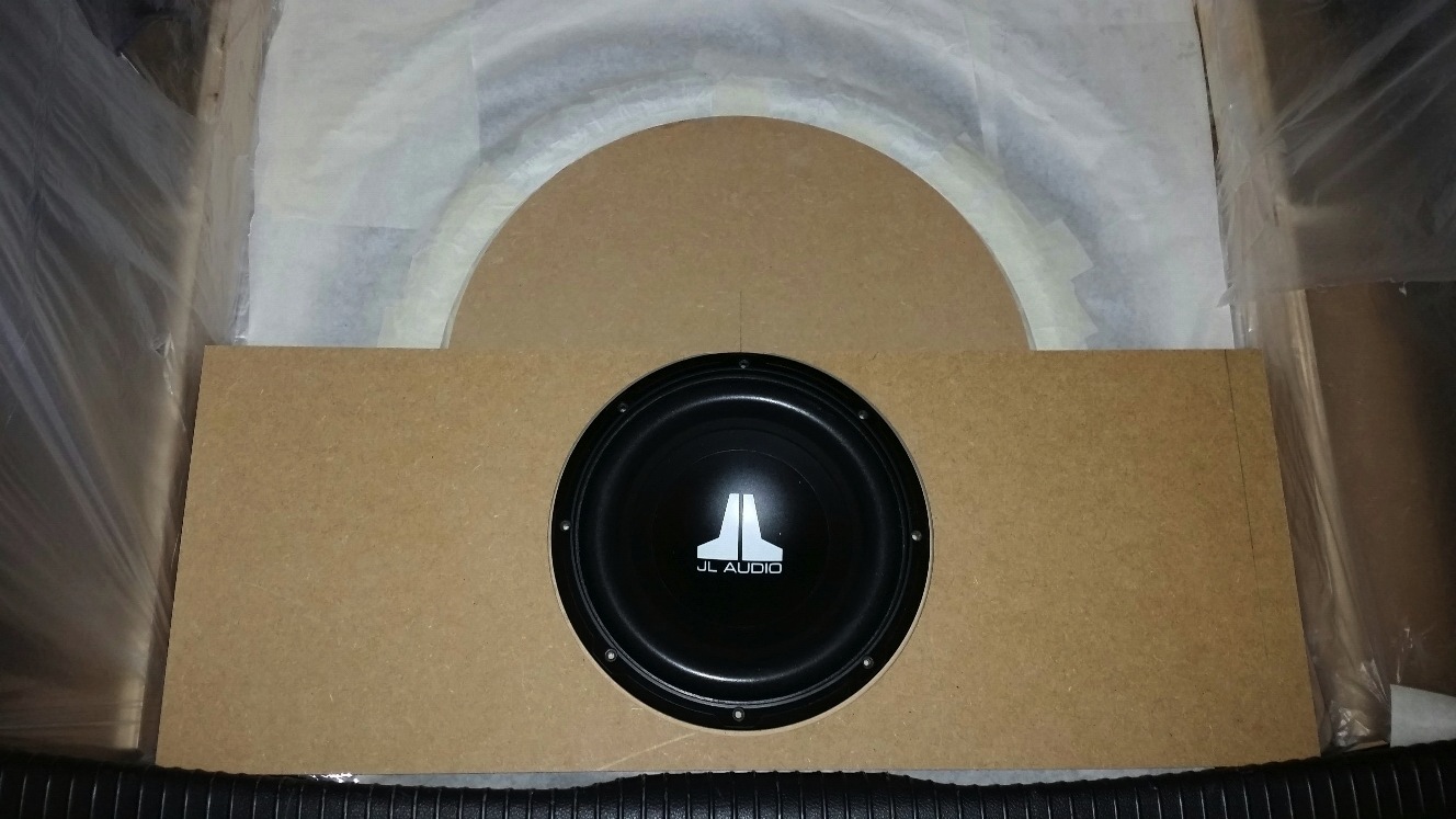

Very slow progress on the sub box.
Do not touch fibreglass if you have OCD. Come to think of just don't do anything if you have OCD.
Started to trim the glass down. Wish i had taped up the base as it's a fooking mess.
Must resist starting over.  :stupid:
Started to cut the lid for the back section of the box.
Manage to get some polyurethane glue to stick that sh*t down.
