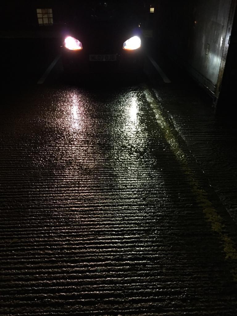

Hi all, one of my xenons has gone pink! Is this a sign it is on its way out? Just got the car back from having the gearbox done and they have had the battery disconnected could this have caused the xenon to do this? Also will this deffinately my be the bulb and not the ballast? It doesn't seem to flicker at all just a colour and brightness change.
Any information on this would be much let appreciated!
Problem solved now, here is a pic for anyone else who may come across this problem and want to confirm the solution (I had doubts as to whether it was the bulb or ballast after speaking to friends)
Thanks
Sam

Yes, if you do a search it comes up. It will no doubt fail soon.
Buy a pair of new D2S bulbs.

Excellent thank you guys, so it's deffinately the bulb? I did a few searches but didn't manage to find anything solid, sorry!
