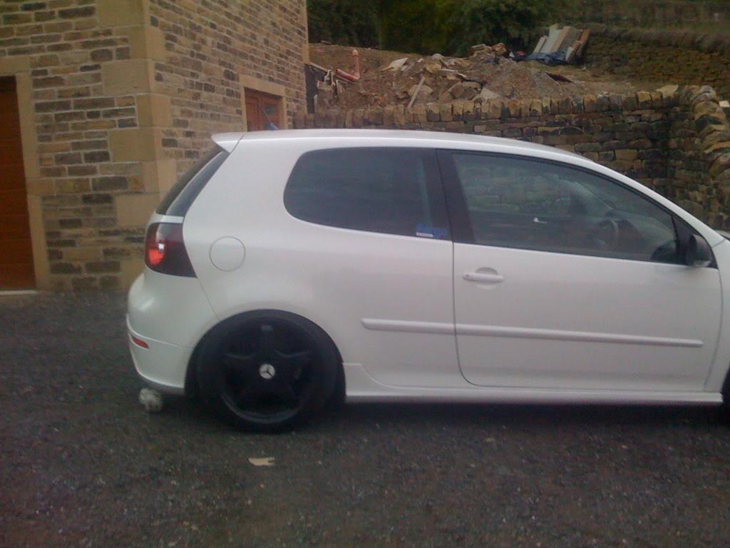

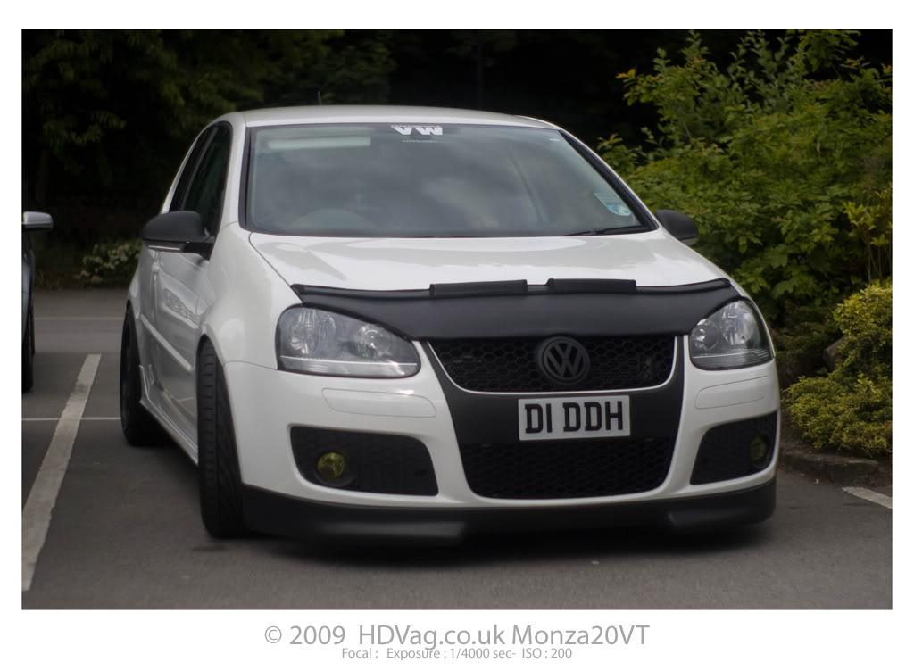

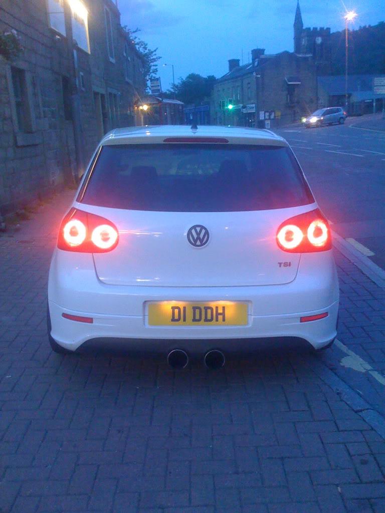

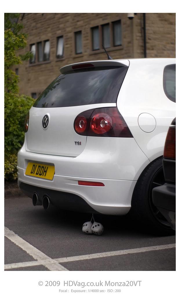

POORMANS UPDATE:
skint at them moment  :sad: so i have done a few poorman's mods...
swapped 215/40/18 from back to front to stop scrubbing..
lowered coilovers as far as they will go on the front..
removed supercharger cover and insulation which has given me quite a lot more whine upto 3000rpm  :innocent:..
and done a little modification to the rear lights as you can see in one of the pics below  :wink: i think it totally transforms the look of the car at night and only cost me £10 for materials !!!....
some recent pics..........
spot the difference?

Looks good  :happy2: , just wondering though , how did you wire the inners up , i have a spare set ready for that mod to be done for about 2 months now  :signLOL:
Offline DubwayDan
  • Posts: 286
Re: DubwayDan's TSI Updated 17/06/09 lights,lowered and stretched
« Reply #101 on: June 17, 2009, 10:54:46 am »
its quite a time consuming job but thats just getting all the interior panels off to route the wires.
firstly drilled and sealed the inners with the new bulbs in.
then ran 2 wires each side to the 12v socket in the boot.
i then just found a plug for the 12v socket and wired the lights upto that,
it means they are always on when ignition is on but they go off once the car is turned off  :happy2:
i didnt have to use any resistors or anything like that btw its very simple.

looking fantastic mate.
well done. try and get a few more pics of those lights in some different lights. in sun and at night etc! ;)

Looks  8)
Been considering doing that inner light mod on mine wondered how hard it would really be.
Did you not think of doing the inner light mod like this though
http://www.golfmk5.com/forums/showthread.php?t=73923
