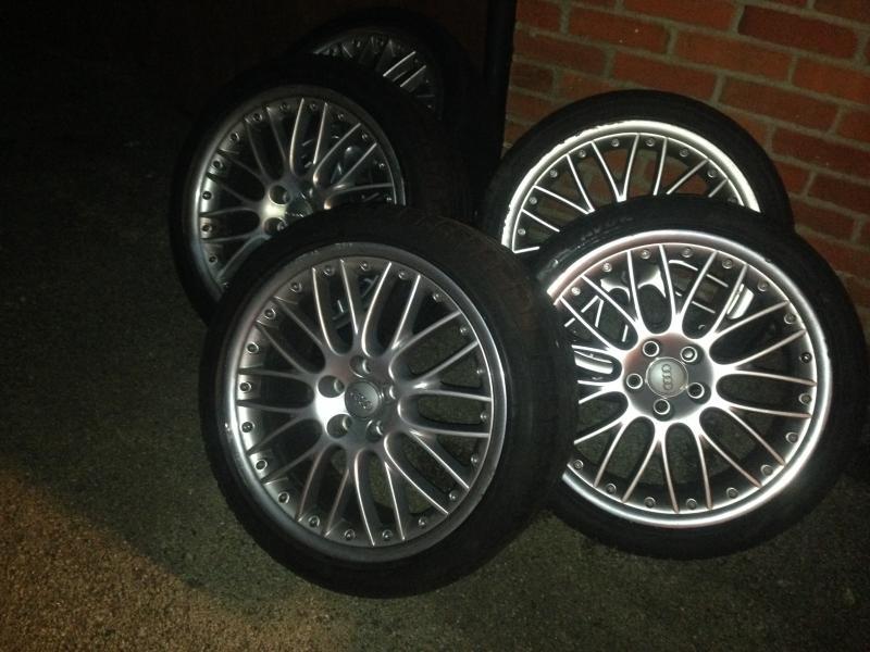

Im not very good at leaving stuff alone, but i new from the start i couldn't just do what i like to this car, it needs to stay a usable car. so no stupid wheels and really low... so the wheels from the van went out the window
so i bought these instead

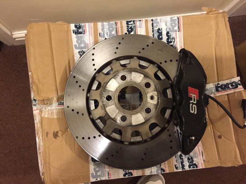

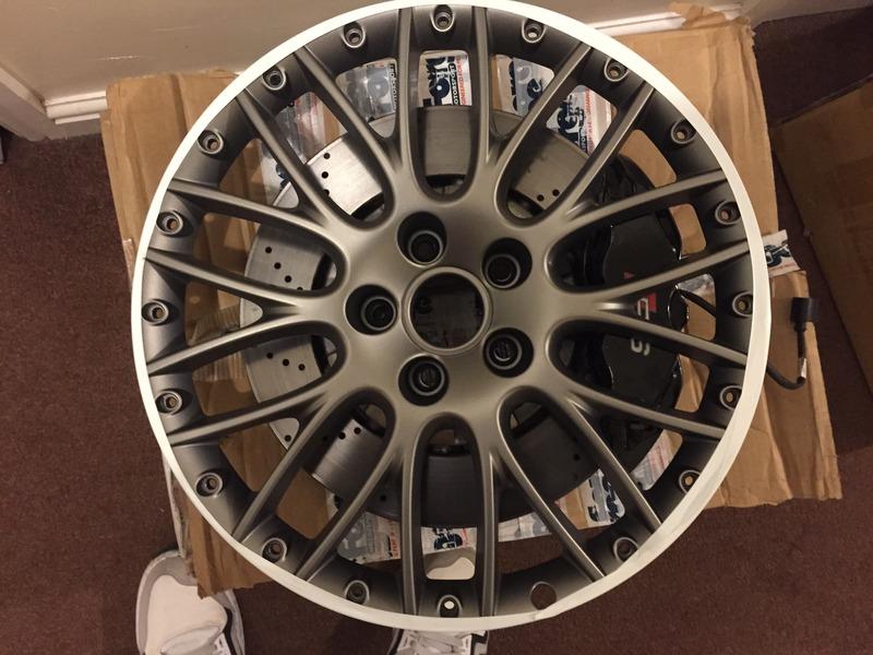

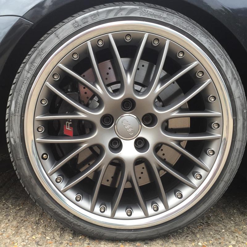

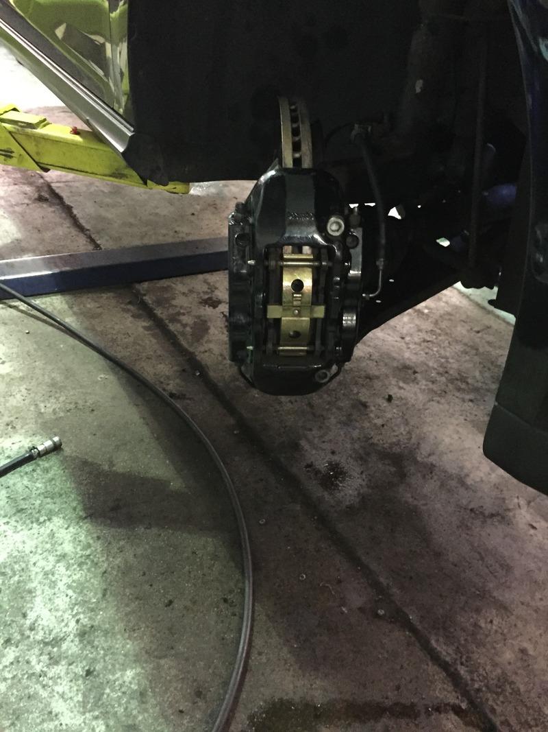

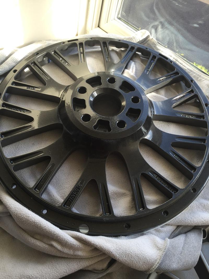

Picked up some rs3 hubs, discs and calipers last night! they are huge!! also had my speed lines apart and refurbed matt grey!
Roll on the weekend  :grin:

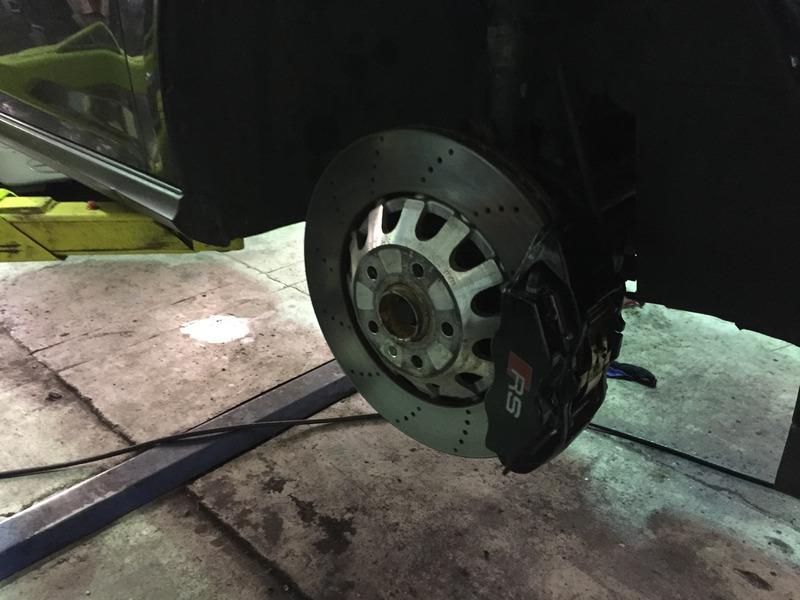

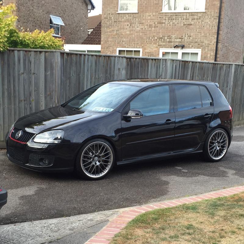

Got my brakes, hubs and wheels fitted just in time for players last weekend! Still not 100% on the wheels still, and the rs3 hubs have pushed the track out by 10 mm so need my front archs rolled and made wider! Need coilovers now as im not happy with how it sits! Heres some pics  :jumping:

« Reply #14 on: July 26, 2015, 03:01:43 pm »
I'm not that familiar with the RS3 hub lower control arm setup other than the mentioned 10mm wider due to wider ball bearing. I have had the "normal" TT mk 2 setup which is alloy parts and allows for adjustable negative camber at the ball joint. This gives at max. Negative camber 7mm wider track on top of the hubs being 15mm wider so 22mm in total. If the RS3 hubs are of the same dimensions and you ad a further 10mm you will have trouble running your existing rims at the ET of 42-48mm. Rolling the fenders won't be enough. You need to look at Kerscher or SRS-Tec from Germany that makes 30mm wider front fenders in reinforced plastic. I had the Kerscher solution along with my TT mk 2 alloy front hubs and lower controlarms.
