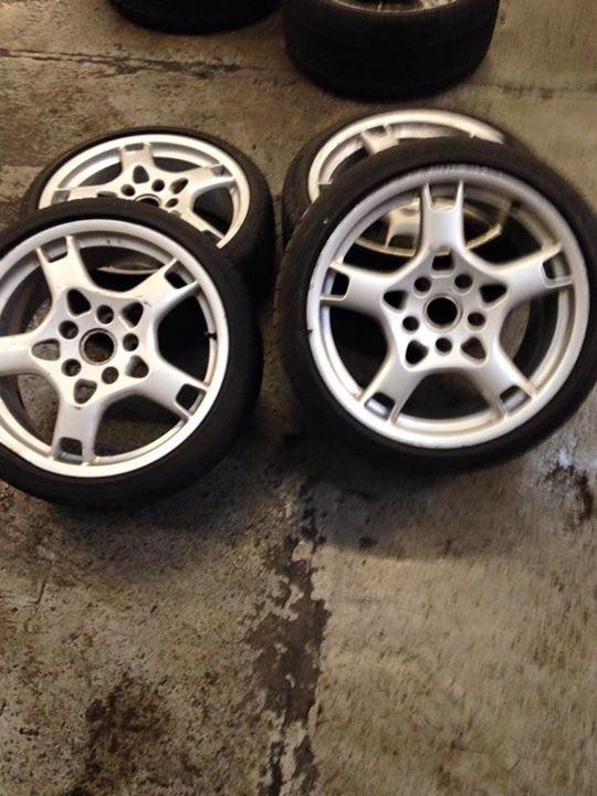

Depends which wheels - do you have any photos?
Offline Markweir12
  • Posts: 175
Re: Porche 911 wheels
« Reply #2 on: December 23, 2014, 04:59:10 pm »
Them ones :)

You aware that Porsche alloys are a 5x120 stud pattern, where as VW Golfs are 5x112, so you'll need adaptors which will push the wheel out even more? It's not impossible but something to factor in as well as the (likely high) offset.

Those adapters won't fit as they would be for bmw fitment.   Porsche are 5*130 fitment,  love a set of those porkas on mine

5x130?! Jesus... I thought they were 5x120, my mistake!
http://www.ebay.co.uk/itm/H-R15mm-PCD-Adaptors-Audi-VW-5x112-to-fit-Porsche-5x130-wheels-1-PAIR-/380901509302?pt=UK_Cars_Parts_Vehicles_Wheels_tyre_Trims_Trims_ET&hash=item58af7fc8b6 - Correct ones, the other link may be handy if you fancy a set of M3 alloys or something.

think you could get away with the front arches not being rolled, but rolling would give you better scope.
rears could be cambered and will sit nice.
The rears are very wide on the Porsche wheels as I was thinking about them but lost interested due to the fitment issues.
Best bet will be to get 4 fronts  :happy2:
